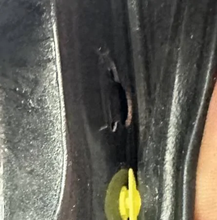

Only the driver side door right?
Mine is currently only the driver side door. The dealership told me that have dozens of this exact problem in the Escapes around 2020/2021. Body shop guy told me he CURRENTLY has 8 of them in his shop waiting for new door to arrive. He told me to call Ford and make a complaint. I'll be doing that later today.

I'd been wondering about my noisy door for six months now. I started to think it was coming from a joint in the check arm itself, which led me to this thread. Sad to say that I can see cracks on the two spot welds on either side of the check. Not as bad as OP's, but pretty obviously the source of the noise.
I'd love to see this letter, too. I plan to reach out to the dealer soon. Buh. Glad to have been pointed in the right direction. Thanks, all.

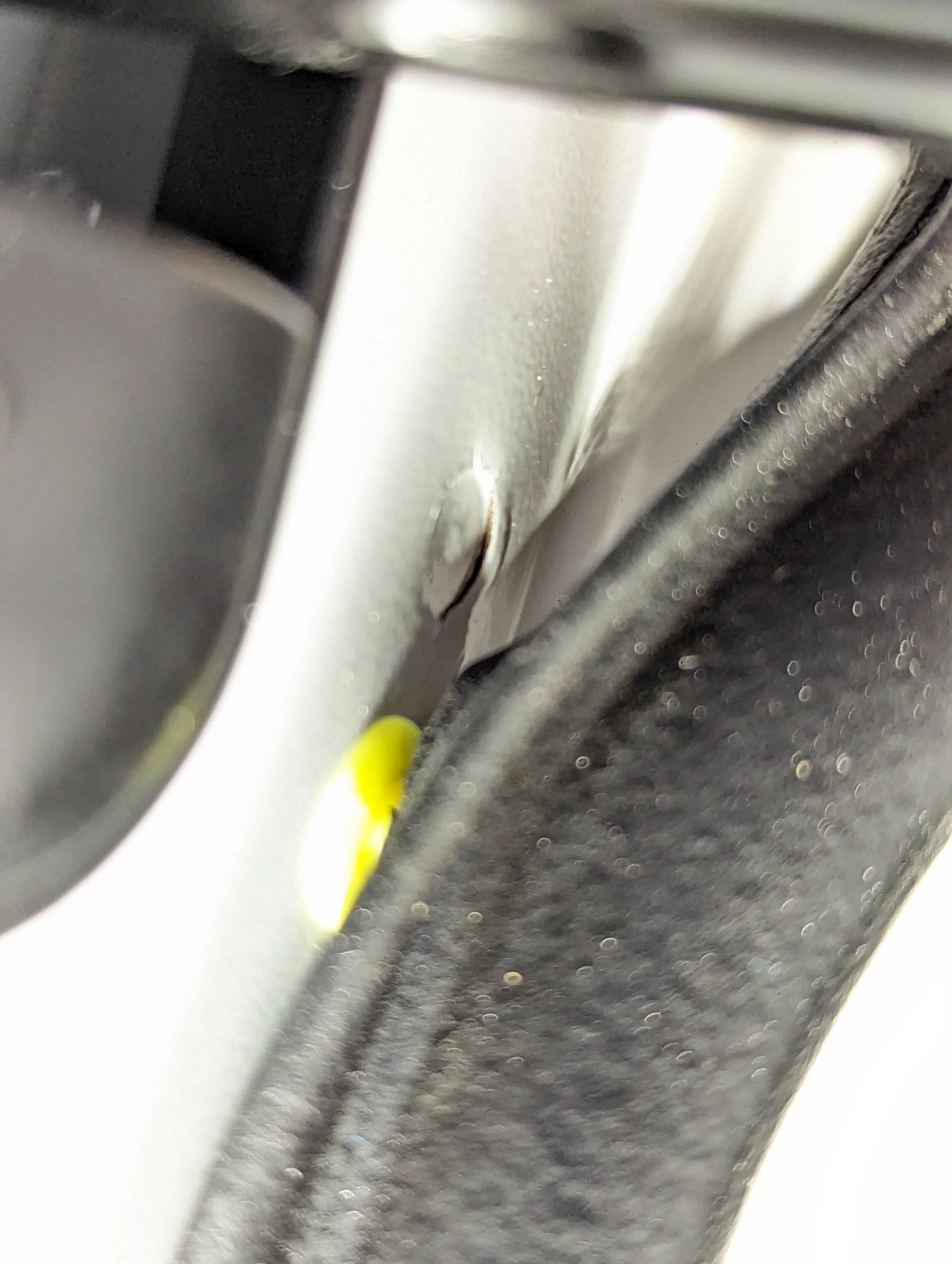

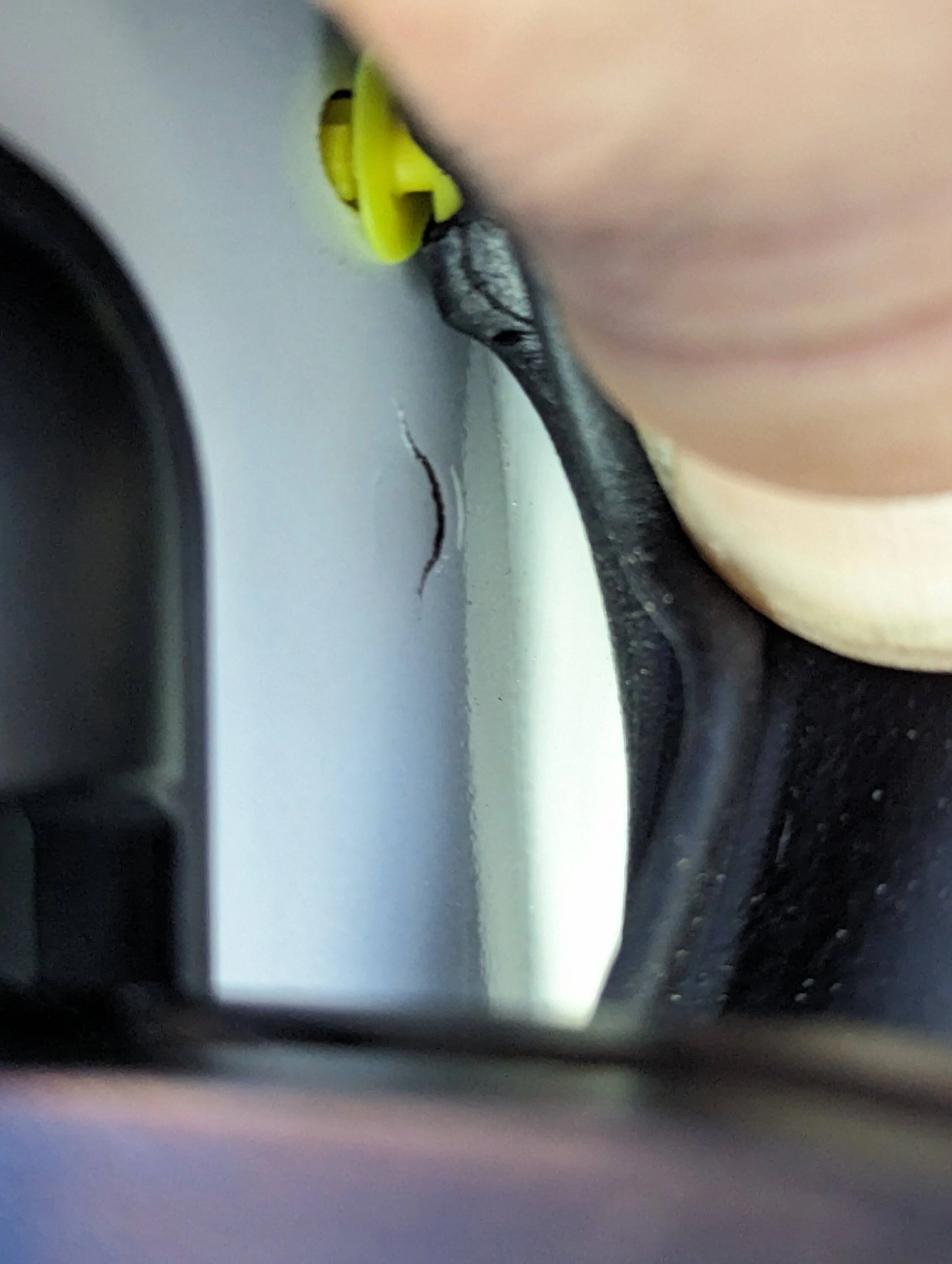

Super! My '21 GT Job 1 driver's door starting clicking a few months and I ignored it until the clicking turned into loud clunking. My 12 year old boy said add some grease to the hinges and door stopper thing. Added a bunch of Superlube. Still clunked... Called my aerospace engineer daughter (1st yr in school) and she said check torques on fasteners, ha. Then, found this thread and discovered the failure! Yep, I have the dreaded 2 failed spot welds (cracks) on door-check assembly area . Maybe metal is too thin there? Is there a SSC yet for Mach-E's? I assume the entire door assembly needs to be replaced... I have the EV Premuim Care Ford ESP but it may fall under body defect and excluded? @Mach-Lee

I just checked my car. I can feel the divot in the metal. I don't think the weld has completely pulled away, but it is definitely working its way there. Is there a solution that doesn't perhaps cost 3500 dollars? Or is ford eventually going to do the same thing for the mach-e that they did for the escape? Or should I be looking to dump the car?

I'm hoping this will be covered under my Ford ESP EV Extra Care since it's quite clearly a manufacturing defect! Ford will likely issue a CSP campaign or Recall at some point soon like the Escape. I've never had faulty door welds on a car! Taking into dealer soon - Ken Grody - for new tires and all the module updates.

Hi there. Mach E 2022. I have another one 2023 with the same 😂🫰

Same problem on my 2022 (out of warranty). Mine is on the passenger side door, but it's the same location, same spot welds under the seal. The door creaks loudly opening and closing. I can see the little cracks, feel the movement with my fingers when I open/close the door, and the sound even goes away if I spray a dab of silicone on the cracks (though I'm sure it'll return).
Has anyone had luck getting this repaired out of warranty?
