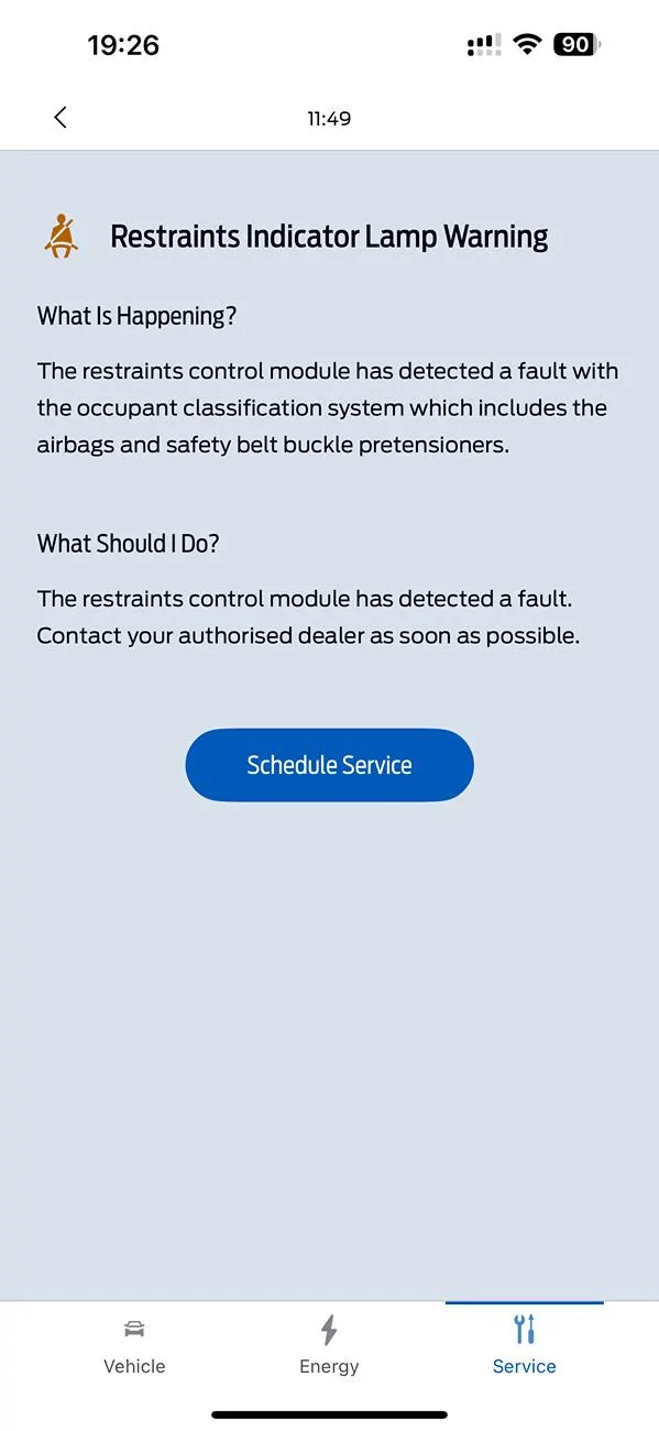

Picked up my Mach e on the weekend but have since had the attached errors intermittently popping up.

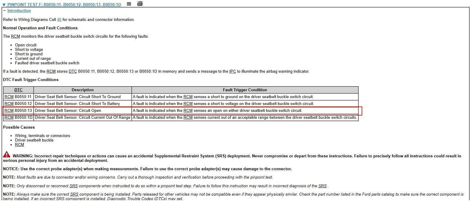

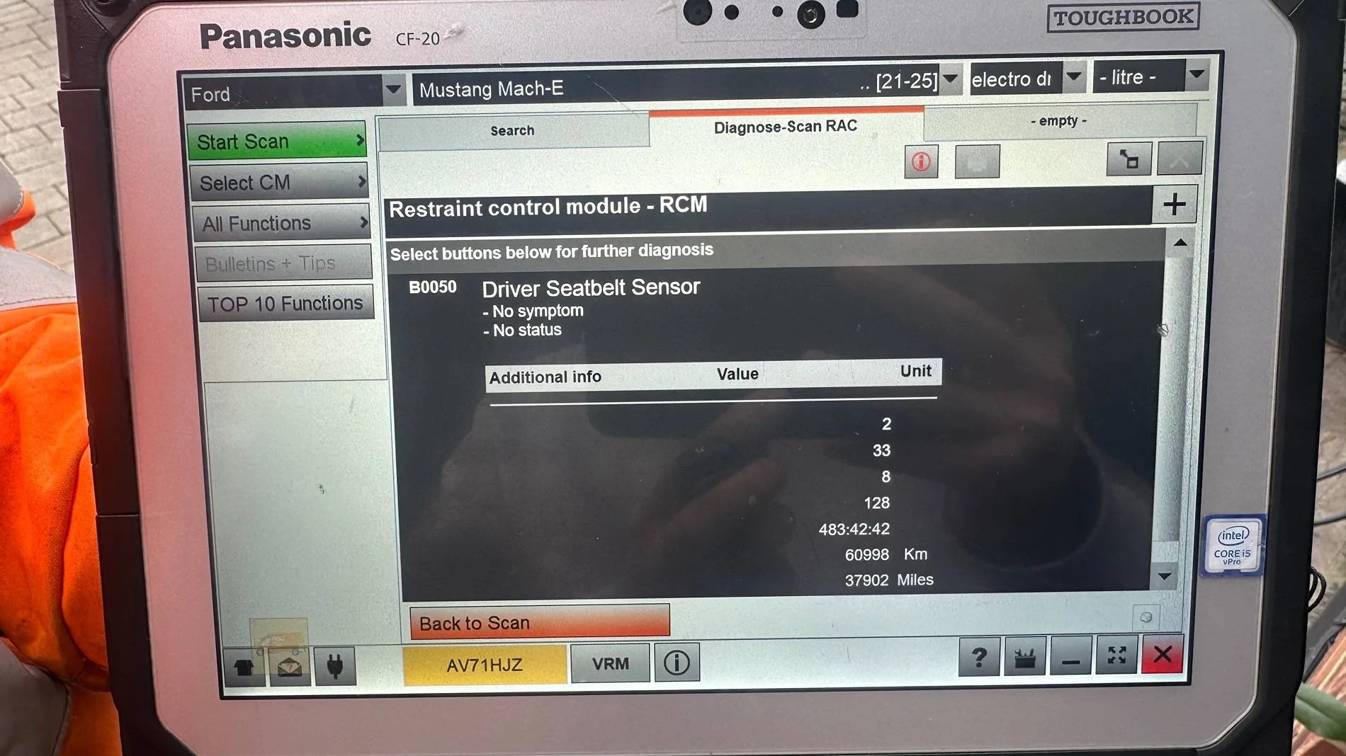

Mike G on here managed to pull the error and I’ve also had RAC come out who’s confirmed the faults.
They are now asking for a itemised repair quote to then hopefully reimburse.
Any recommendations on if Ford are able to provide this as a quote without having to pay the £180 diagnostic fee, as error has already been identified
