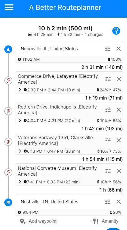

From Naperville to Nashville is 496 miles, 7:47 via GoogleMaps.
ABRP for your car (basically my car) shows 8 hours and 29 minutes of driving, and 1 hr and 32 minutes of charging (4 charges), using a reference consumption of 2.5 miles per kWh and a temperature of 25 degrees.
Looks right on to me.
Thank you - and I expected 9-10 hours total time, so I'll keep monkeying around with ABRP.

Regarding ABRP — I don’t use that app often, but I know it can be adjusted and tweaked and played around with for the weather, wind, and other factors. As someone else noted above the figures seem to maybe make sense. I’m located in Cleveland, Ohio so fairly close to Chicago — and Generally speaking the best chargers in this part of the country will be Electrify America (EA).
WE did a trip in our Volvo XC40 which has just over 200 miles of EPA range, with a 75kWh (net) battery. As with the dozen Tesla vehicles and other EVs we’ve owned, my general rule of thumb is that you stop every 2-2.5 hour for 0.5 hours of charging. Based on a drive that is 8 hour, that would be 4x stops or 2 hour of total stopping. That would make a 10 hour trip.
But if the weather is colder, then you may be stopping more often. Suddenly you may see 12+ hours so that does add up, especially in this cold weather. TBH what I’d be more worried about is how inefficient you’ll be in below freezing temps, how far apart the chargers are, and if you’ll have issues with the DC 80% limit — all things to consider. But generally speaking as you head south, and it gets warmer, you should be better off, and in turn, I suspect your trip will be just fine!

I like the ABRP trip plan posted by Rick. That is what I fundementally did for a trip of ~400-500 miles. I tried to limit by drives between charging to ~125-140 miles in "0" degree weather. During the summer I would likely stretch the stops to ~180 miles assuming only going to 80% at a DCFC. I have GT. I put the reference Wh/mile at 400 in ABRP during the planning.

Note that some of the ABRP settings can be swapped in the app (I use the website to plan, and with a free account then access the plan on my phone).
Reference consumption on the website is in miles per kWh at 65. On the app, it can show Wh/mi or mi/kWh. Since the latter matches the website AND is how the usage is presented in the car, I use that.
