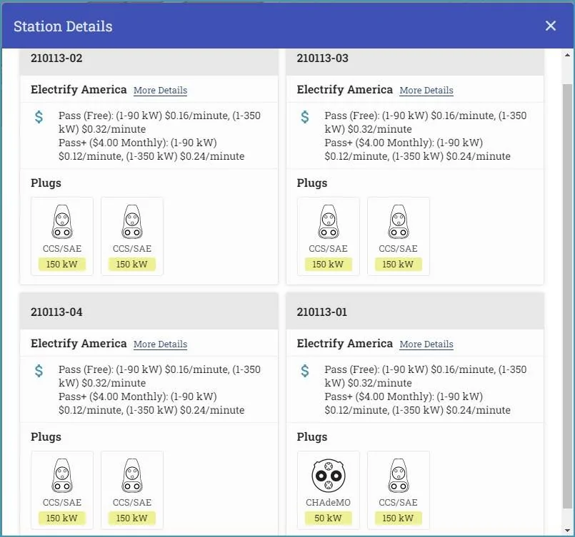

I am running low on my Ford pass bundle free 250 kWh, so am starting to think about how EA pricing works. The screen shot is from Plugshare for a Massachusetts EA location. How do the pricing tiers works? It says (1-90kW) $0.16/minute, (1-350 kW) $0.32/minute. Do these kW rates refer to the actual rate of charging, so I would pay $0.32 /minute if my Mach-E charged at it's normal somewhat above 100kW rate, and, once my session slowed down below 90 kW as the battery SOC increased, the per minute rate would change during the same session down to the $0.16/minute?
Or, does it refer to the charger capacity, which is this case for all the CCS chargers are 150 kW, so the whole session would be at $0.32 /minute, no matter the actual rate?

No, it does not refer to charger capacity. There are no EA 1-90kW chargers.
Since the Mach E draws more than 90kW, you are likely to be charged the 32¢ rate as a non-member or 24¢ as a member.
There's no likely about it. ;) The Mach-E requests, at peak, ~150kW. It always falls in the upper tier, regardless of whether it's at 80% and requesting only 44kW (or less lately).

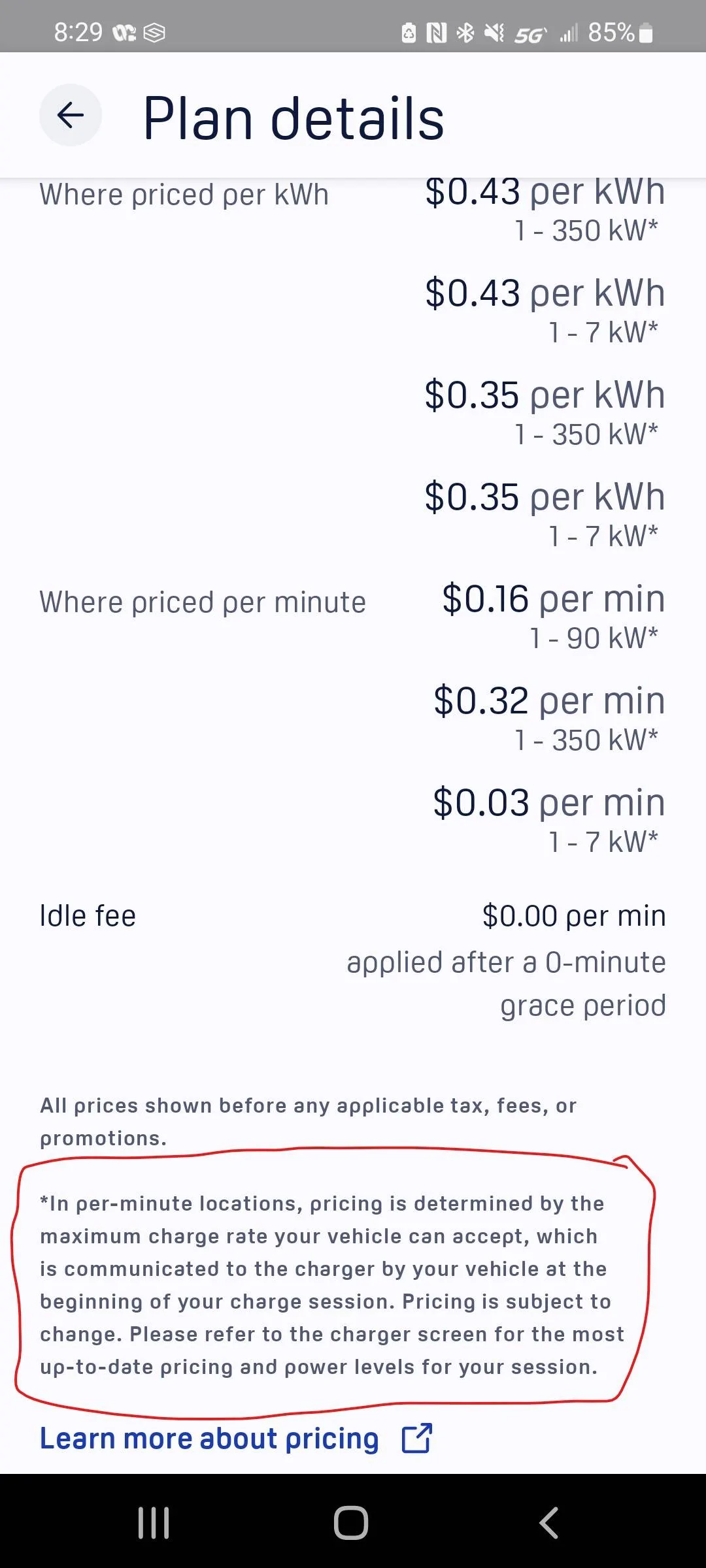

I drove by the subject charger this morning to test it out (in the name of science). I got there, and, instead of plugging in first like I normally do (which would trigger the free Fordpass 250 kWh bundle), I opened the app to use it to start the charging session, and lo, and behold, the text below, crystal clear. I think this confirms what RickMachE has been saying, so I didn't bother charging as I really didn't need it.
"* In per minute locations, pricing is determined by the maximum charge rate your vehicle can accept, which is communicated to the charger by your vehicle at the beginning of your charge session."
Thanks, RickMachE and all.

Not quite. It is based on the peak charge rate during a session. So if you started charging the MME at 80% and only get 44kw, you are at the lower rate. Also if the charger is in a limited mode and outputting only 35-45kw (as many have experienced), you also only get charged the lower rate.
If at any point during the session the rate is above 90kw, the higher rate applies for the entire session. The rate does not switch in real time.
First, it doesn't apply in per kWh states. PERIOD.
Second, on EA's site it tells you very clearly, when you pull up a per minute state:
Pricing for DC fast charging is determined by charger location, your plan, and, for per-minute locations, the maximum power level your vehicle can accept. Pricing may be subject to tax, if applicable for the location of a particular charger.
Question for you AZBill, can you show proof that a Mach-E plugged into an EA charger, in a per minutes state with % of charge above 80%, and got the lower rate?
I'll assume for a minute that you can provide this proof. Let's assume you can. So what? How many people pull in to charge at EA when they're at 80%. Would that be say 1 out of 10,000 charging sessions?
I look forward to the proof. ;) Until then, my belief is that the rate is determined based on what the vehicle CAN accept, which is higher than 90kWh.
