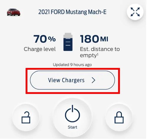

if i want to use my plug & charge credits, is there any other way to use them?
Activate the station via FordPass before plugging in to use your free EA kWh provided by Ford. (On the Home screen tap the 'View Chargers' button. Find the charging location and specific dispenser you are using, swipe to activate.)
After those credits have been used up then sign up for the monthly EA membership and activate the station via the EA app (or tap) to get the best membership per kWh or per minute prices.

where is that in the FP app? i went into Vehicle > Blue Oval Charge Network and didn't see anything new there. or do i need to go into the map and tap on the charger? i guess that's probably it (click select? yeah that looks like it.)

lol i am blind, that thing has been staring me in the face for months and i never noticed it. but it goes to the same place in the map tab.
