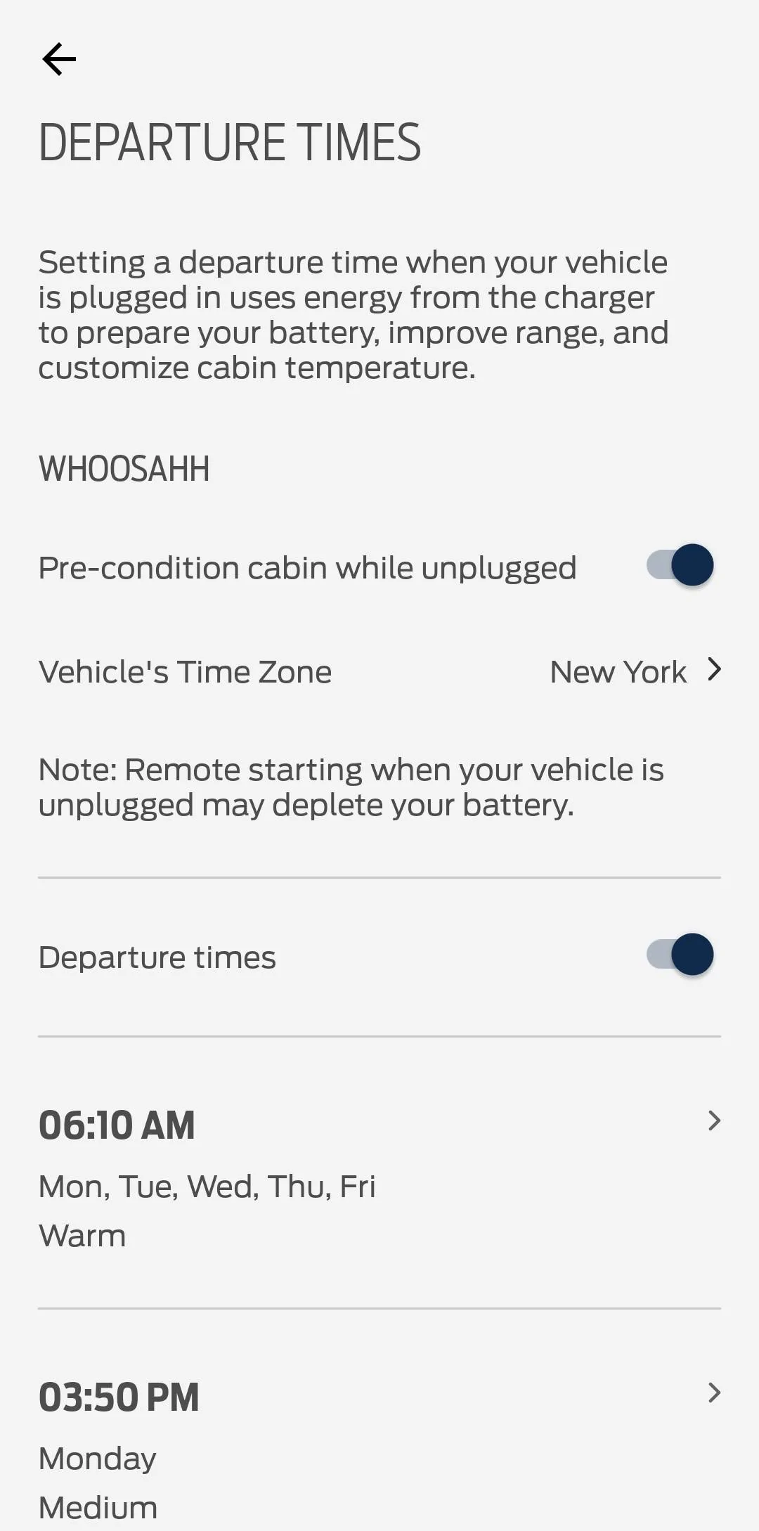

Perhaps it is the phone you are using
I have read comments regarding difficulty with the app as iphone users. I have the app installed on my Samsung Galaxy 20 which I have used to schedule charging times, cabin warming, trip planner, etc, without incident, on and off the charger. This morning upon awakening at 5, I changed the cabin setting from "medium" to "warm" a little over an hour before my departure; I received a notification that the cabin was ready before I left home
Also, you should check the setting permissions you have allowed for communication between the app and the phone.
Good luck.
Ford Mustang Mach-E Preconditioning didn't work Screenshot_20231103_124520_FordPass
