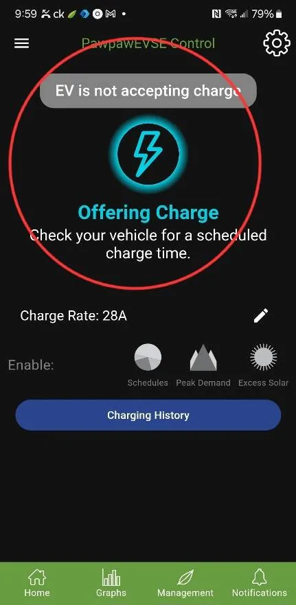

What did you see in the Emporium app before you unplugged?
I ask because unless it looks like this (image below), the Mach-E departure time might be conflicting with the EVSE status?
I honestly didn't even look at the app. Only the charger itself showing good to go. I do have the option turned on to warm up the cabin even if not hooked up to a charger and it most definitely did not turn on.
If it does it again I'll make sure to look at the app.
There were a couple of recent posts from fellas that did not get the "departure time" pre-conditioning that they usually got while plugged in, and I think one suggested that he had to toggle off the feature for warming the cabin if unplugged.
Maybe a bug in some update?
Or perhaps even just a temporary glitch. Who knows?
But yeah, if plugged in to an EVSE and a departure time is set, and you are within 30 minutes of the departure time, you can just use the Emporia app to confirm the Mach-E is sucking the electron straw from shore power. :)
