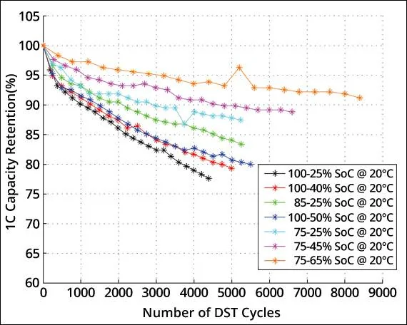

Nope. The study produced almost triple, est 300,000 to est 800,000. I was being conservative saying double, but I won’t always stop at 60%. Occasionally, I need 80-100%.
A possibly larger consideration for me is that I don’t put a lot of miles on my EV. The years take a toll as well.
Here’s the video link. The chart I recalled is about 10 minutes into the video.
That's an incorrect interpretation of the data. The guy in the video doesn't fully know what he's talking about (as I like to say, "knows just enough to be dangerous"). The x axis is in test (DST) cycles, one cycle is the discharge and charge to the target percentages listed. The graph is not compensated for total (100-0%) cycles. The magenta line represents only a 30% depth of discharge per cycle, versus a 75% depth of discharge for the black line. So just from differences in depth of discharge in the different test cycles, I would expect the magenta line to be 2.5x more cycles. It's actually 5x more, so that means the effect on battery life is at most 2x in this particular test.
Ford Mustang Mach-E Departure time charging DST-cycles-web2
100% charge in these tests is usually 4.20V/cell, if you charge the Mach-E to 100% the voltage is more like 4.12V which is already much less stressful on the cells. So it would be better to imagine a curve somewhere between 100% and 85% starting percentage representing 100% charge on a Mach-E. We should also compare curves that are the same depth of discharge percentage (e.g. 30%, but the dataset makes that difficult). Last, another issue is the capacity loss from 100% to 90% is more rapid than loss to a typical 70% replacement threshold. If you account for all these factors, the the lifetime gain from charging to 100% vs 60% is at most about 1.4x (40% more).
In reality the difference is smaller than that, because in most cases the battery will die from calendar aging way before you cycle it to death. That graph represents like 300,000-400,000 miles of driving, the car isn't going to be driven that much before it reaches 20 years old and is junk.
The effect of choosing a lower target charge percentage becomes smaller the further away you get from 100% charge (diminishing returns). Dropping the target charge percentage down from 100% to 80% will already give you about 70% of the maximum possible lifespan increase (which would be at maximum only charging to 50%).
In summary, in a real word EV situation you're not really prolonging the life of the battery that much more by charging it to 50% or 60% verses 80%. 80% is sort of the sweet spot where you get the most range for the least degradation, which is why it's used at a suggested reduced charge limit in many lithium battery applications (such as your smartphone).
Put another way with diminishing returns, charging to 90% is a lot better than charging to 100%. Charging to 80% is a fair bit better than charging to 90%. Charging to 70% is only marginally better than 80%. And charging to 60% or less is only a tiny bit better than charging to 70%.
