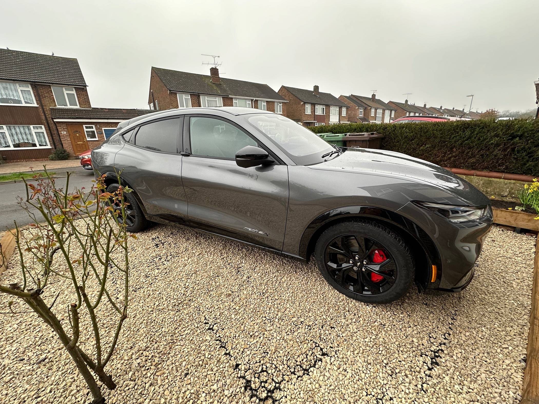

ps. Had to attach a photo of my new car ☺
Ford Mustang Mach-E Departure time/ max charge level location settings bug IMG_2567
