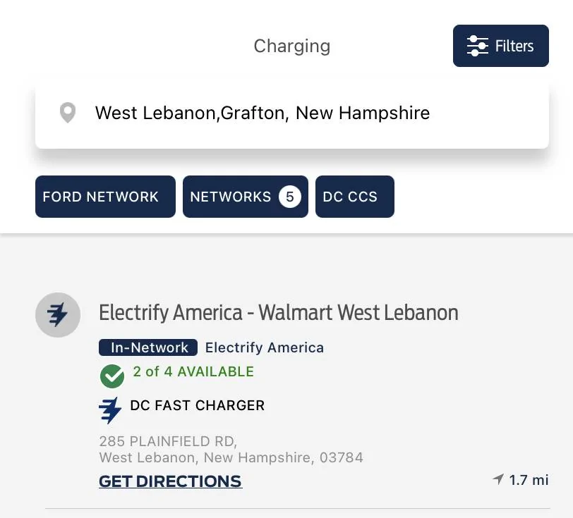

Also, this EA site in New Hampshire still doesn't come up in the FordPass app to select it: 267 N Plainfield Rd, West Lebanon, NH 03784. Weird.
In the EA app it shows the address for this charger as 285 Plainfield RD, West Lebanon, NH 03784. I just tried that address in the FordPass app and it does show the EA charger.

Thanks guys, yes I see it. I guess I didn't scroll down enough.
But... I can't get the in car nav to see that as a valid charging location no matter how I try to trick it into using that charge location. When adding it as a waypoint, it still has me charging somewhere else nearby and it doesn't come up as a valid option when trying to replace a charging point.
