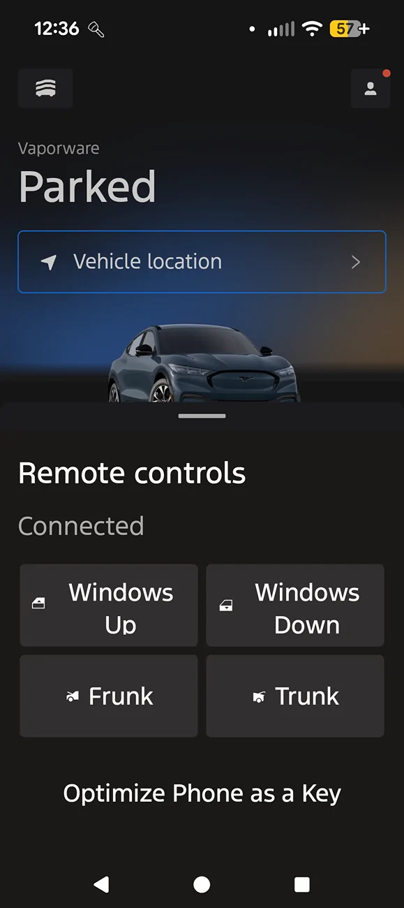

Please allow 2 weeks and I could post my review after December 21st.... as I understand the new frunk kit fully compatible with, key fob, app and etc.

After using it for a couple of weeks here’s my feedback; It technically is plug-in play because there’s no splicing however, you do need to replace your strut which I show in my video. It’s not difficult to do. We’ve already shipped out a handful of kits including one for RHD.
Compatibility wise, it completely integrates with the Ford ecosystem. It works with the key fob that works with the on-screen controls. It works with the keypad lock code and it works with PAAK. Maybe I will post a stand alone thread.

Thanks! I can’t really hear anything because of the music. I was trying to listen to see if the system still uses the electromechanical latch and, if so, it would be interesting to know if the system has a way of “knowing” that the latch is fully disengaged before actuating the power operated strut, or if it just has a time delay on the strut. It also would be interesting to know how the system re-engages the latch.
