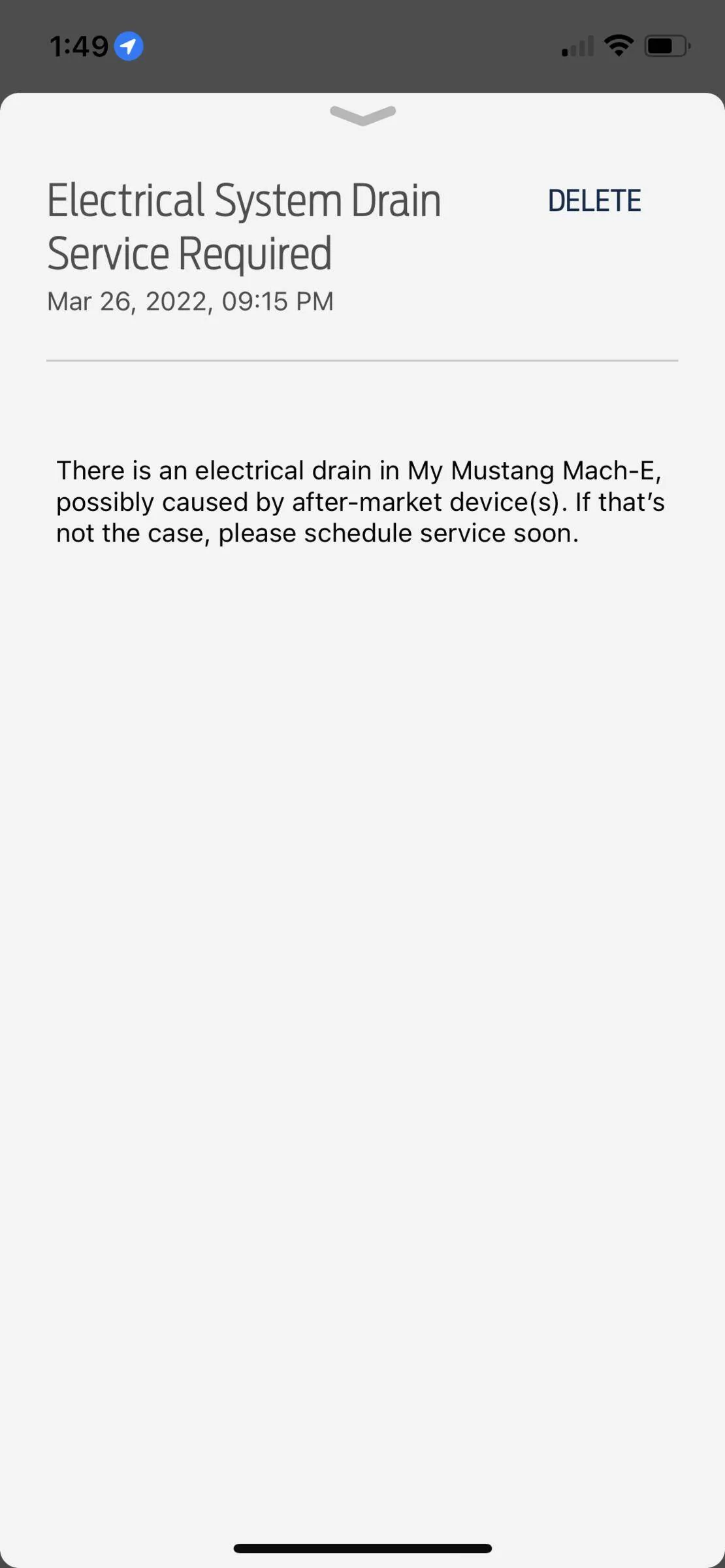

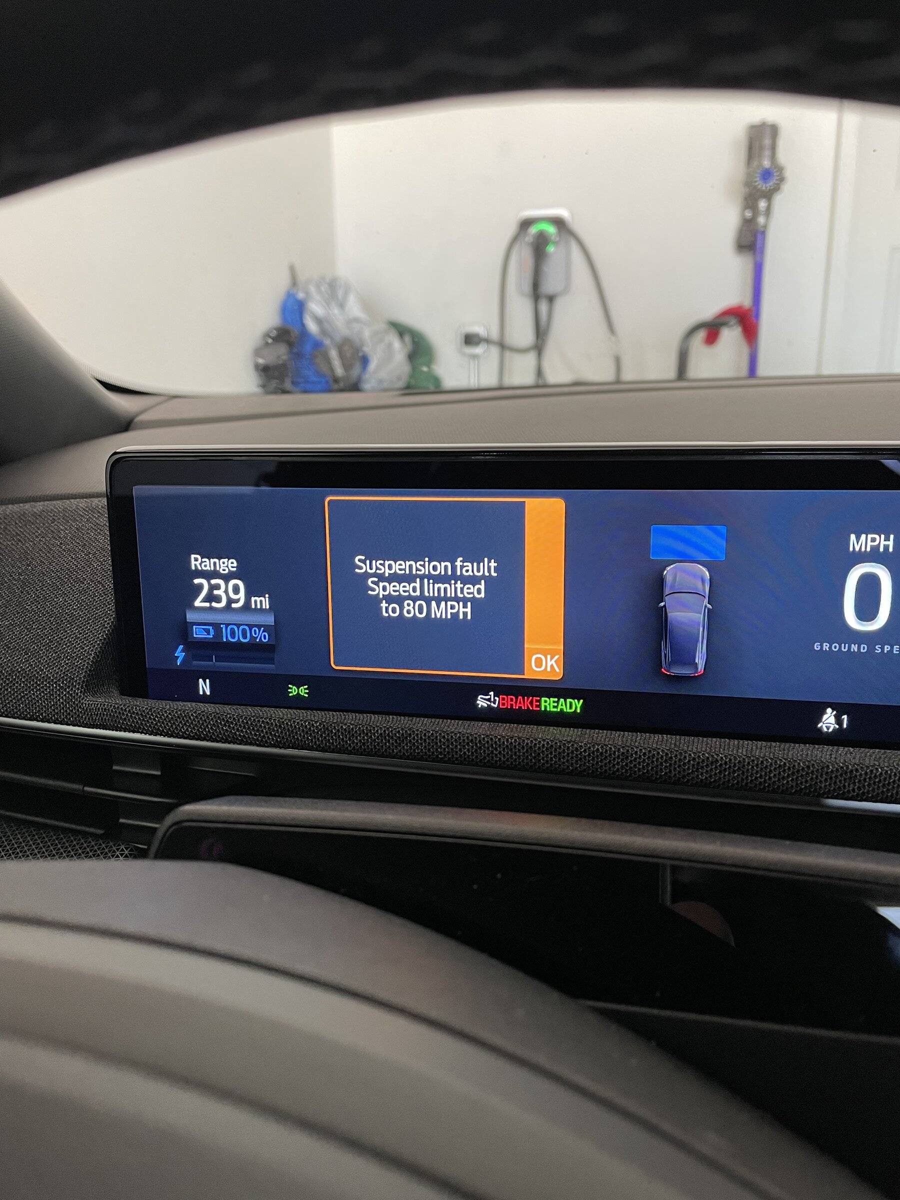

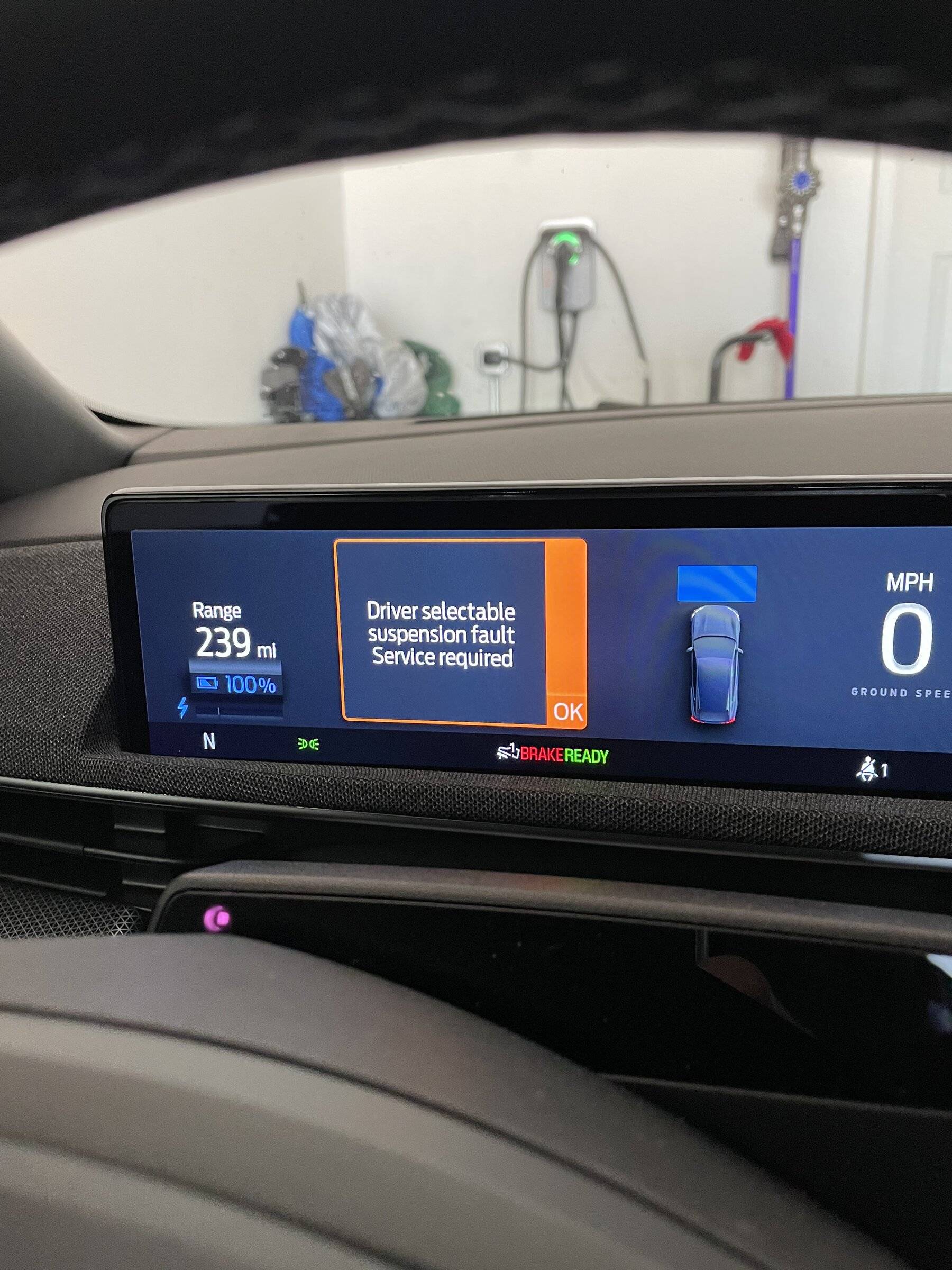

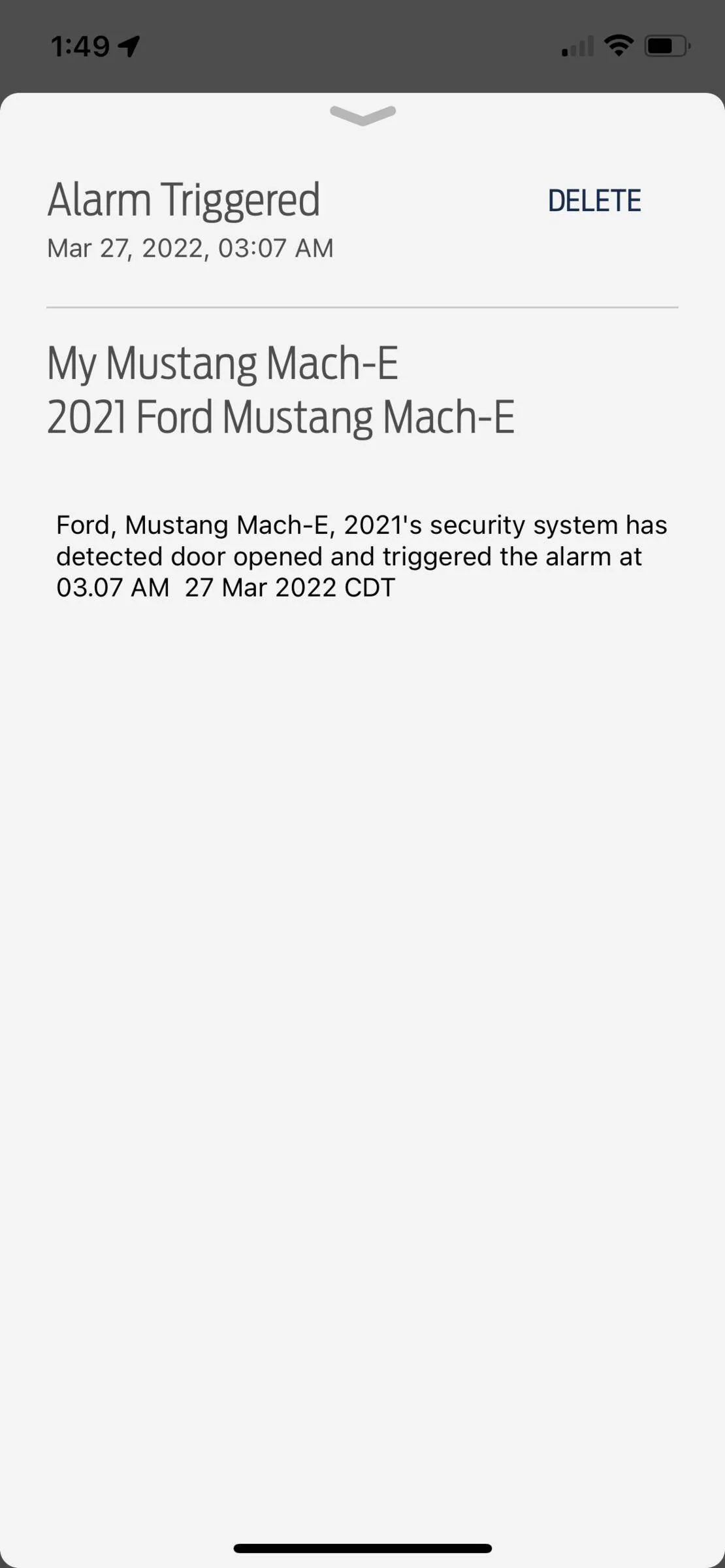

I have a 21 gtpe and woke up to some fun this morning. Overnight I received a couple of messages in my FordPass App about a electrical service drain and a security system alarm. When I went to check on my car I couldn’t get any door to open. I tried the unlock button on my key and no response from the vehicle. I ended up getting the frunk open by jumping the car. I removed the panels from the frunk and disconnected the negative terminal on the battery and let it sit for 5 minutes. After I connects the negative terminal I still got no response from the car. I ended up jumping the battery and the car came to life. I got everything back on the car and decided to take it for a drive. Upon startup I got an error about a suspension fault but the car seemed to drive just fine. As of right now it appears to be fine but I’m nervous to take it anywhere. Anyone run into anything like this?

Wanted to report back after I took my car into service. I was advised that they found the following codes U200D:15, U200E:15 and U200F:15. They found SSM 50077 for this issue. They ended up reprogramming the RFA module to the latest calibration using FDRS, cleared codes and verified everything cleared. They also found codes U0103:87 and U0100:00 and found TSB 21-2405. They reprogrammed the GSM to the latest software level using FRDS and verified everything cleared.
