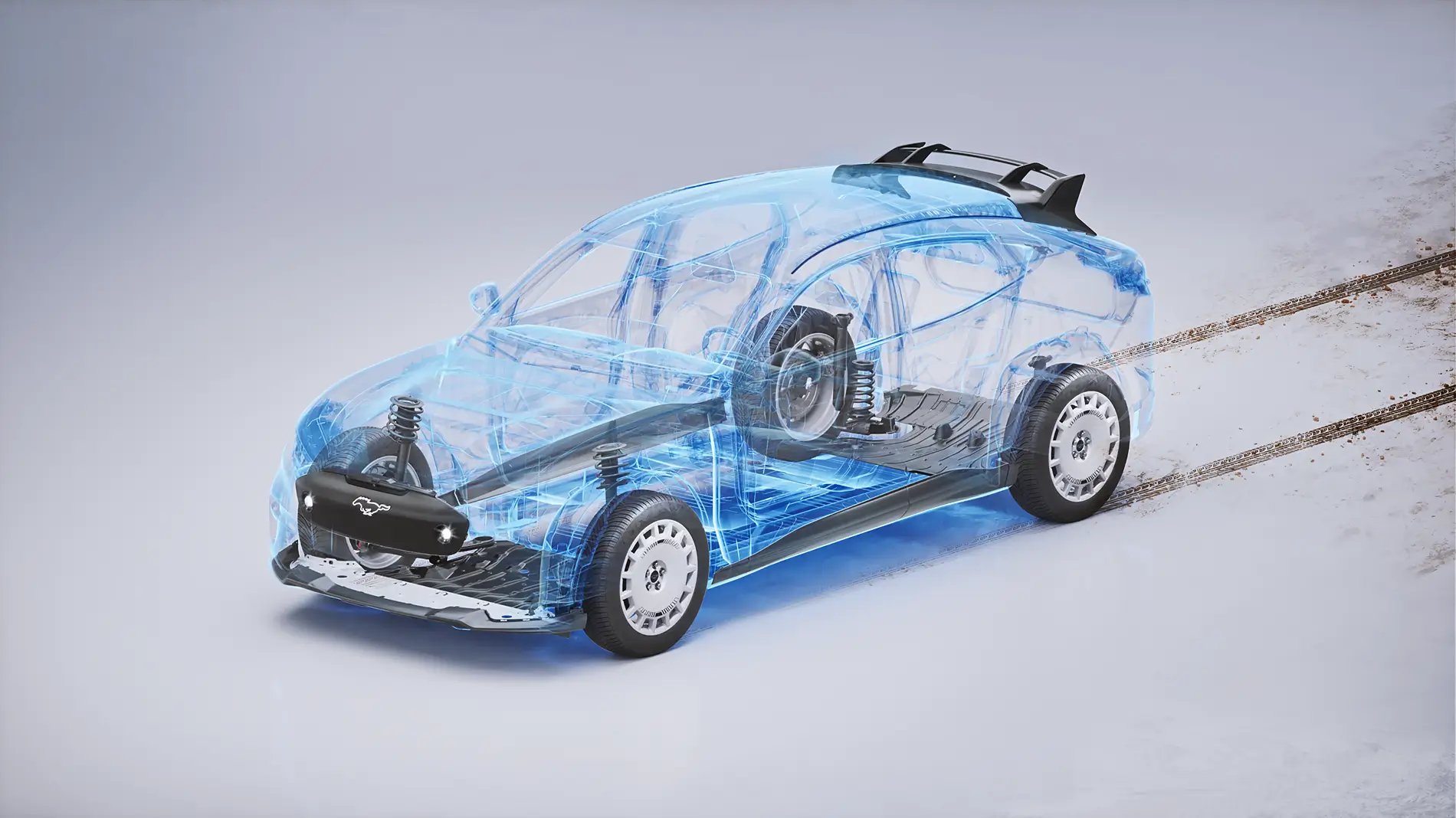

The Rally Hardware
The Rally features real hardware changes including extra suspension travel, uniquely tuned springs, specific anti-roll bars, 19-inch wheels, Michelin CrossClimate2 tires, and underbody shielding.
The engineers tuned this model specifically to handle both canyon carving and maintained dirt roads. If you engage RallySport drive mode, the system allows for added yaw (yes, larger slides), provides a linear throttle response, dials in more aggressive MagneRide damping, and backs off the stability controls.
To prove it could handle the punishment, the team put the Rally through a specific durability test covering 500 combined miles. This simulated 10 years of monthly rallycross racing across varying temperatures, slippery mud, and dry dirt surfaces.
