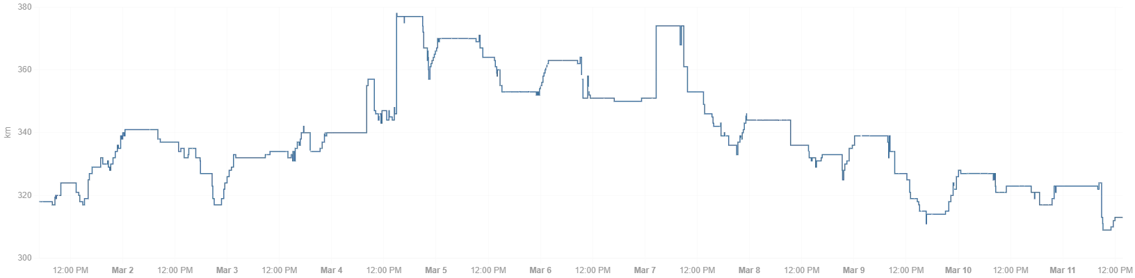

Ford Mustang Mach-E Extended Battery 1647035128813
Here's my range expectation (in kms) over the past ten days. Our temperatures have gone from near freezing point to warm (0-13 deg C 32-54 F). 315-378 km range 195-235 miles.
