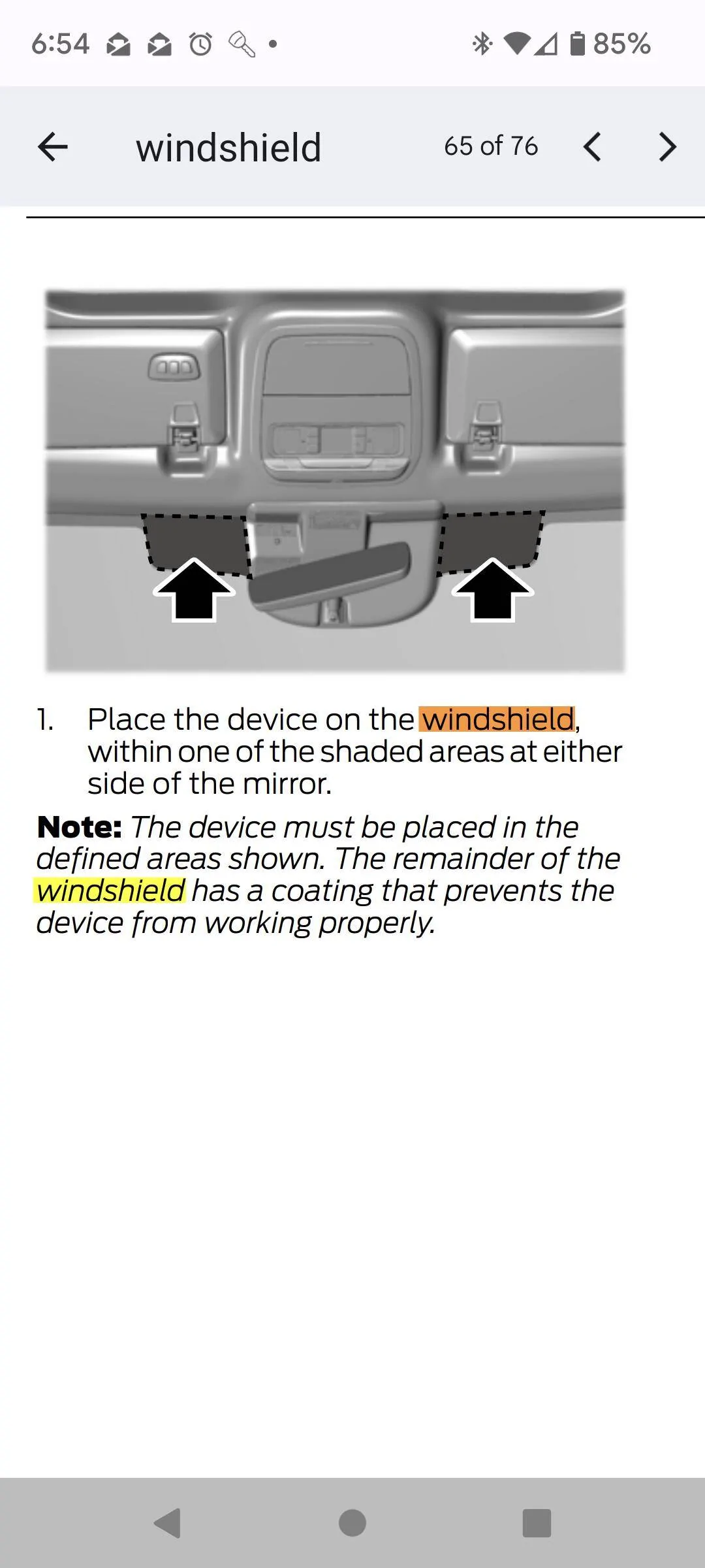

I'm trying to find this in the manual. Where is it located? I currently have the dives on the windshield behind the mirror. It does not work in this position.
Page 351

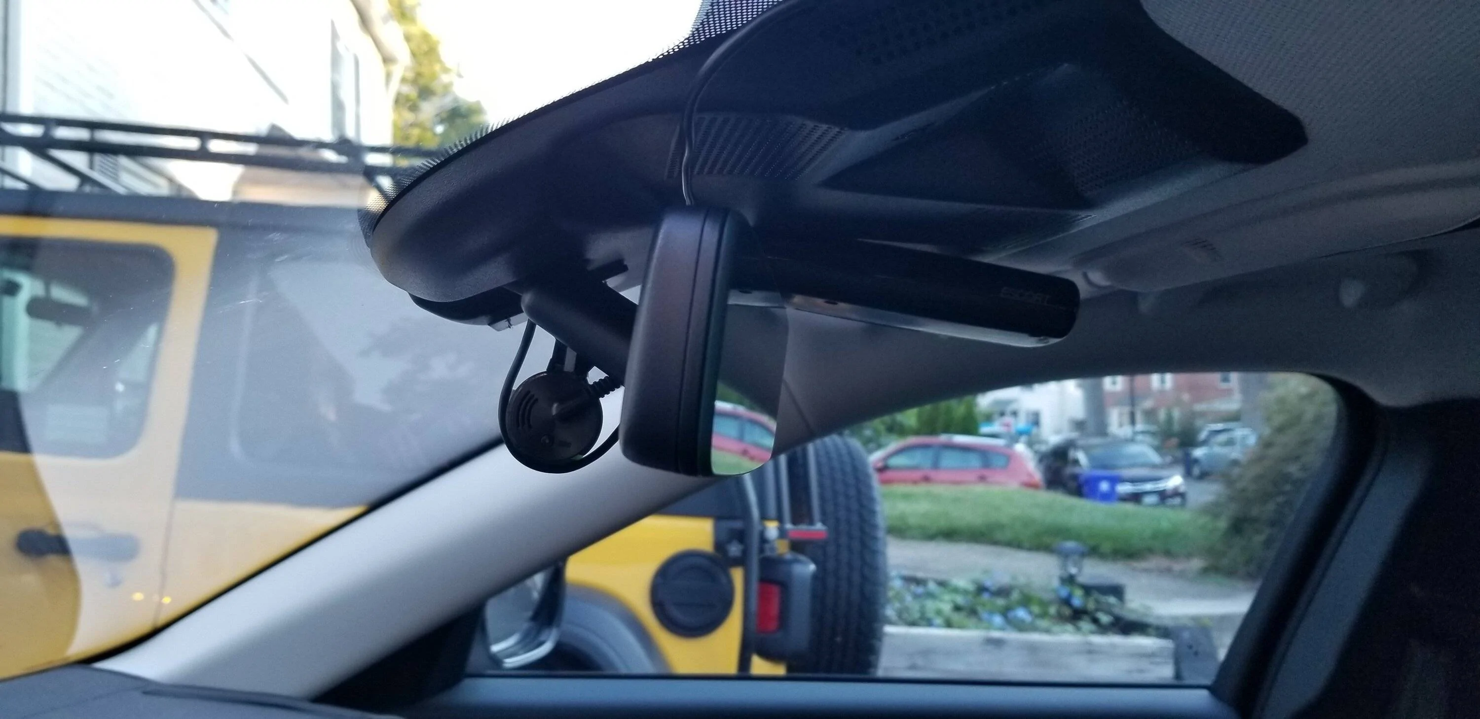

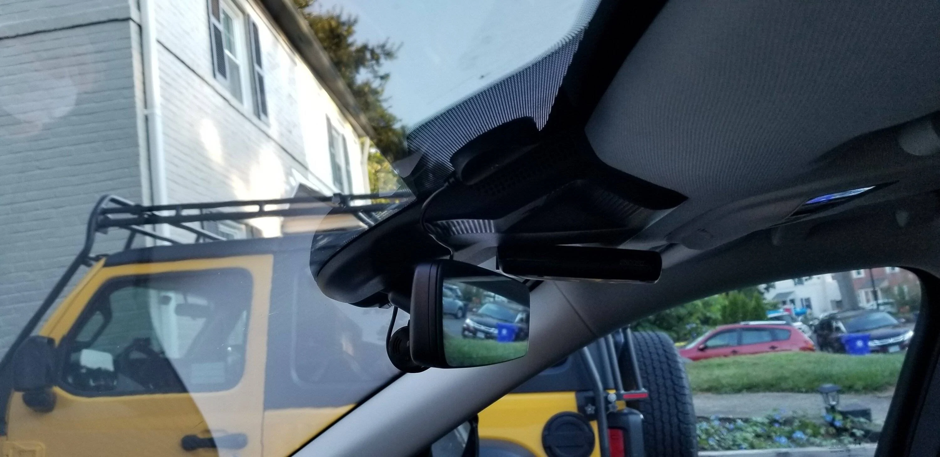

In addition to the dotted left and right glass areas, some (not all!) of the black plastic trim area is also transparent. It all depends on how much metal stuff is where, under that trim, to block or allow radio waves to pass through.
I have my EZ Pass on the right dotted wing, my Thinkware dash cam GPS sensor on the left dotted wing, and my Escort Passport radar detector (when I am outside of Virginia) right in the center right of the trim, just over the mirror... because I found that in that part of black trim location, there is mostly open air between the trim and the glass, unlike further left. See the pic below.
Ford Mustang Mach-E EZpass usage Escort Passport radar and the Thinkware F70 camera - side close-u
Ford Mustang Mach-E EZpass usage Escort Passport radar detector and the Thinkware F70 camera and its GPS module - from profil
