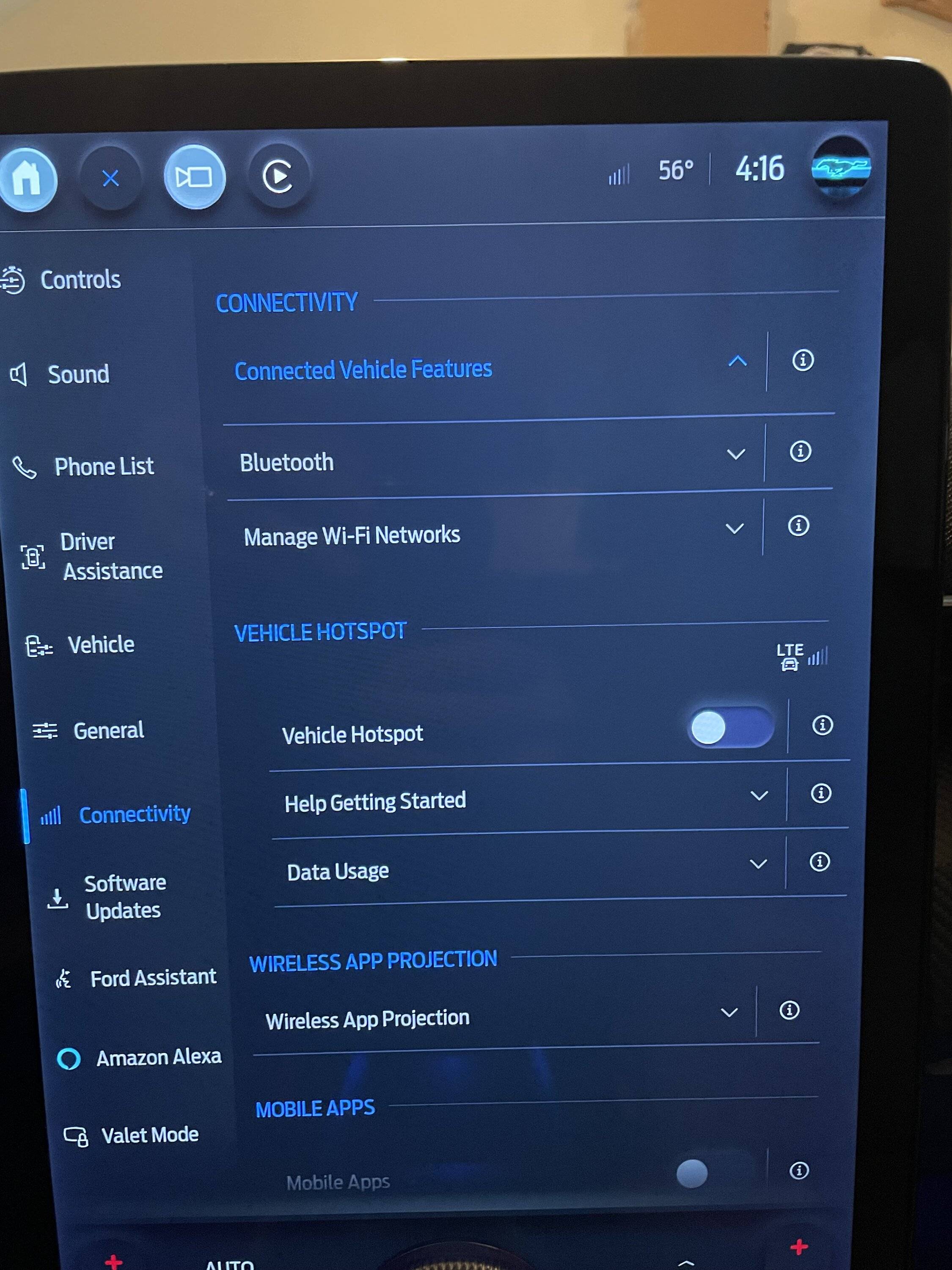

Unless you see this icon on the top row of your Sync screen, trying to open the Connected Features pulldown won't work:
Ford Mustang Mach-E Failed update, features disabled, stopped communicating Connected_Vehicl
And FordPass doesn't use your home Wi-Fi and OTAs don't download that way either.

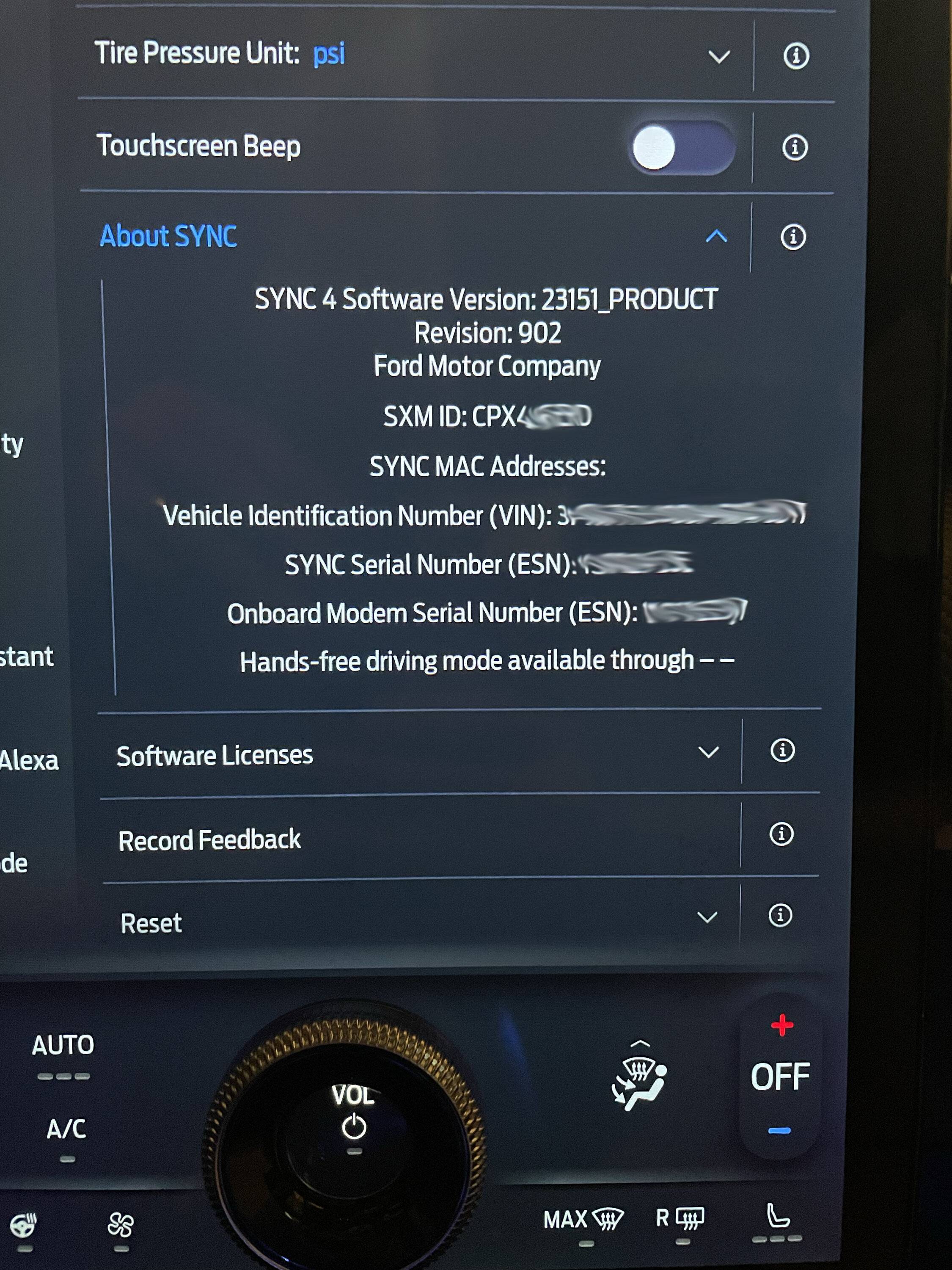

And that "Hands-free driving mode available through --" is a big clue that the gateway at least needs an update or a PMI to sort it out. May not need replacement but a PMI might help...unless of course there's a gateway update available that just hasn't been applied. But that might be too easy.
This is true in the case of connected services being turned on, but menu not loading. If @jayadelson has connected services disabled (which it sounds like might be the case) that icon might not show, even if the menu will load.

I guess it’s possible it was never set up with those services on, but then I don’t see why FordPass suddenly died. I’m guessing it got part way through and update and changed those settings.
I’ve driven the car and tried it, waited hours and tried again… LTE has five bars and strong, I have no idea what’s going on.
My next move is to try the Mongoose.
