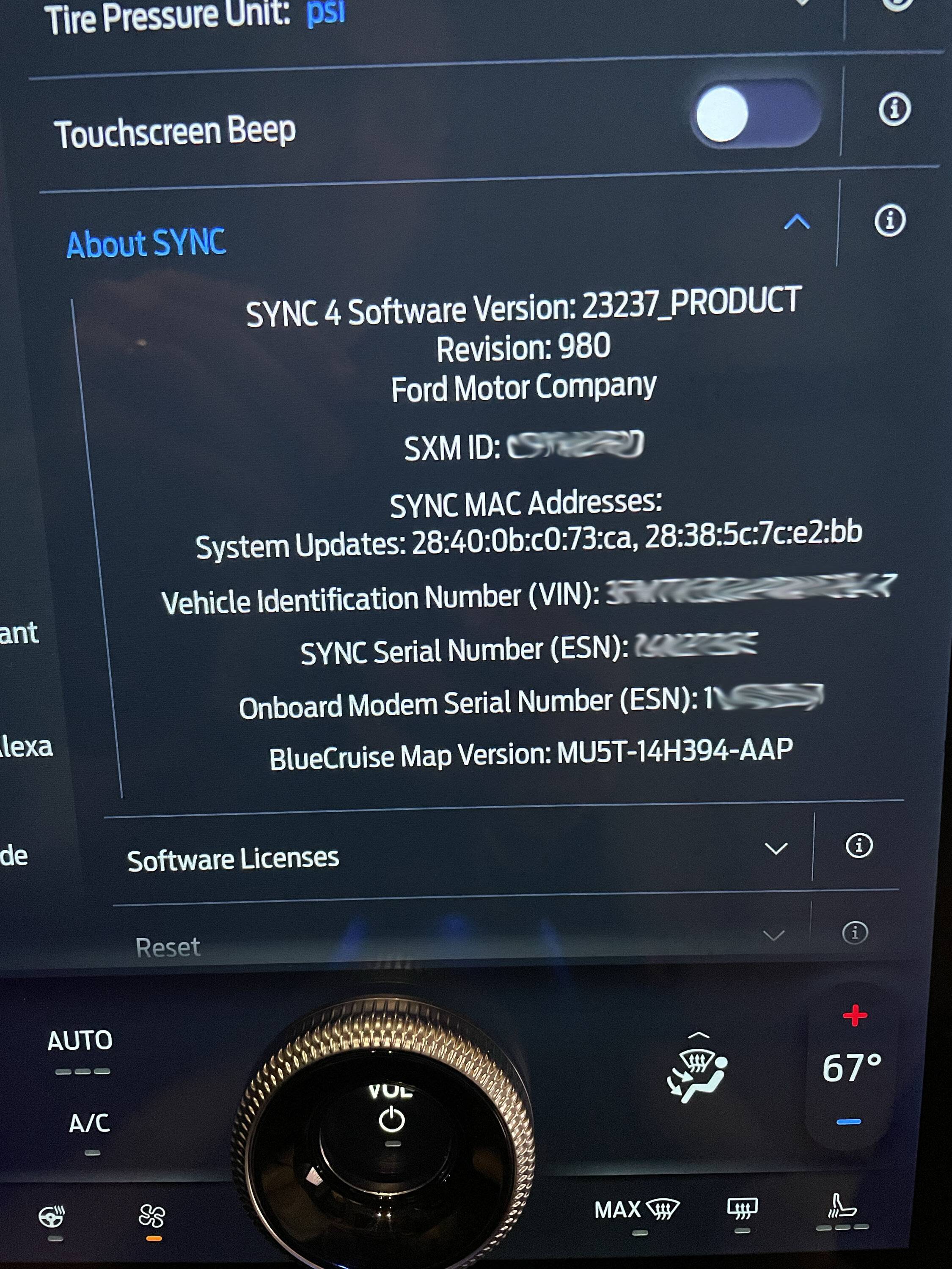

The FDRS software indicates a number of modules need to be updated, including the ACM and GWM. I'm updating those to start, and we'll see how it goes.

Just updating the ACM and GWM already fixed the Connected Vehicle Services issue! No need to swap the GWM module, as @Mach-Lee predicted.
While I’m at it, I’ll catch up the OTA on the other modules and APIM using FDRS. Not sure there are enough acronyms in that sentence…

Hmm... I'm pretty sure the FDRS said APIM was 6.1. I know when we checked, I was queued up with 6.1 anyway. Am I getting my version numbers confused?
6.1.0 is just a GWM update, and if you were queued to receive it OTA then that’s the last thing it would show on your software updates page.
Any updates you manually install via FDRS do not show up in the software updates page in your car. I installed the 6.2.0 APIM update on my car and it’s the same version as what you have now.
6.3.0 is the TCU update, 6.4.0 is SCCM, 6.5.0 was canned due to issues, and 6.6.0 is all the powertrain updates. That’s all we have right now, but again anything 6.2.0 and beyond is currently on hold OTA. You can install it all via FDRS still though.
I see. Since I updated all modules, I'm also guessing I have the updates for 6.3.0, 6.4.0, 6.5.0 and 6.6.0, as no further updates were at all available on FDRS.
The only weirdness was my FordPass app got a notification that there was a blind spot detection fault.
