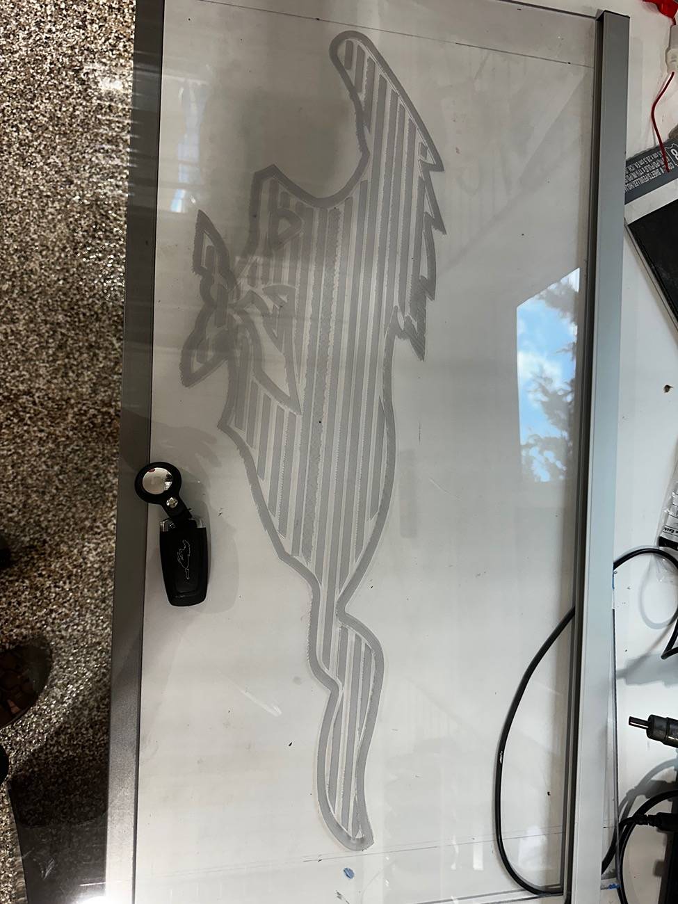

As noted you will probably not be able to use the spectrum analyzer idea to find it. However I did do this to find a lost Bluetooth device a while back.
if/when you find the fob put an AirTag on it.
