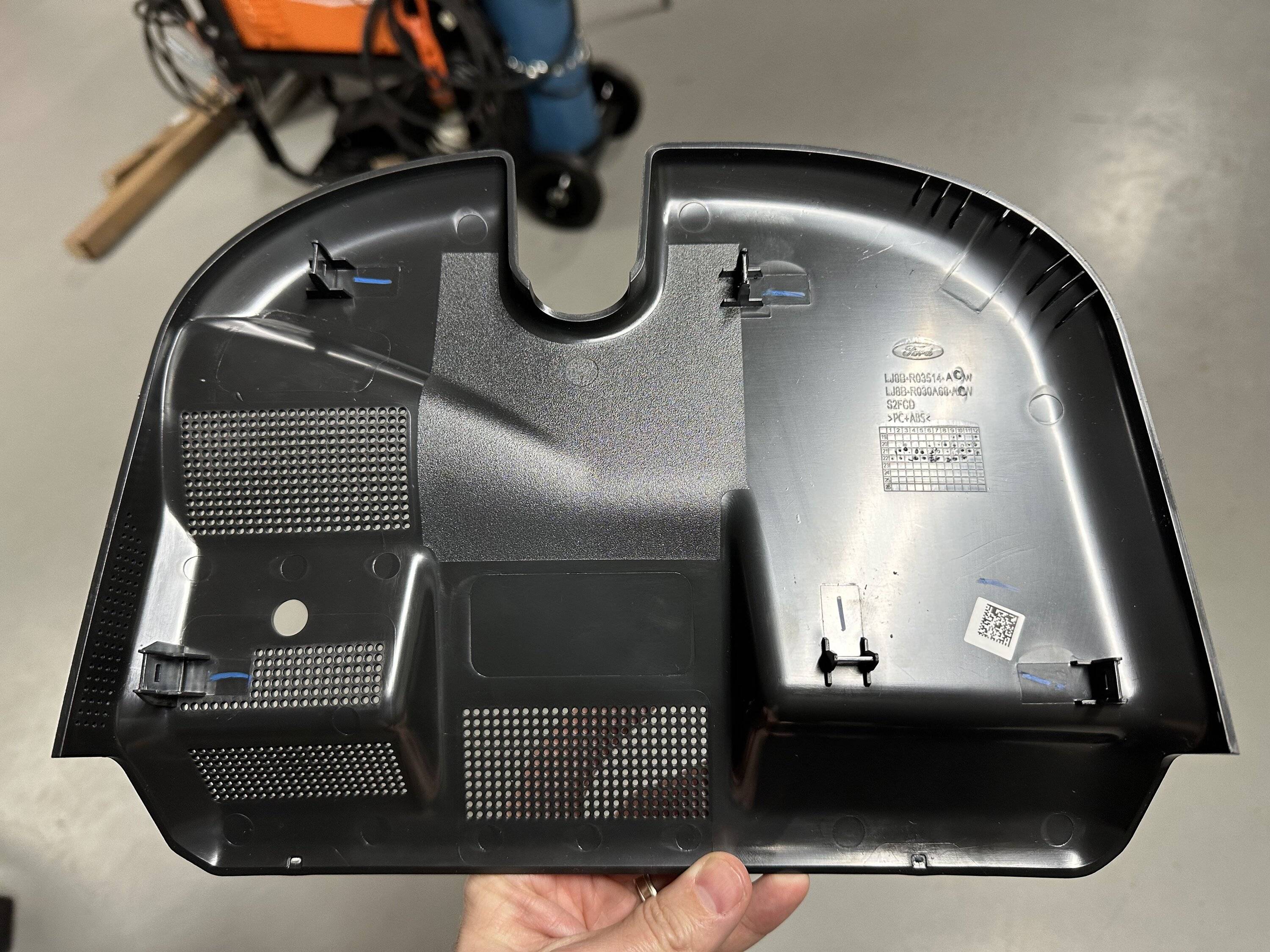

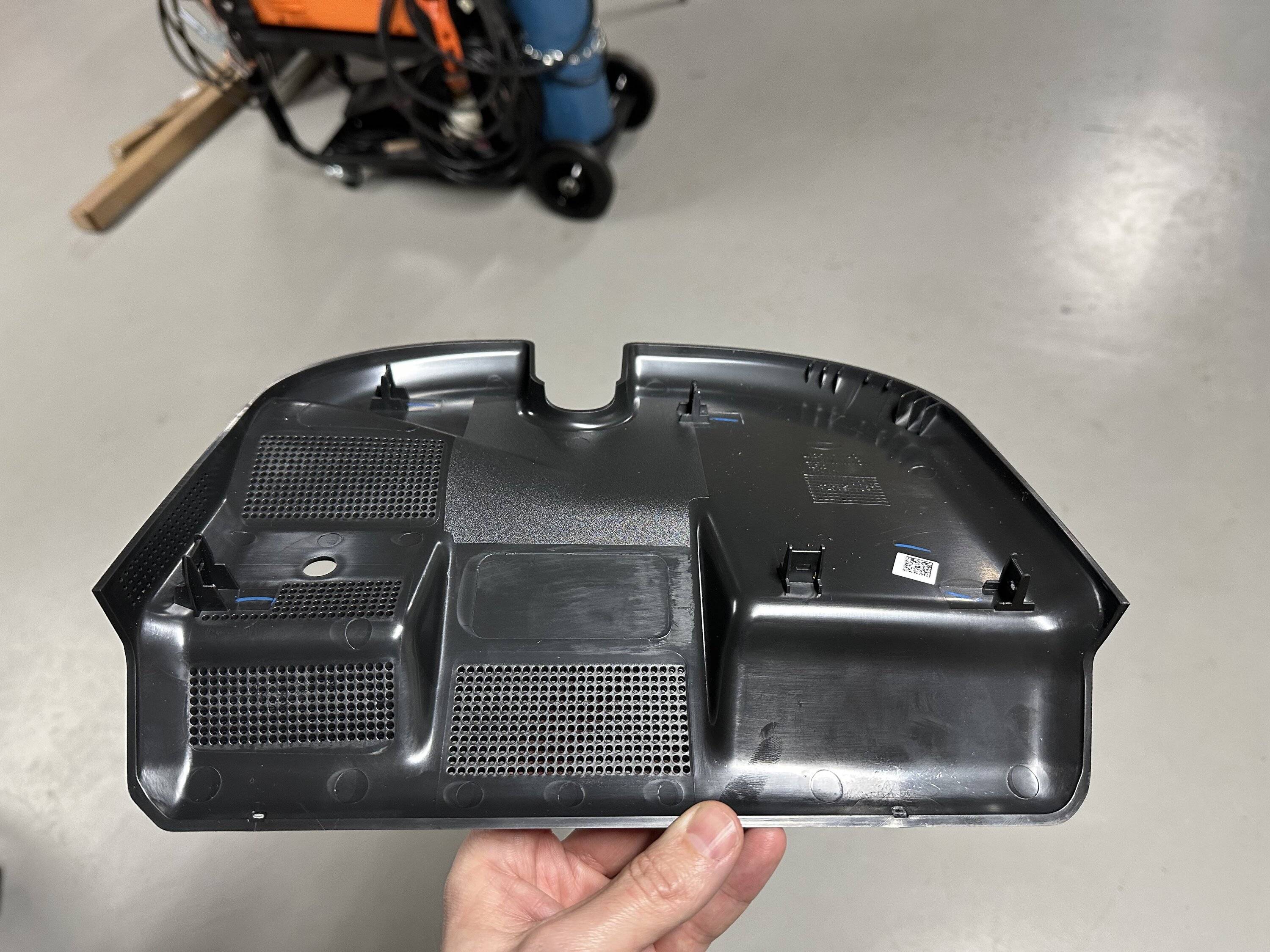

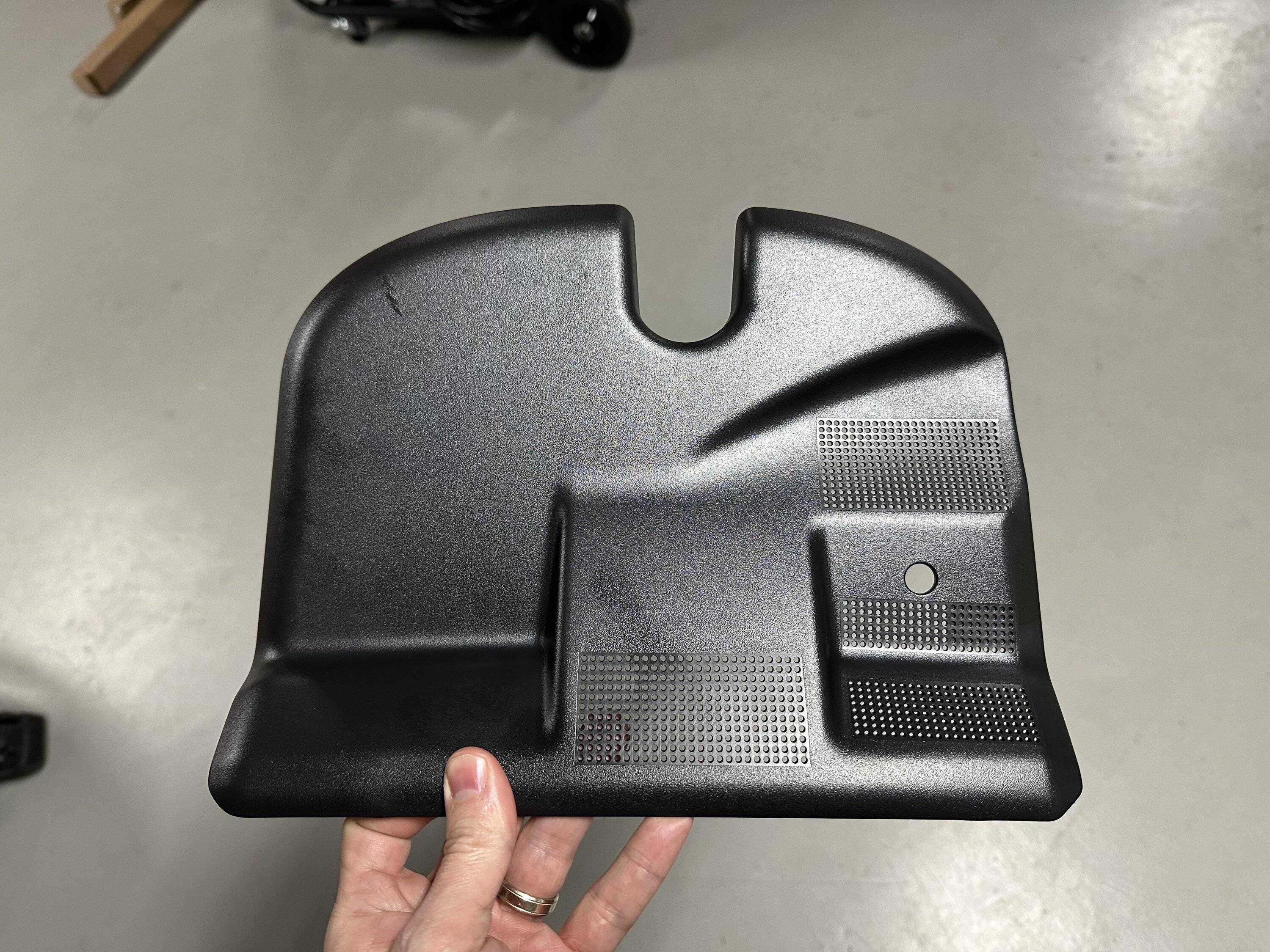

Ok, here are some updates. First, someone asked for pictures of my OE surround. Here they are:

On a side note, does anyone know what the sensor is that passes through the hole in that surround and faces the driver side seat? Looks like a photoelectric or IR sensor of some sort. Sunload sensor for driver?

That is the interior temp sensor. Humidity sensor is also under that cover. Sunload sensor is the pyramid bump between the defrost vents.
