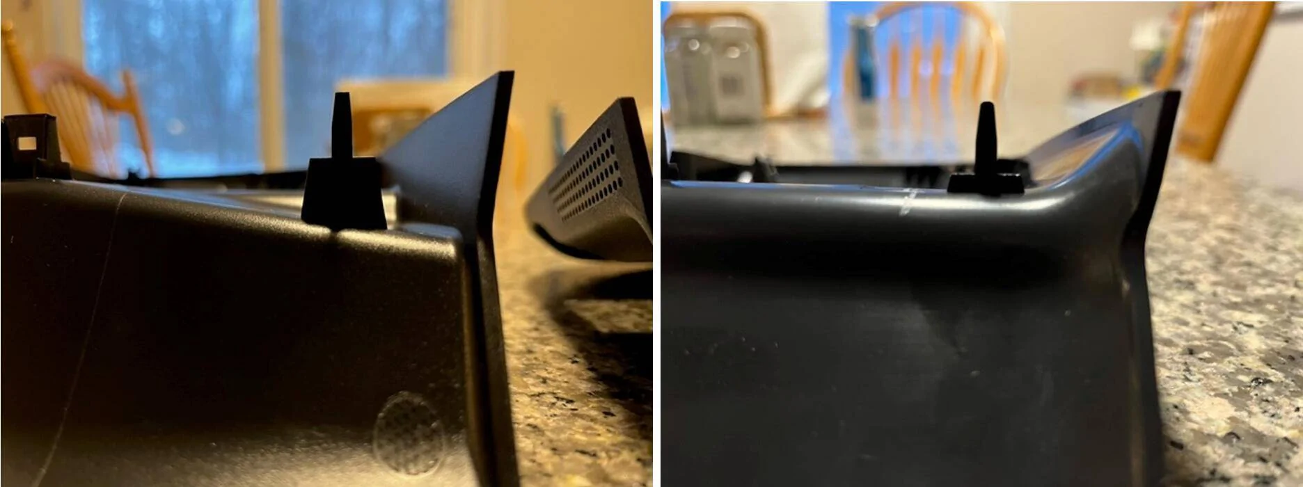

Also, here are some pictures of the mounting tabs that don't fit. Notice that the vertical cross section of the tab is rectangular in the OEM surround, and trapezoidal on the fitcamx surround. I fixed this with a box cutter and some hacking, but without cutting, the trapezoidal cross section just jams into the holes (you can see the indentations from the roof bracket contacting it) and the clips will never engage, nor will the surround seat fully.
fitcamx mounting tab:
OEM mounting tab:
For what it's worth, here is that clip post on my Fitcamx (left) next to the OEM (right). The base is larger on the Fitcamx to get the clip in the right position since the cover dips down there (presumably to give room for the power wire). But the post is the same size, so I didn't have to trim anything.
Interesting. The tabs on my fitcamx surround definitely have a different profile than yours, and it doesn't look like it was just some pieces that needed to be snapped off after molding. I had to really go to town with a box cutter to get those pieces reshaped into the right profile.

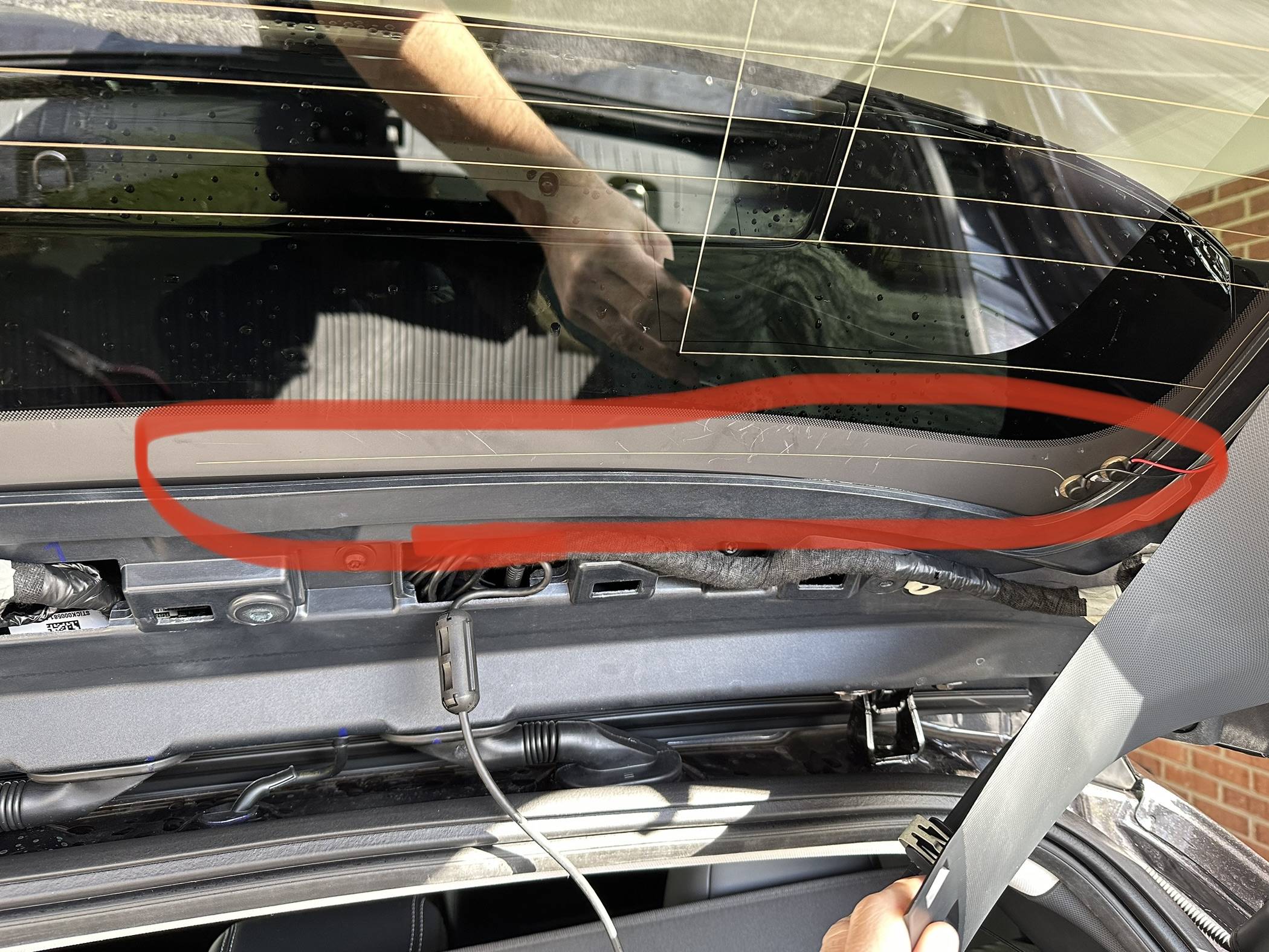

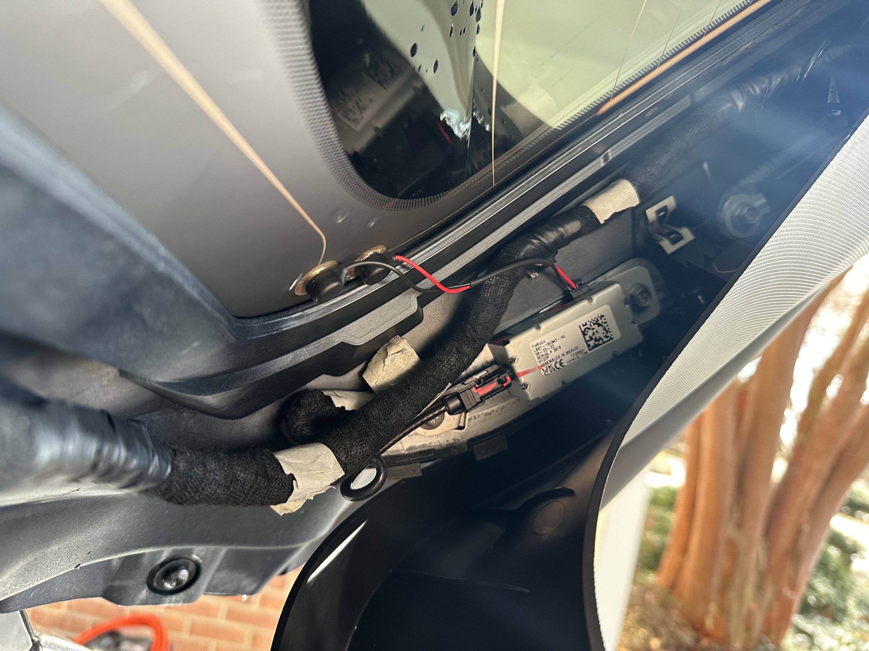

So, I had some time to look at this some more. It looks like the FM antenna is located at the top of the rear glass, hidden behind the plastic trim:
Ford Mustang Mach-E Fitcamx FM Radio Interference IMG_2180

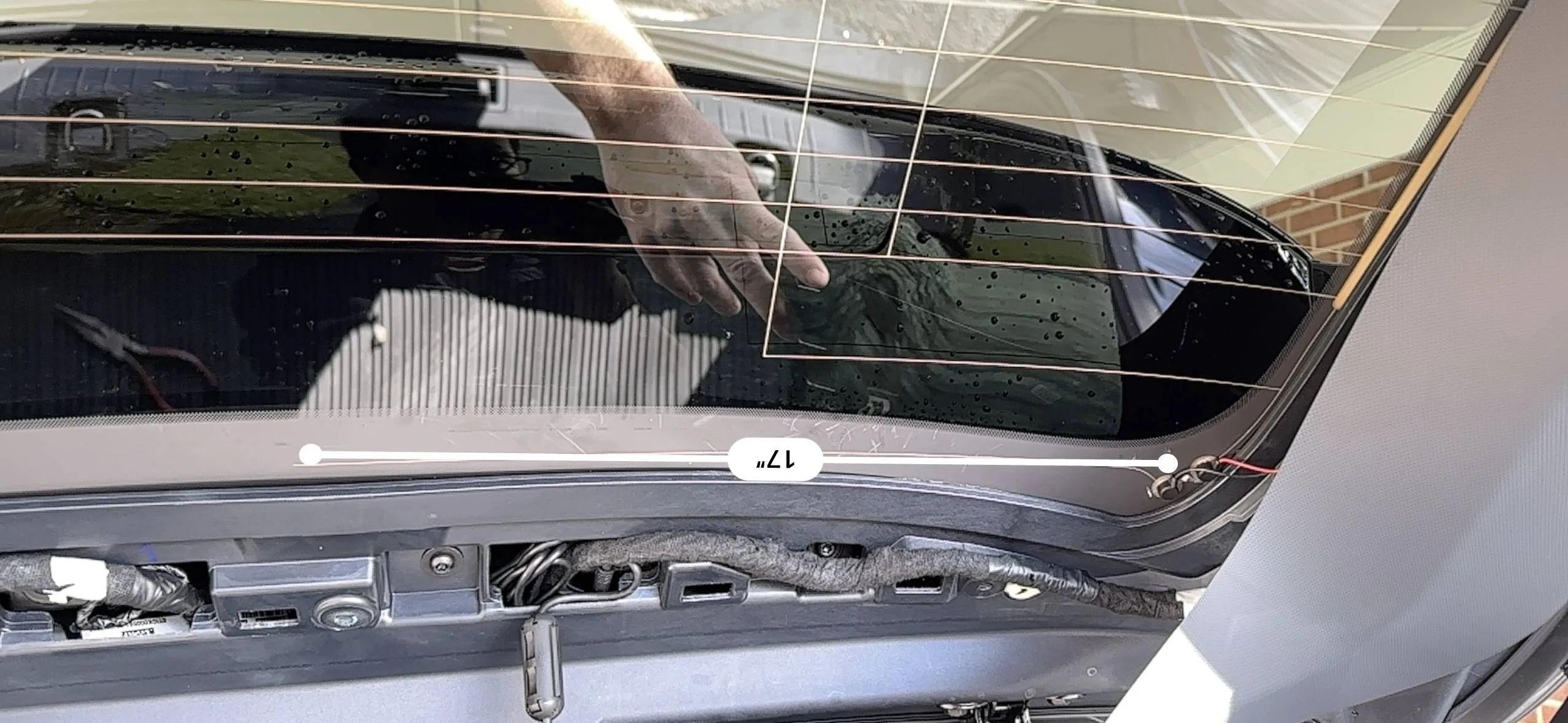

I am assuming this is the FM antenna due to the length being ~1/8 wave at 100 MHz:
Ford Mustang Mach-E Fitcamx FM Radio Interference IMG_2181
Anyway, I moved the camera to the passenger side of the glass, down low near the wiper blade. I was able to get the FM radio to consistently drop out when putting the camera cable in parallel with the antenna trace pictured above.
All seemed well until I tucked the cable around the perimeter of the glass, which also causes the FM radio to drop out. My suspicion is that the AM radio traces are oriented vertically in a folded dipole pattern and the cable is running in parallel with them around the perimeter of the glass. There appears to be a matching/combining network that places the signals from both the AM and FM traces on a single piece of coax:
Ford Mustang Mach-E Fitcamx FM Radio Interference IMG_2178
So, I'm not completely sure what to do at this point. I might try just disconnecting the AM antenna connections from that combiner box to see if that resolves the issue, since I don't really listen to AM radio. But aside from getting rid of the rear camera, it doesn't seem like there are many options here.

Interesting. I sent those pictures to fitcamx tech support. They replied and suggested that Ford had modified the part since they scanned it and that they'd need to get ahold of a new cover to modify their design.
