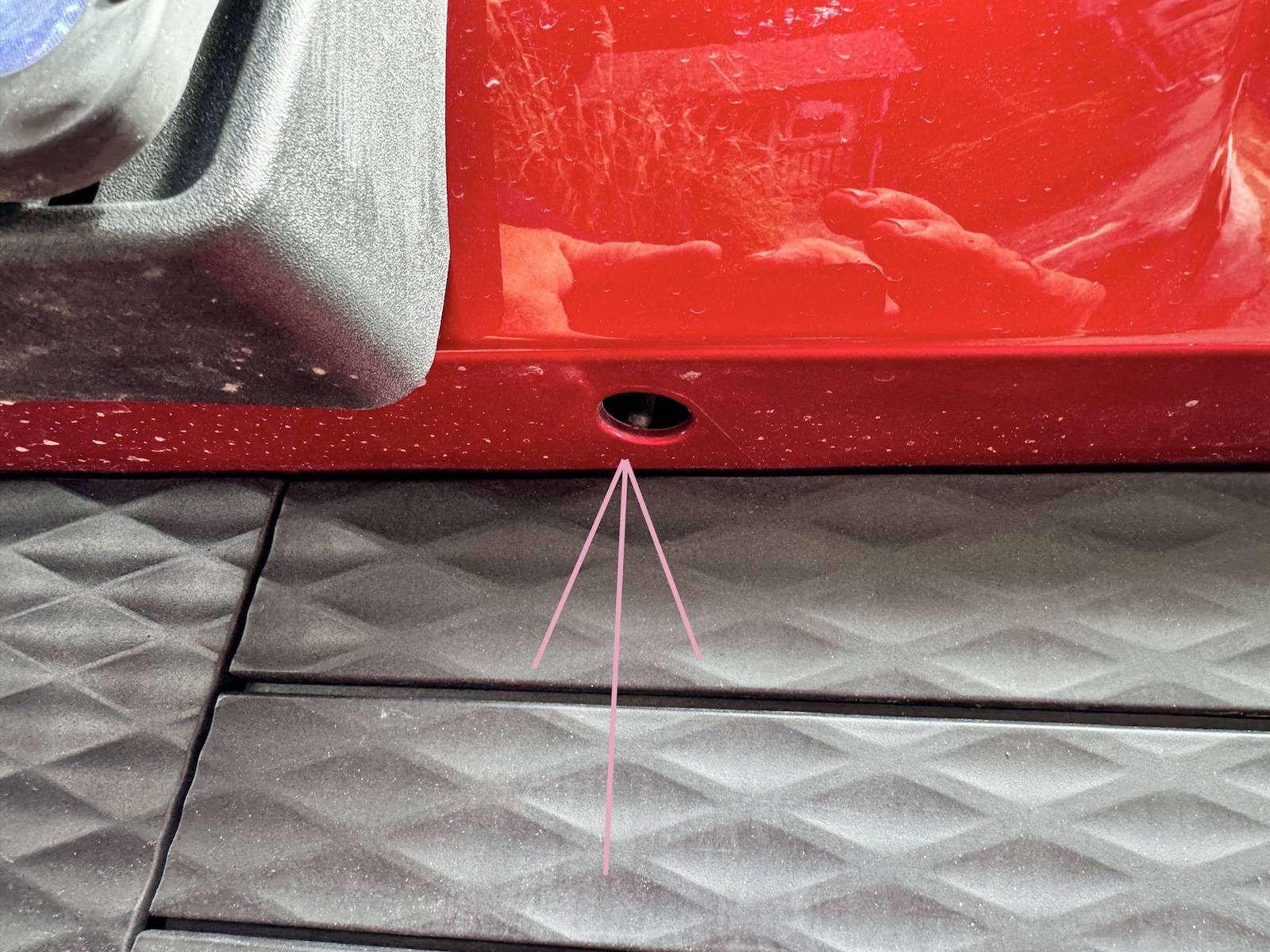

Amazon $35 Cdn... and they are metal housings ...
bracket is at the back, so will mount under the "grill" , and clears the license plate mount.
drivers side of this area has this ?????, im guessing temp probe..... anyone know? - first pic
others are for reference.
no wiring harness, but id rather make my own anyway..

Yes, that’s the outside temperature probe my question is when the shutters open aren’t they gonna hit that fog light just asking?
good question ,,,, i thought i saw they open inward, but will need to double down on research
