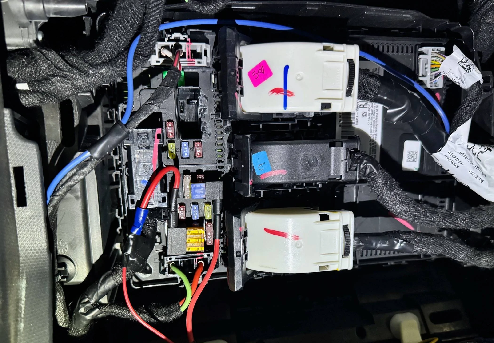

Feeding a wire to the inside of the car needs to be done through a rubber grommet on the driver's side firewall because it is the easiest way. You need to remove the panels in the frunk to get to that grommet. The wire will come through above the steering column then you can run that wire over to the passenger side footwell area where the BCM is.
You can get your underglow lights to come on anytime the welcome lighting and headlights are on (NOT when the car is on unless the headlights are on) tapping into the Green/Orange wire coming off the black center connector of the BCM. Or, you can have them come on anytime the car is on tapping into the Gray/Blue wire at that same black center connector of the BCM.

Below is the BCM behind the carpet in the passenger footwell. You can easily see the black middle connector. You will need to strip back some of the wiring cover to get to the wires. That blue wire coming off the top white connector is for my external liftgate switch and the red wires coming off the fuse block is for my dash cam.
Ford Mustang Mach-E Underglow Lights IMG_9586
