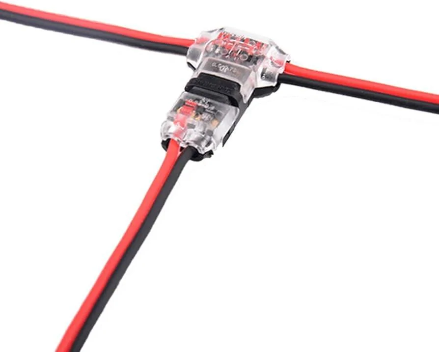

How’d you wire it to the reverse lights? Any issues with doing that?
I'll take a photo during the day to show what they look like.
There was a video of EV Vida removing the reverse light and the bottom cover to convert the rear reflectors into lights, after seeing that it was basically 2 wires, ground and positive, I just wired my lights with low voltage t-taps to the oem plug like these:
Ford Mustang Mach-E Aftermarket reverse lights? 1729484692852-mt
The wires are all snug in the rear bumper, tied them together with the original backup light wires.
