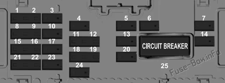

Verify the gateway fuse location in your owner's manual. They are different for various years. 2021 appears to be fuse 11. My 2022 is fuse 20/21. Your 2025 may be different.
