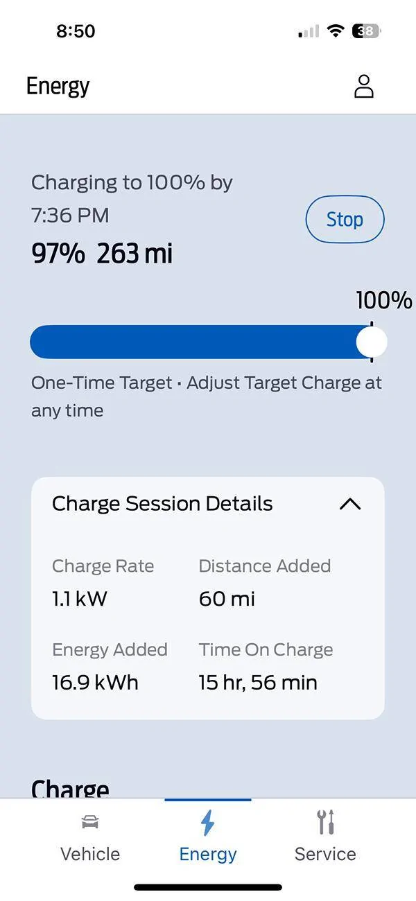

Yes, Ford is really bad at basic math.
L1 charging at 1.1KW. 91*.03 = 2.73. Somehow Ford thinks it will take 11 hours to complete.
