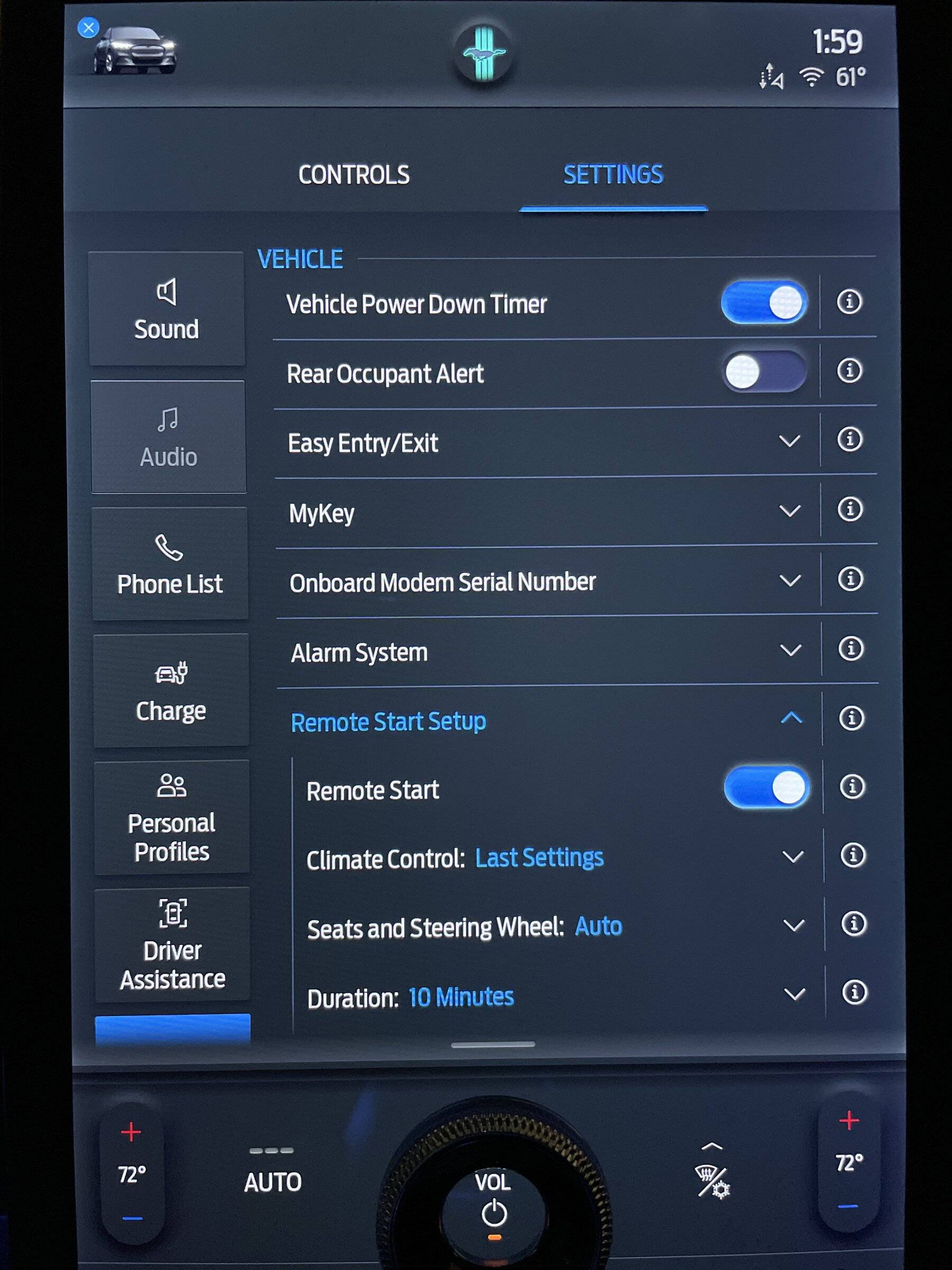

I just fixed my issue. Go to Settings>Vehicle and scroll down to Remote Start Setup. Make sure that is toggled on. Mine originally was and somehow it became deselected at sometime this week. I just toggled it back on and remote start works again
Thanks for the thought. I've checked that multiple times. It's always on. I"ve even turned it off for a few days and re-enabled to see if that helped.
Nope.

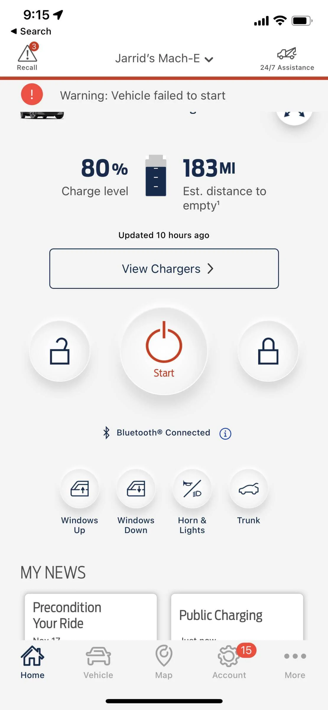

BTW - I get the same error from both my phone and Fordpass account as well as my wife's. phone and account.

Remote Start usually works for me on the second try. Not today and status in FordPass is not updating since I got home yesterday. The car is currently charging, but that doesn't show up either and if I try to force the update, I get a "FordPass is not responding, please try again later" after about 2 minutes. I don't charge often but this is the first time I haven't gotten the charging info in FordPass. It is charging, I can check on the Sync screen in the car.
When I am in Bluetooth range, the car will start from the phone remote start. Walk away lock works fine, basically all the things that could be handled via BT work after getting the car to wake up. And I can get the charging log, etc, so from the Ford server down to the phone works, but from the car up to the Ford cloud instance, nothing.
