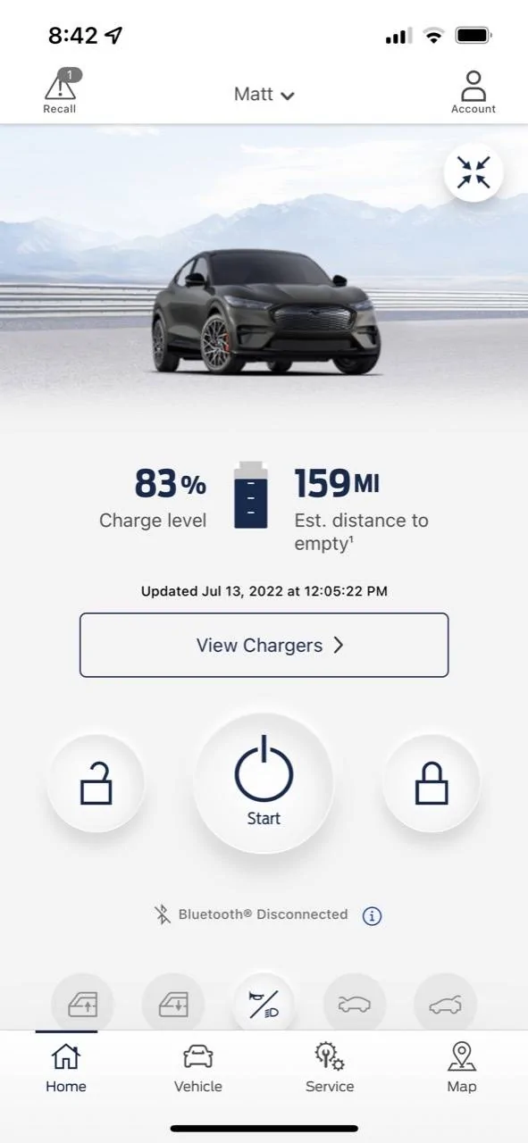

Ok well the only other way I know for sure to guarantee a refresh from the car would be if you're familiar with Postman.
  1. Go to ford.com
  2. Press F12 on your browser (I'm using Firefox as an example)
  3. Click on Network in the Developer Tools
  4. Login to your Ford account
  5. Click on XHR in dev tools
  6. Find users in the left side of dev tools and click on it
  7. On the right side of dev tools look for request headers section
  8. We'll extract data from here later
Next in Postman:
  1. Make a put request to the following url: https://usapi.cv.ford.com/api/vehicles/v2/***yourvinhere***/status
  2. Click on authorization and pick Api Key
  3. On the right put "Auth-Token" without the quotes
  4. In the Value put the Auth-Token from the browser dev tools
  5. Select the add to header dropdown
  6. Now click on Headers
  7. In the bottom box add a new header called "Application-Id" without the quotes
  8. Add the value from the browser dev tools
  9. Click on Send
If it's successful you'll get a status 200 returned and the car will refresh in 5 minutes.
