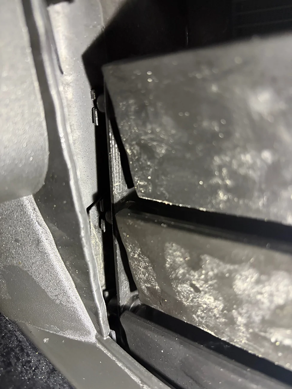

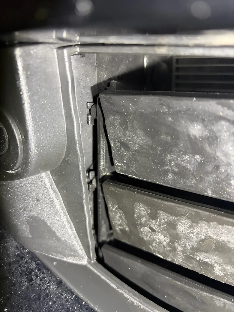

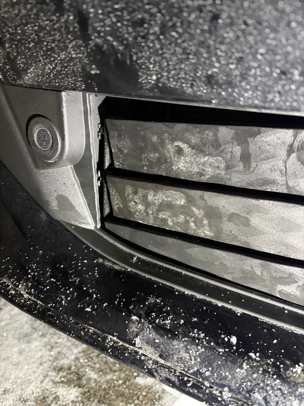

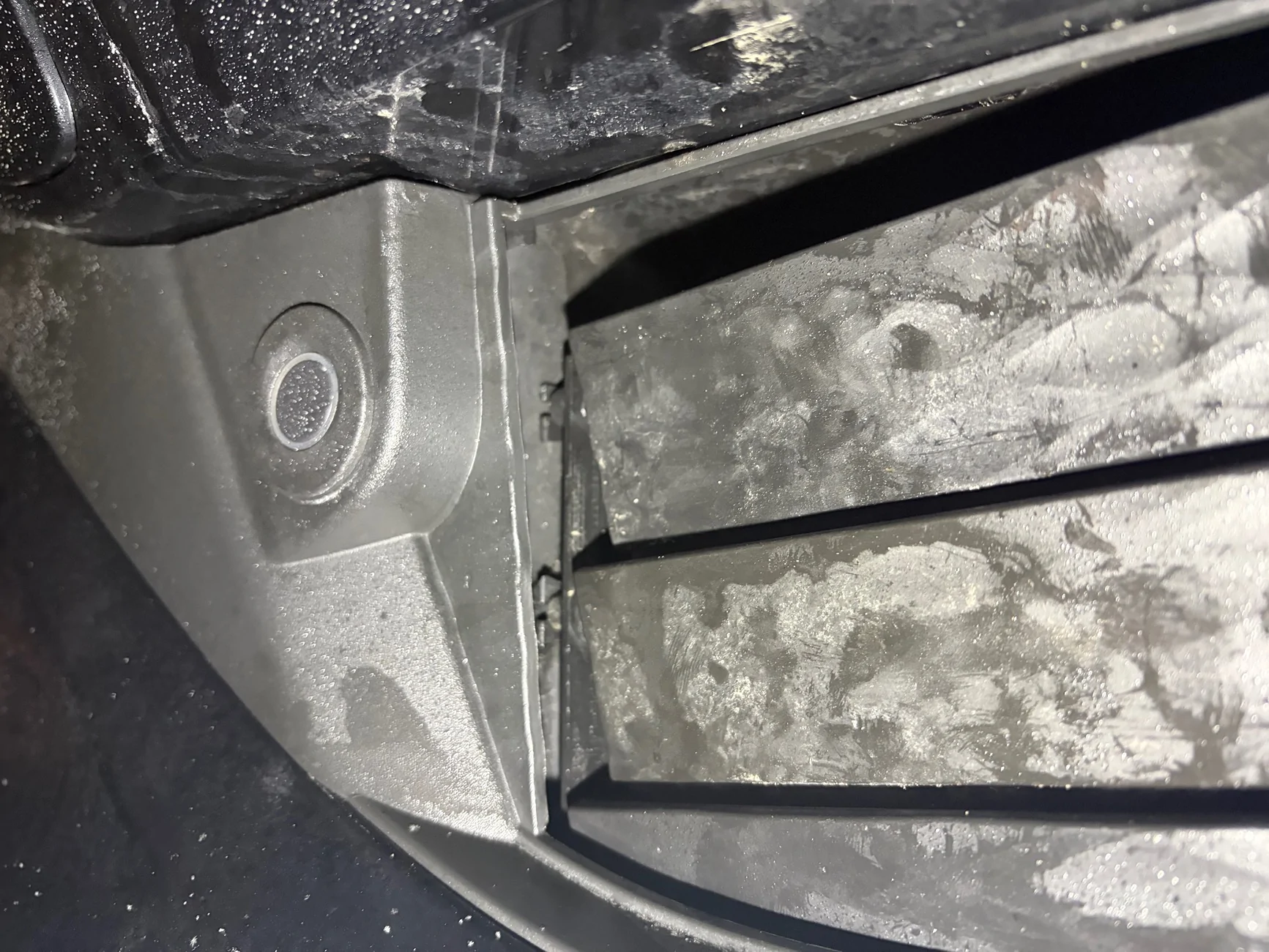

I have no idea how this could happen, but it was a snow storm and then a cold snap, and one of my louver shutter assemblies on the passenger side is broken now.
Looks like the inside mount broke while it was trying to open itself while there was ice buildup.
I have a few questions:
1. How bad is it to drive like this for a while, I see that the actuator still works and just does not sit right?
2. Do you think this may be covered under warranty as there is no obvious damage to anywhere around this area, the louver mount just cracked inside the bumper assembly most likely from the effort to open itself while having ice all over?
3. Is this more a job for a dealership or a body shop to deal with, as from the looks of it they may need to remove the bumper?
Thanks!

The louvers are covered by the 36 month / 36,000 mile warranty. If you hit nothing, and they break due to ice buildup, that's a warranty claim to me.

Update: My AD fixed everything under warranty, the whole panel was replaced along with the louvers. No more washing car in subzero temps.

If there’s a clear opening and louver is missing then it’s not advisable to drive around like this especially on highways, as debris off the road may hit and break radiator. In my case they just broke where the hinges are but were still standing and blocking the opening albeit a bit askew, so I drove like this for a week or so before the part arrived.
