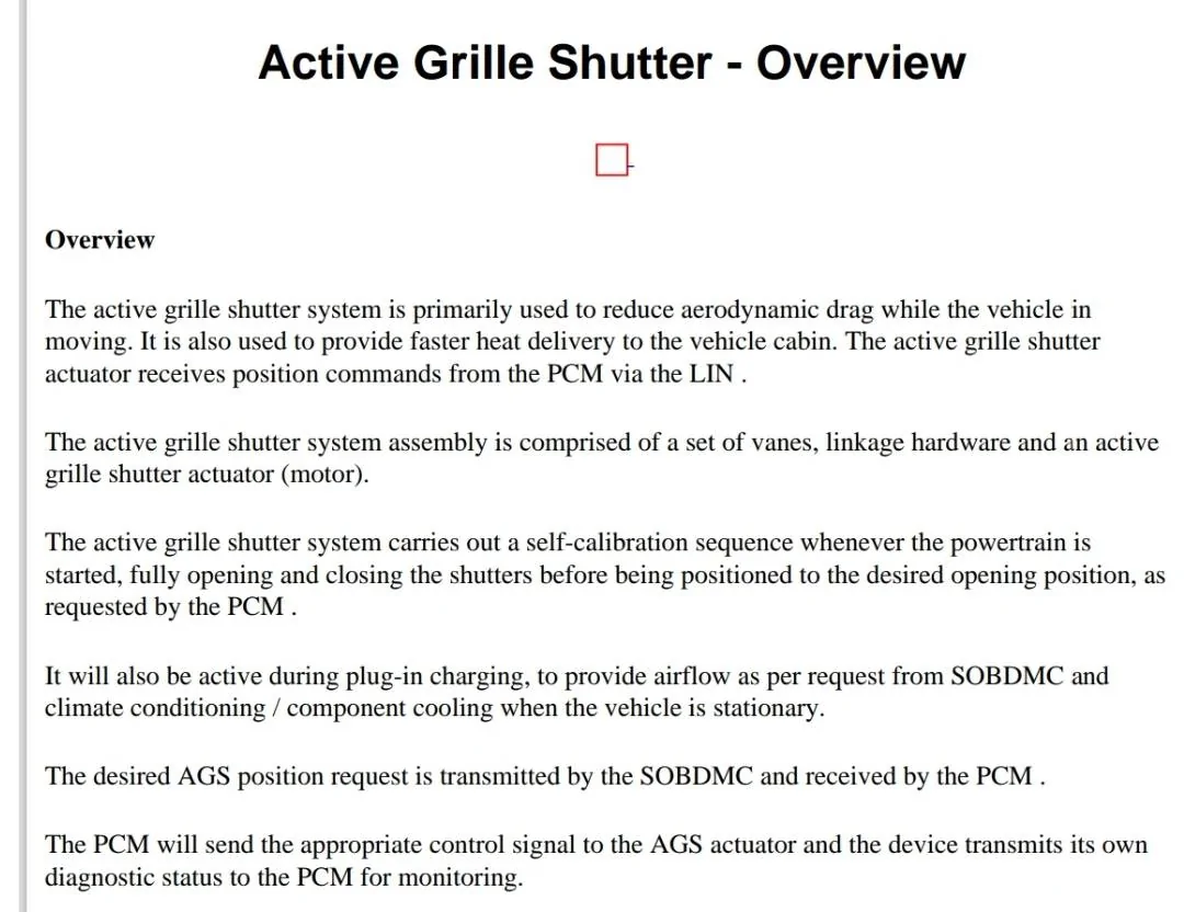

Before your car starts charging it will test the shutters to make sure they can open in case it needs to cool the HV battery. I'm fairly certain it will throw an error if it's unable to open them.

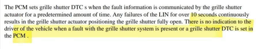

I'd be shocked to find that you don't have a soft code if/when the shutter mechanism malfunctions.

Haven't seen any error messages pop on the IPC. Not clear on what a soft code is. Would a soft code show if I connect to FORScan?
