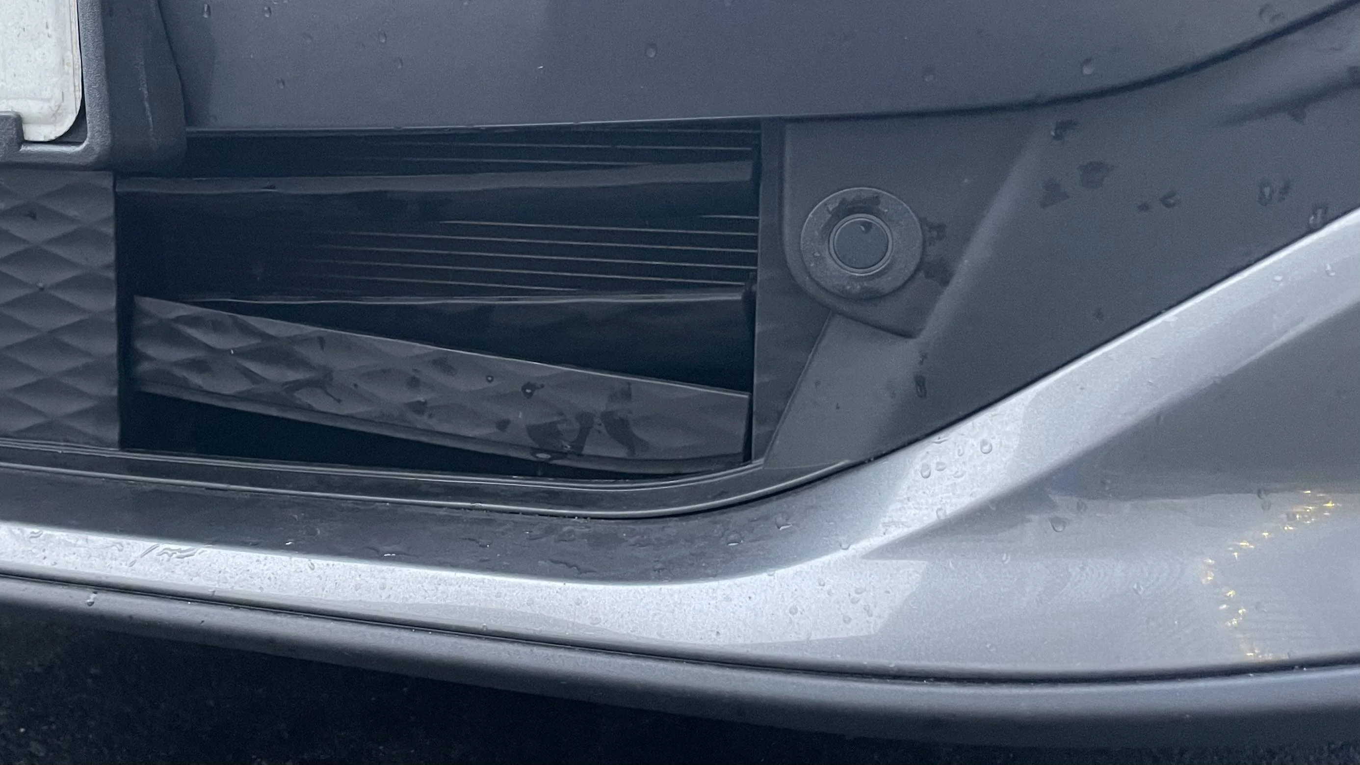

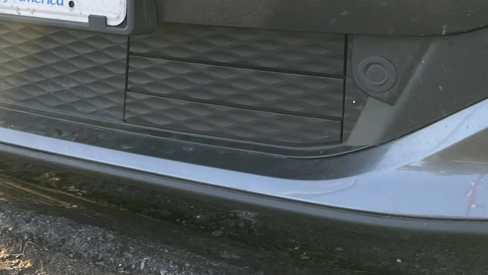

The black plastic section doesn't flex. It lists for ~$700. Requires hours of labor to remove lower lip, bumper, then black section and replace it. If fins break, but mechanism and mounting is intact, they can be replaced.
So today I was just sitting in front of the car. I’ve never really paid attention to that area, but do they actually open and close while you’re driving?
Ford Mustang Mach-E Control shutters on front Bumper broken IMG_7531
Sorry, posted that a little too early about those little doors. I saw the post so I went out there and plugged in for a second they work lol
Sorry I didn’t know I was at the end of the thread. I caught the part where it said plug into test them so I did sorry guys. Here’s my video.

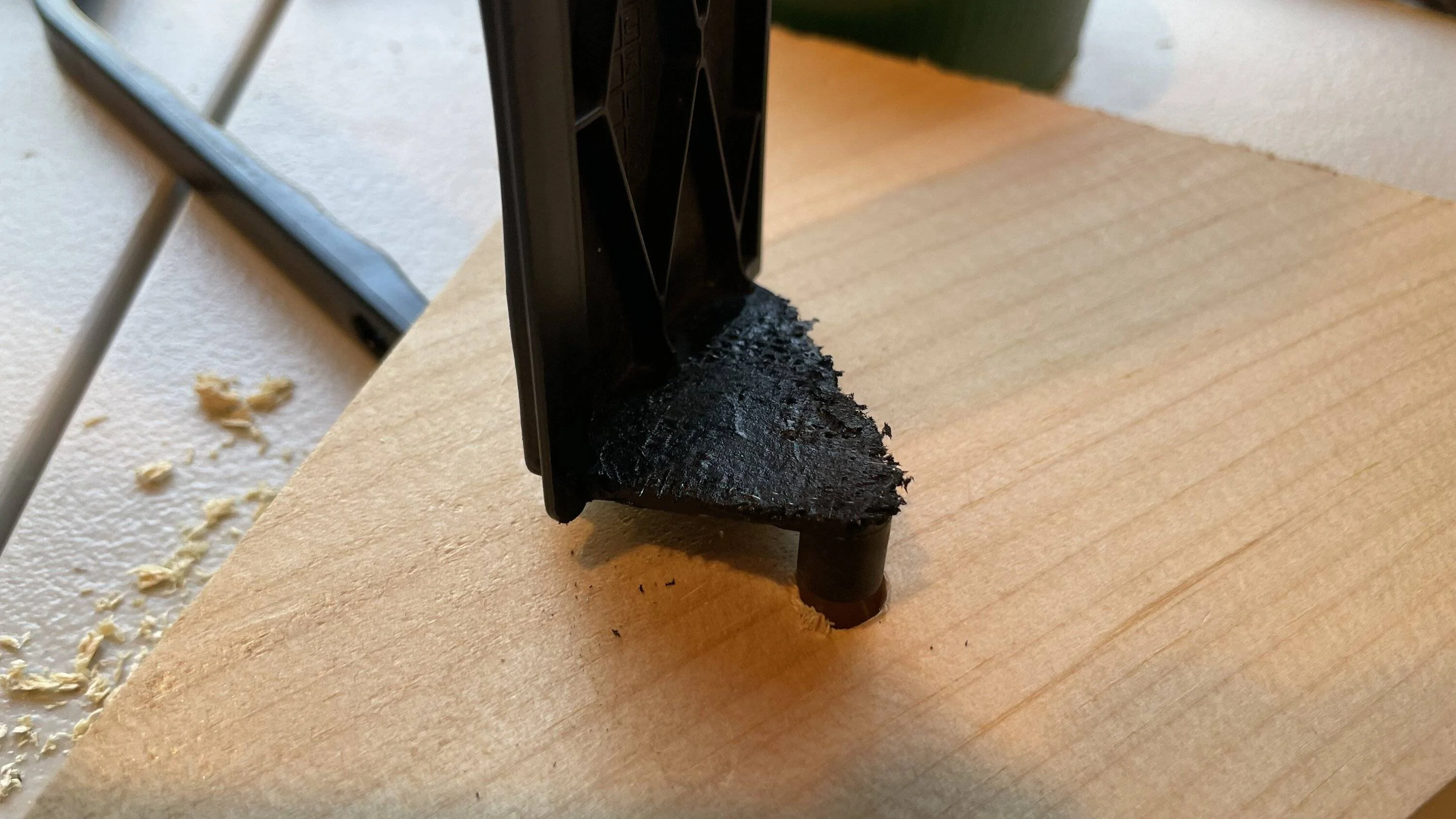

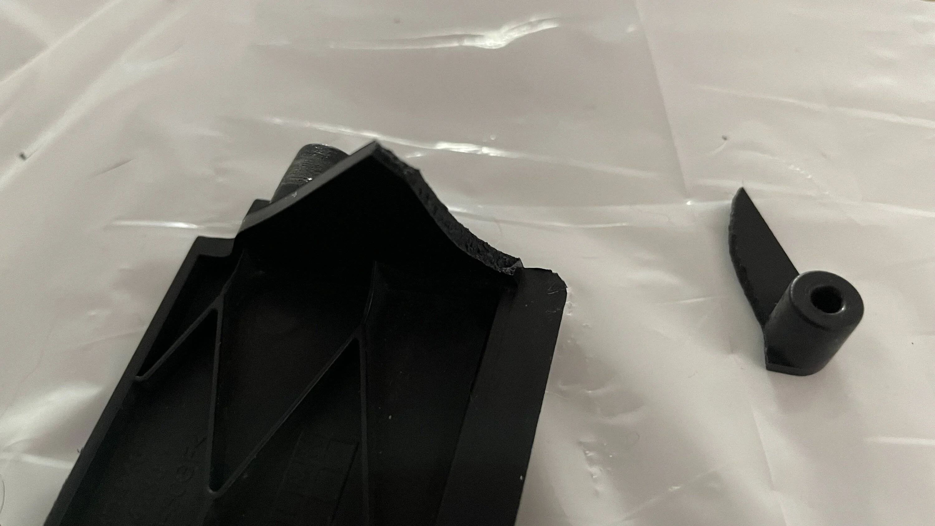

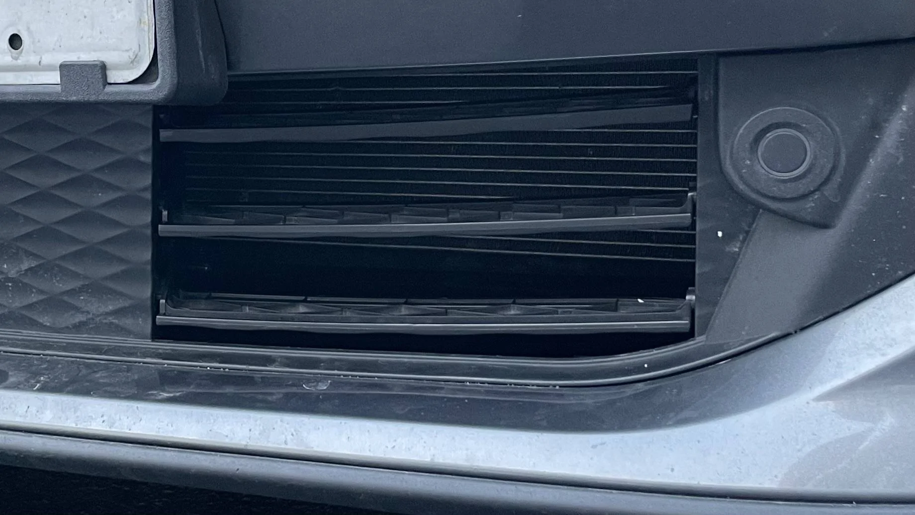

This happened to me - I have no idea how but my theory is that there was ice frozen to the shutters after a recent New England ice storm and it tried to open on being plugged in - cracking the top vane in the process and causing the whole assembly to fall apart.
Local dealer quoted me 1600 dollars to fix it - when all I needed was a new top LH vane. I think this is because Ford doesn’t list each vane as a part number - you have to buy the whole front grille shutter assembly and then they have to install it.
I considered 3D printing a new part, or buying the assembly on eBay (found one for under 300 bucks) but lucky me, I reached my arm inside the bumper and found the broken piece.

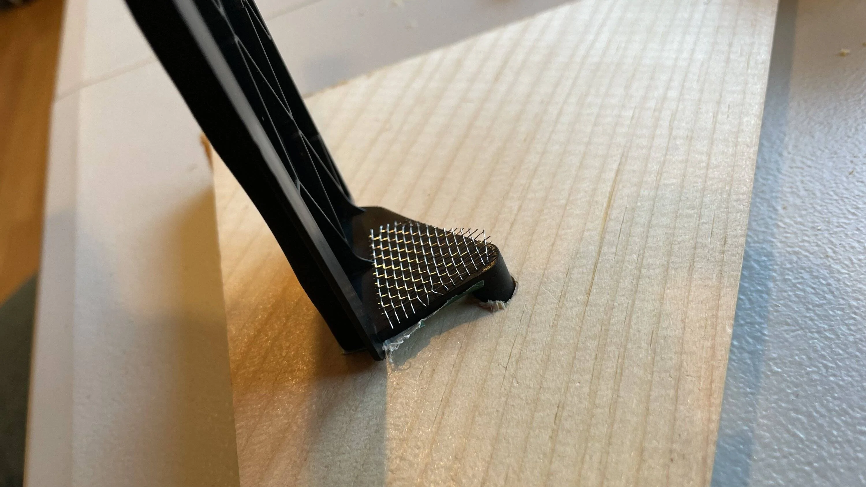

I researched plastic welding on YouTube and bought a plastic weld kit on Amazon.
My weld came out quite good - though I recommend doing this in a well ventilated place. Even with a nearby window open my house smelled like plastic.
I made a simple jig by drilling some holes in a block of wood to hold the pieces together, and cut a piece of wire to match the piece:
Then I melted the plastic with the weld tool:
After cleaning it up with some sandpaper, it was ready to reinstall. I was able to snap in the bottom vane, then the top, but to put the middle one back in I really needed to doors to open.
I had to take the car to a fast charger to get that to happen and stay open long enough for me to snap the middle vane back in.
All better - took it home and tested it by plugging in and watching the self test:
Problem solved - spent 40 bucks and learned a valuable skill instead of giving a dealer 1600 dollars.

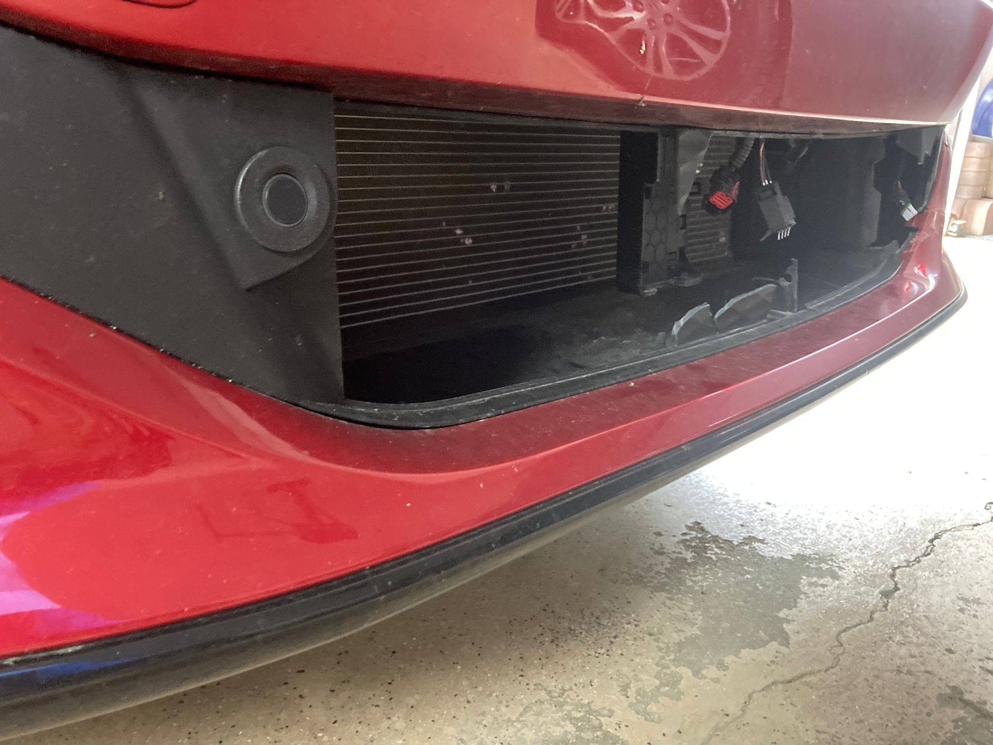

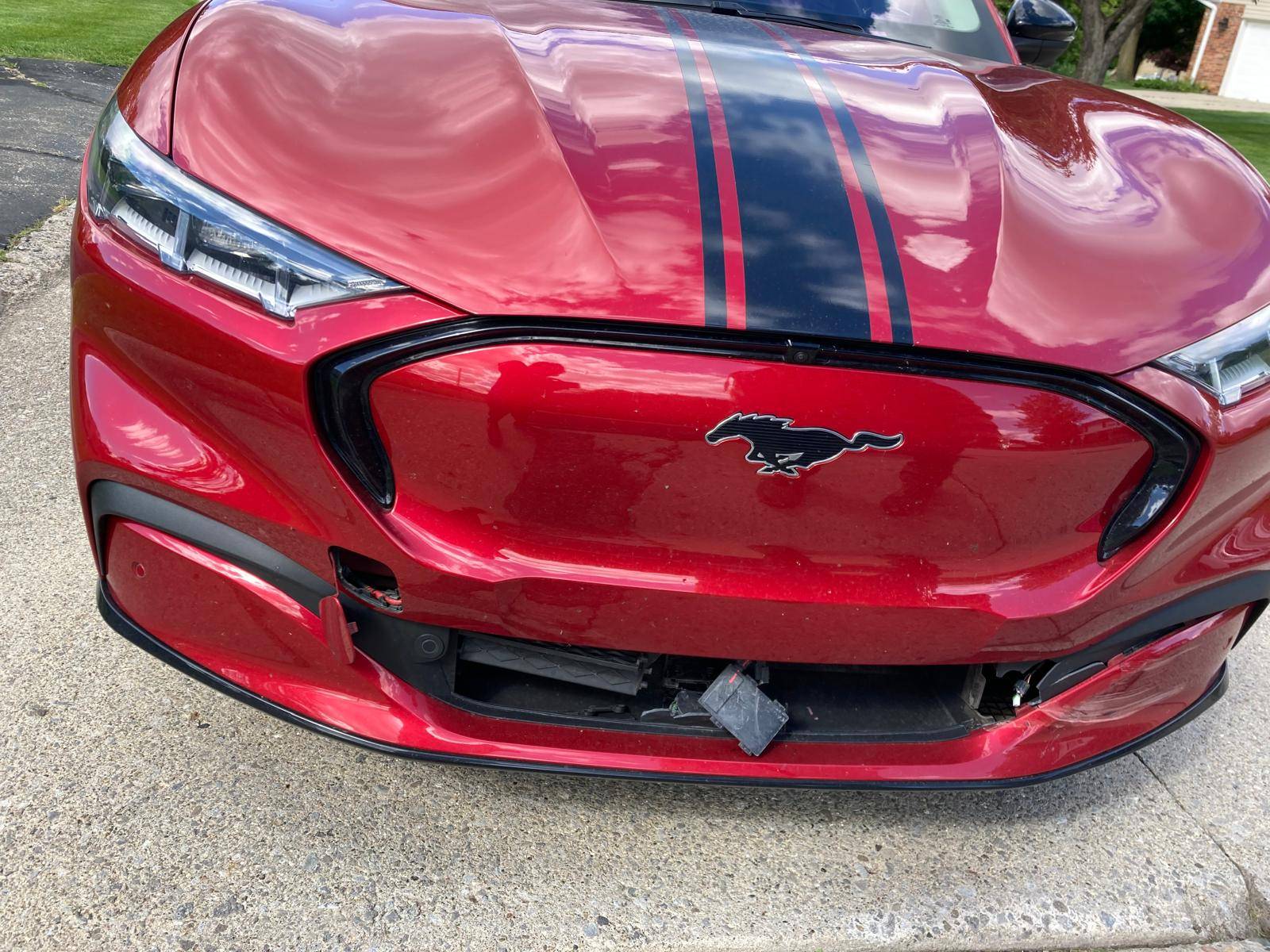

My MME had a small accident yesterday and the front shutters and sensors came off see the image.
Is it safe to drive like this on the road and in the rain or can it cause other damage? (the sensors wont work that is ok)

Cover the ends of the connectors so they don’t get wet. I would zip tie them up inside out of the way. Contamination or corrosion in those connectors will increase repair costs.
Cruise control won’t work because of the missing radar sensor. Unless you think you can snap the sensor back into the bracket.

How did the fins go in or out?
A bird flew into ours at speed, and now one fin is limp, and the other two don’t fully close.
I was hoping to pop them out to clean the area, then reinstall or replace, but I don’t see an obvious way to get them out with breaking them.
Hi - there’s actually enough flex to bend them enough to come out without breaking them. There’s nothing holding them into the actuators so if you flex them enough the little spindles on the ends will come out - just do one side first and then the other side can be pulled right out.
Getting it back in is the trick. I had to plug the car in and put the fin back while the doors were open.
