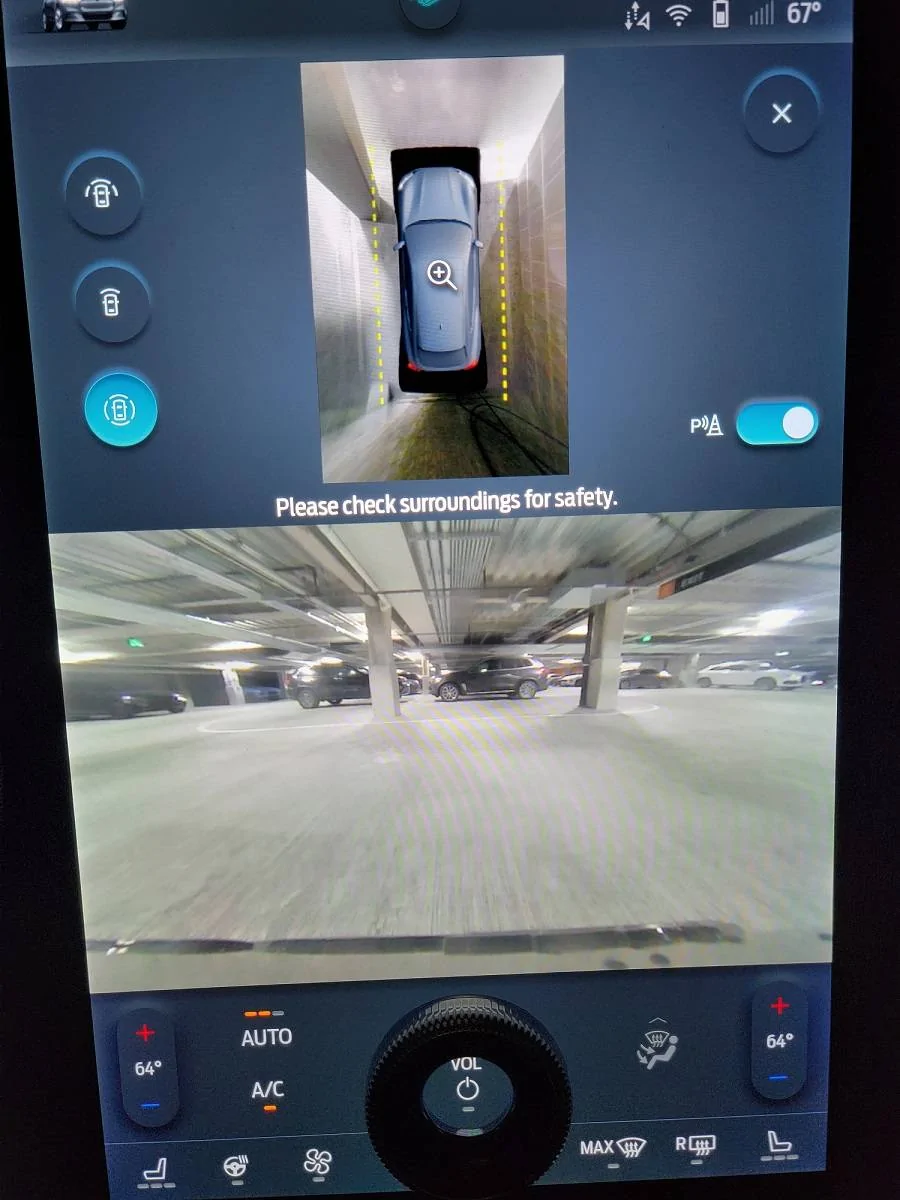

To add, I went and took a picture of mine. Op your car is fine and normal, don't worry about it.

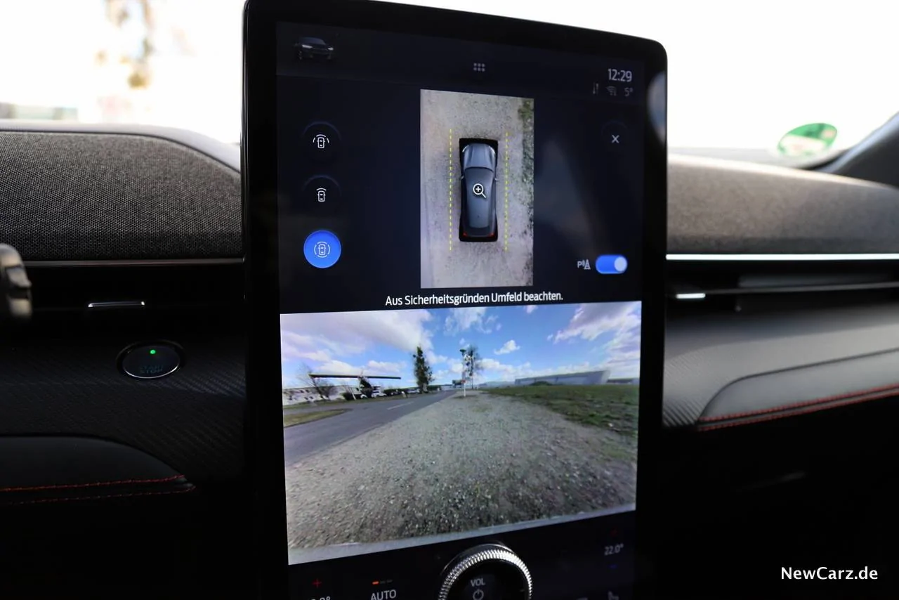

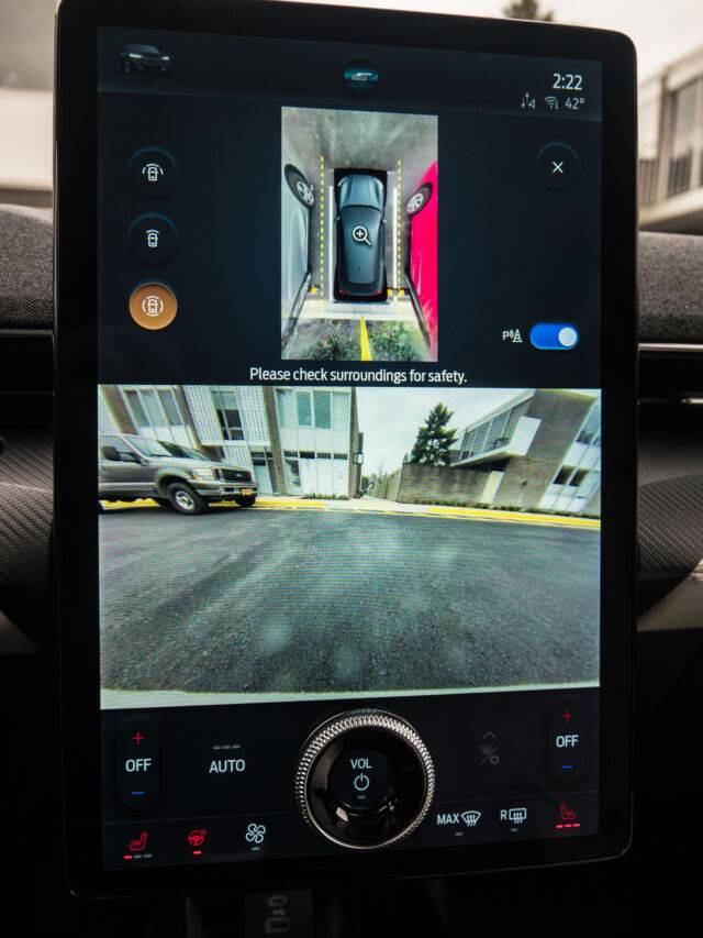

That's pretty much how it should look. You'll see the front bumper and some refections but it's not cropped weird like the OP's. There should be a solid view of your bumper at the bottom. Other examples (not sure if GT or not):

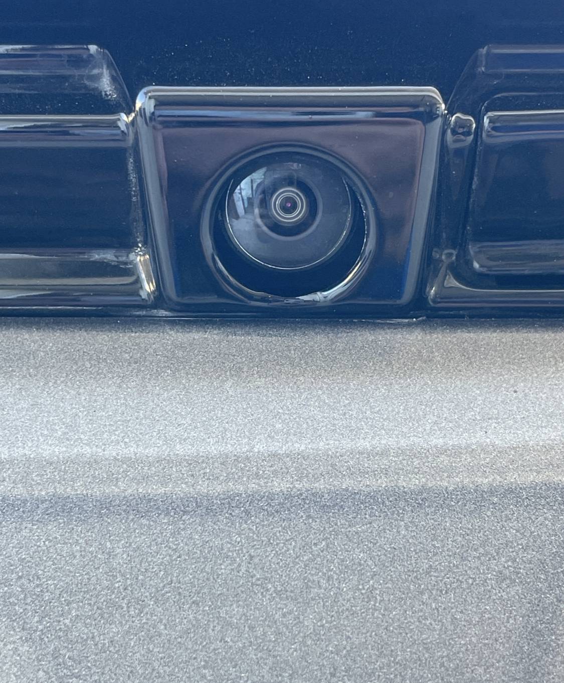

Anyone’s front camera too high up where it leaves a gap at the bottom?
