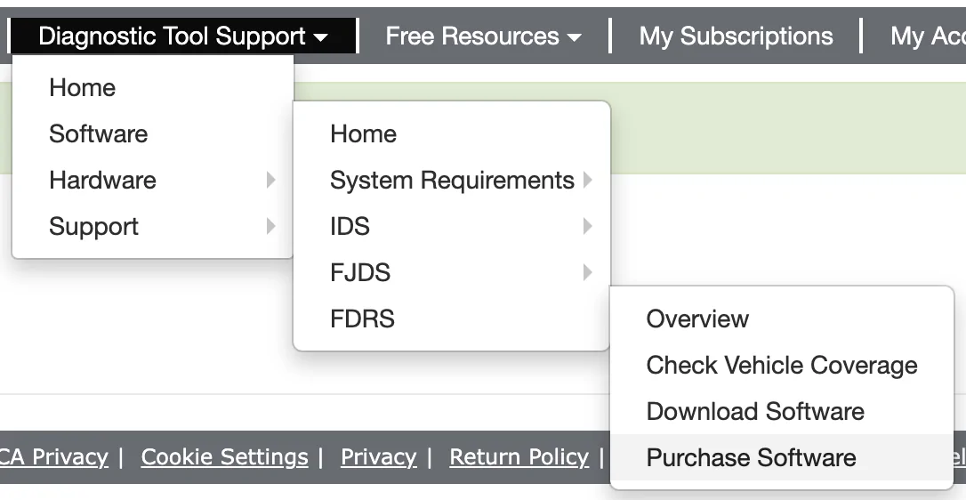

  1. Create a Motorcraft account
  2. Go to this menu

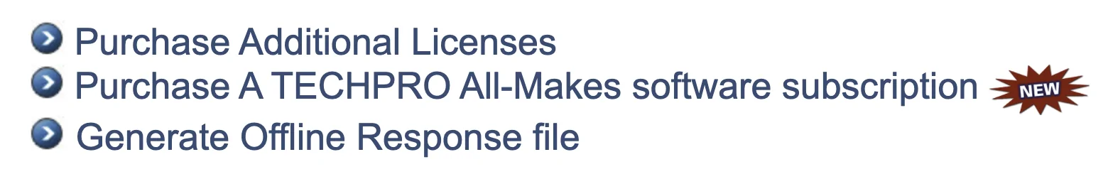

3. Once you click through you'll be prompted to log in again on a wonderfully 90s looking website.​

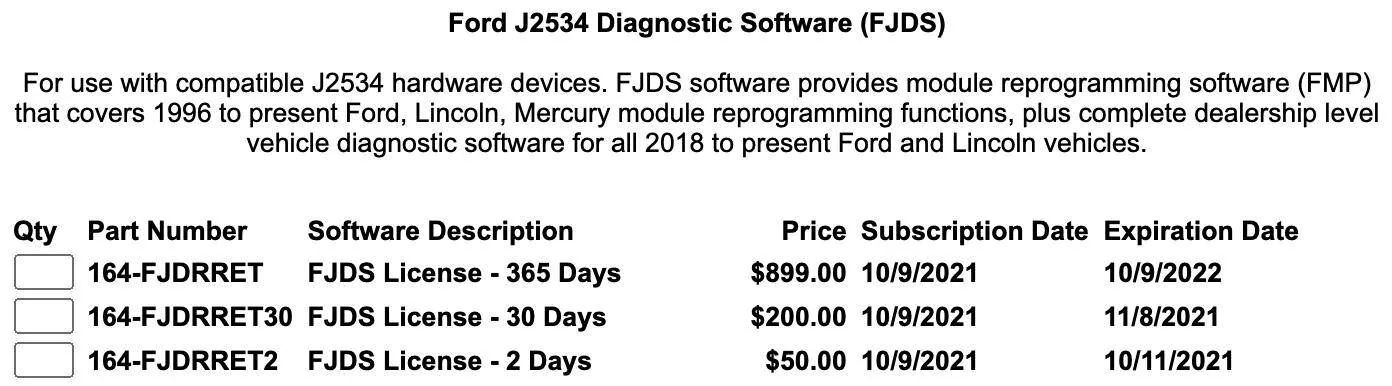

4. Click Purchase Additional Licenses (It may just say Purchase Licenses for you)​
5. Choose which subscription period you want. Note it says FJDS on here, not FDRS. Don't fret, this license is still the right one​
6. Once the purchase is complete it will take you to a download page with installation instructions.​

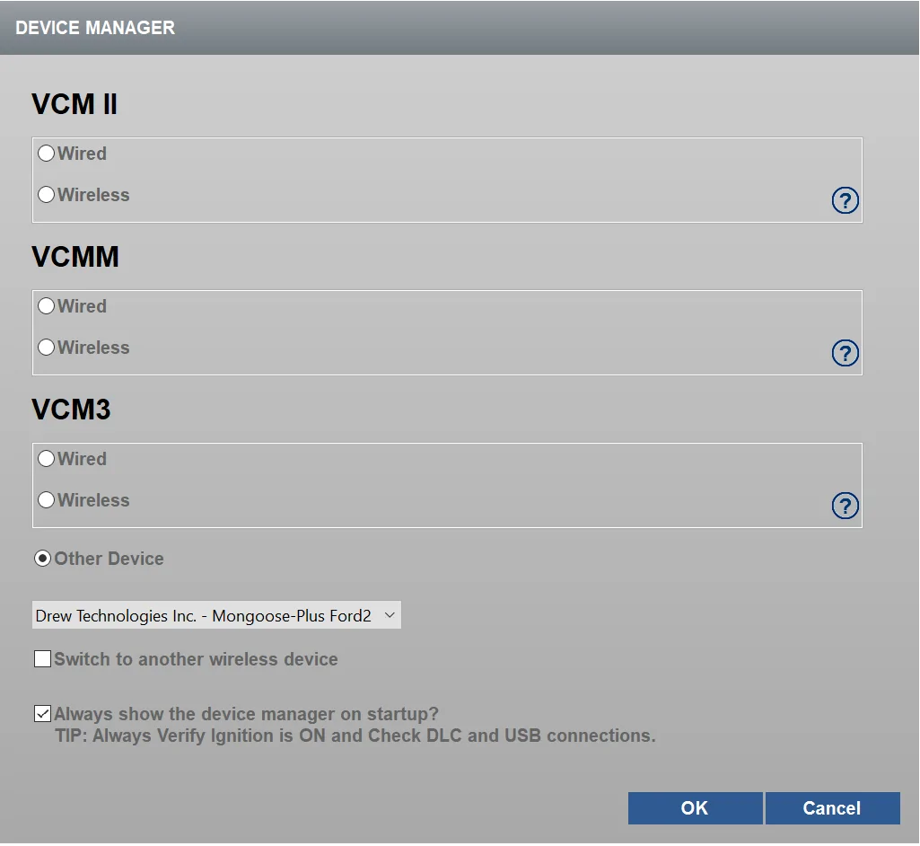

If you are using the mongoose adapter like me, make sure you visit their website, download, and install the driver before running FDRS.
  1. Plug in the adapter and turn on the car
  2. Open FDRS. Choose " Non-Dealer Motorcraft" and log in.
  3. It will then ask you how you are connecting to the car. If you're using the same adapter I did it should show up under "other device"

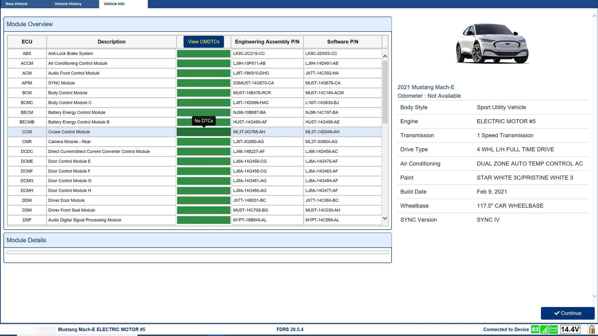

4. Hit "Read VIN from vehicle" and then "Go"​
5. After a few moments it will take you to the vehicle page. Click Continue​

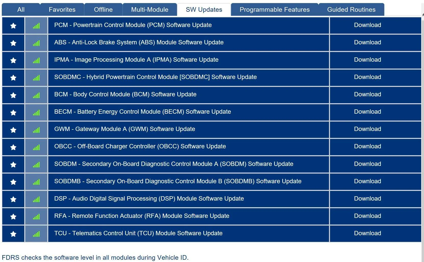

6. Go to the "SW Updates" tab and it will show you any modules that aren't up to date (mine had a lot). From here you can download and run them. The system does a great job of walking you through the process. If there are particular updates that have to happen in a specific order, FDRS will automatically take care of that and install all of them one after the other.​
How Updates Work
I unfortunately didn't take any screen shots of the update itself but there are 2 kinds of updates. One just runs straight from the laptop. The other requires the use of a USB flash drive that you plug into the SYNC system.

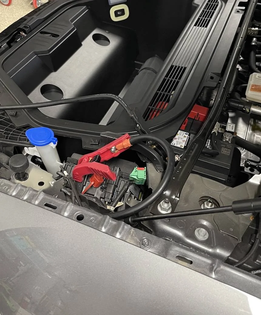

Thanks for the post, OP. When you connect your external power source, you can just hook onto the jump points, right? Or do you really need to connect to the 12V battery for some reason?
You connect to the jump points. The negative specifically needs a body ground, so the battery doesn't go into energy saver mode (I think that is what they called it).

  • Yes you can connect the aux power source to the jump points under the hood, not the battery directly. In my case I connected my 10A charger about 30 minutes early and let it bring the battery voltage up quite a bit before starting the updates. I’ve heard some updates cause the pumps to run, but in my case, none of the updates made the pumps run so there was very little voltage drop during updates.
