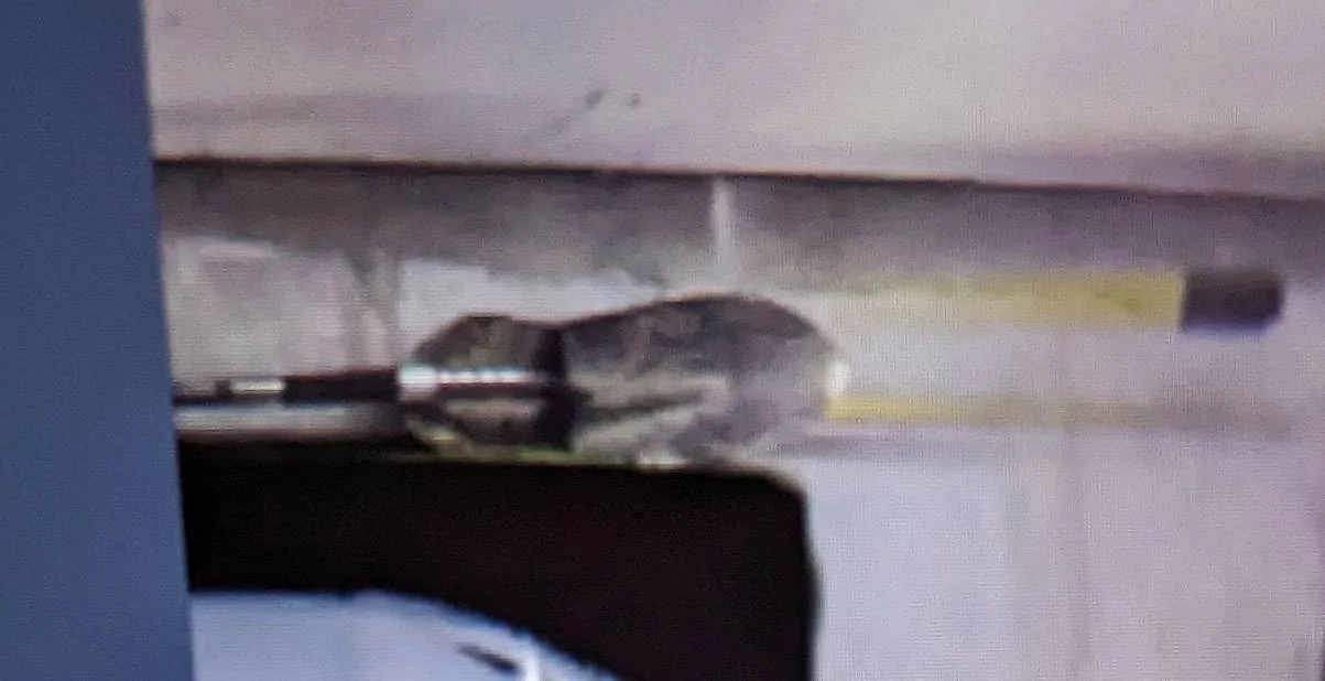

Here's a few pictures. I took two shovels and laid them in front of it, so you can see where the front camera thinks the handle is, and then where it blends into where the side/mirror camera thinks it is.

Crop of the top of the screen so you can see better:

Definitely not lined up.

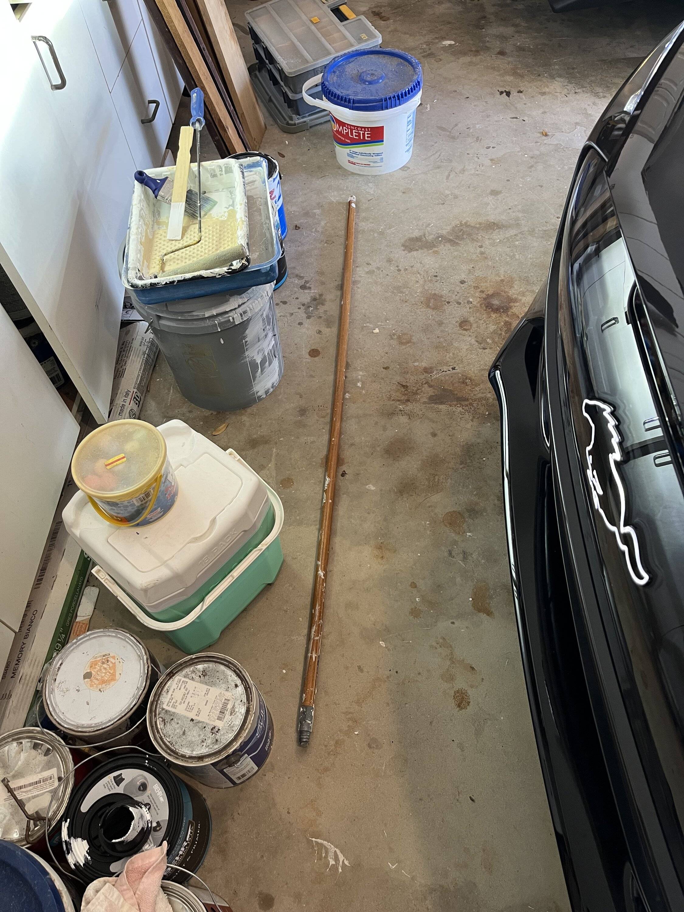

Just tested mine with a pole in front of the car. As you can see, no double vision:

That appears to be a problem with the image stitching between the cameras. Yes you'll need to do a 360Âş camera alignment to fix it, which can only be done with FDRS (dealer software). I've done it before, you want to drive around a flat empty parking lot with lots of good lines.

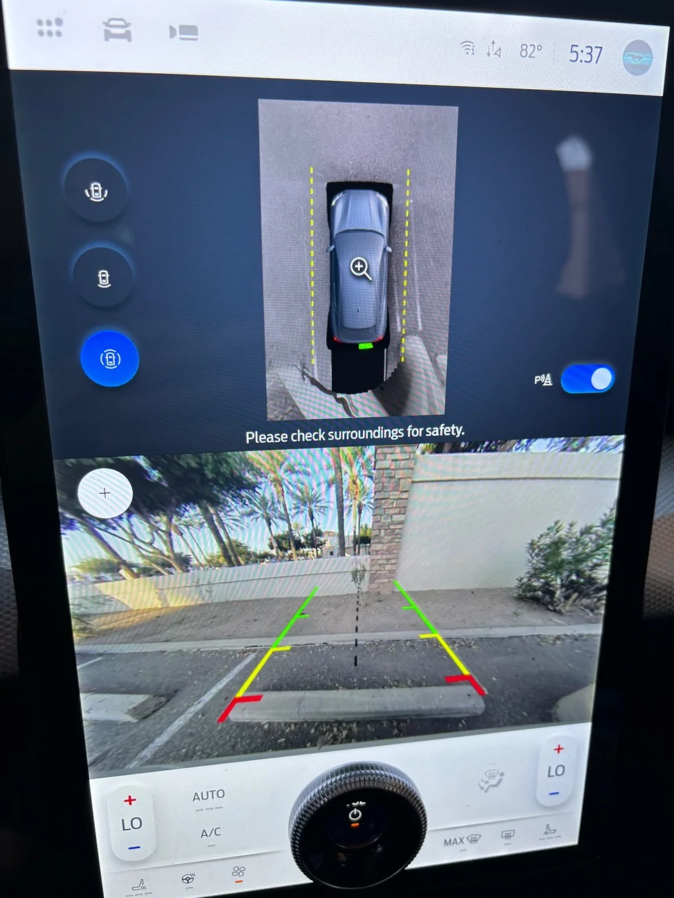

Am I having the same stitching problem like you which can only be fixed via software through ford? My car is out of regular warranty. Attached image showing rear camera
ForScan can do it, I have not tried it but you can search for people who've done it. You need an empty parking lot to roll through while you do it, it calibrates using the lines. I should get out and do it sometime....
