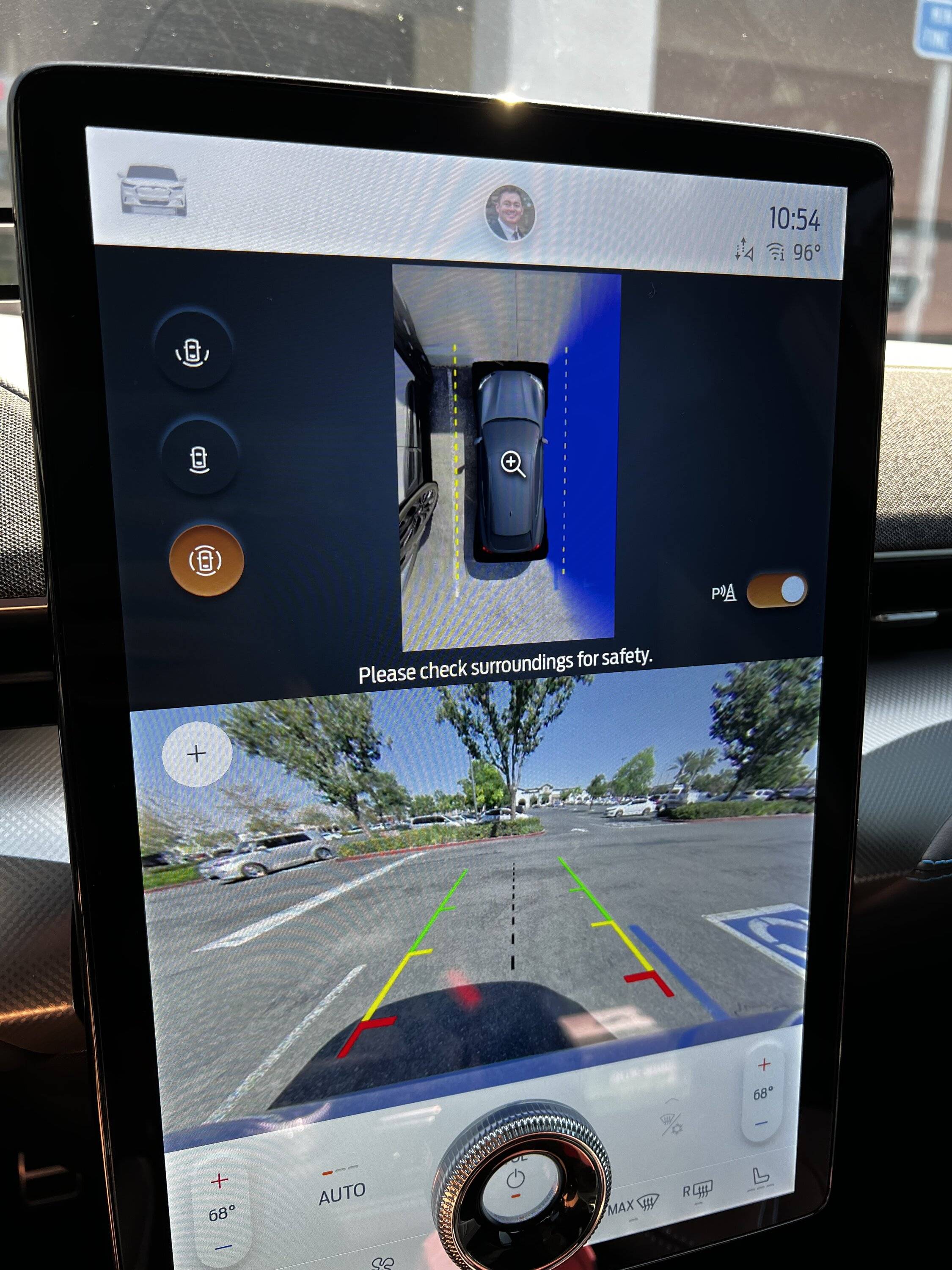

Has anyone seen this odd blur on the 360 camera? It cleared away after I restarted the car, but thought it was odd.

That means that camera isn't communicating. Could be the camera itself or the connection.

Also, all was fine after a car restart. Must be software related?
I'm not saying it isn't, but when I've seen the image do that it's usually a hardware problem.
Could just be picking up a weird Hue/Anomaly from the blue line and handicap parking spot to the right?
Could be! Thought it was weird. Plugged into FDRS and seeing CMR B15E2:97 stating Passenger Side LED obstructed or blocked. Weird

UV and blue light coatings on lenses to protect them diffract external rays into optical dispersive colors on lcds. It is not software or hardware. It is purely optics

So too much light on the LCD screen?

Thanks, which cameras are the culprit in this case? The cameras on the side view mirror?
Side mirror. The image is stitched together from 4 cameras. Only the passenger mirror is blue.
Ford had a problem back in 2019/20 across multiple vehicles for bad cameras resulting in a recall. That is what the screen displayed when the camera was bad.
Because it worked after a restart I would first check the connection, or have a dealer look at it.

I see what you mean now--after looking at the issue in the F-150's. Do you know where the connections are in the Mach-E's?
Under the right glare conditions outside the lens coatings on the external cameras can exhibit optical dispersion anomalies. They will always clear themselves up on movement or a screen refresh
Jes sayin. See it all the time in sunny ? glare filled az. Best Solutions to look away for a few seconds.
