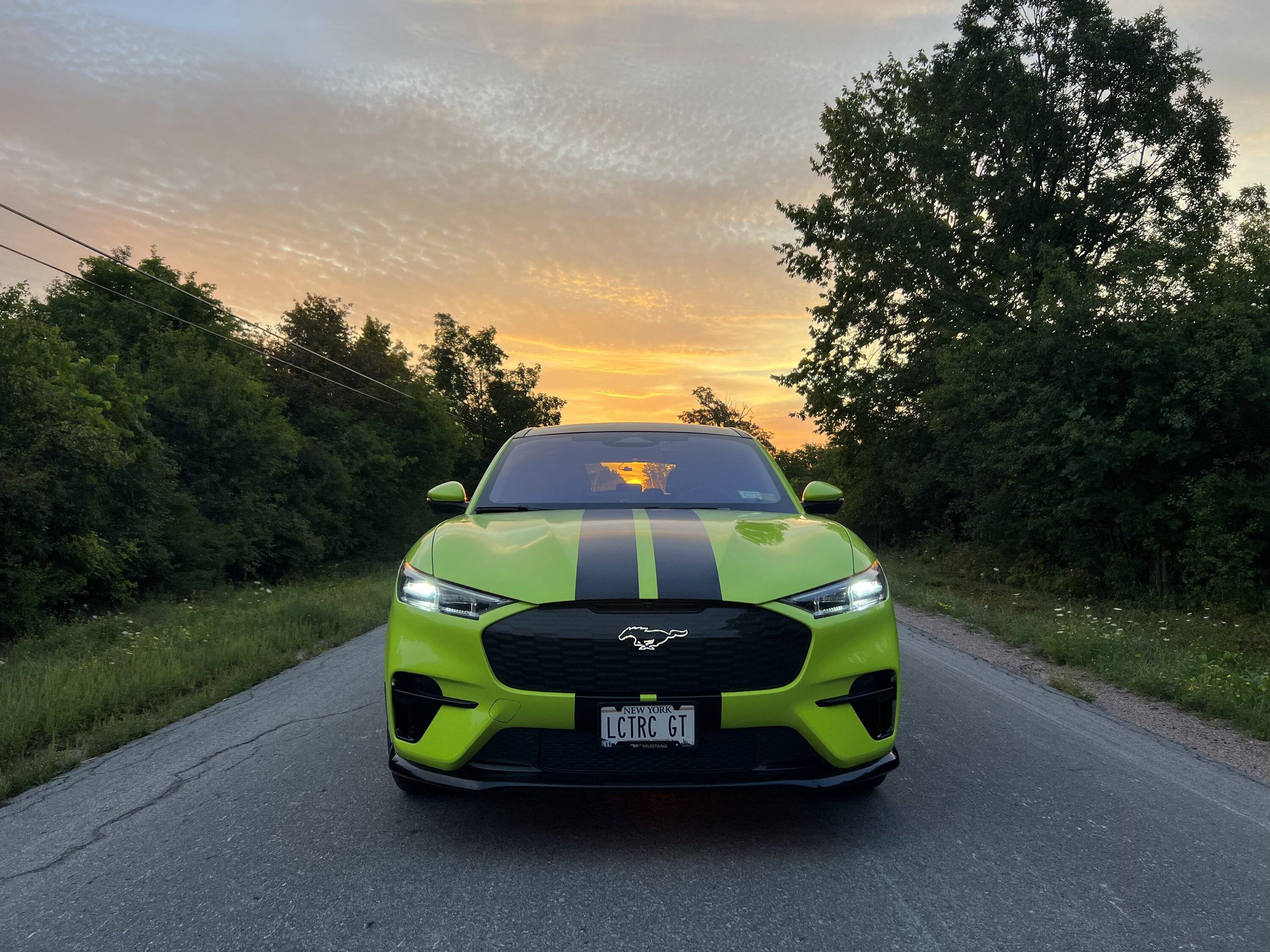

Many of us use Craig’s Bracket. Quite a few threads here about it. It can be made to work By making sure the plate is pressed all the way up against the car, rubber bumpers touching the nose. Also it could be your plate holder.

san
Sep 4, 2022
70
50
Texas, USA
2022 Mach-E GT; 2023 Mach-E Premium
Someone on another thread suggested this and I bought it and am using it on my craigs bracket without issues. It raises the plate just enough.

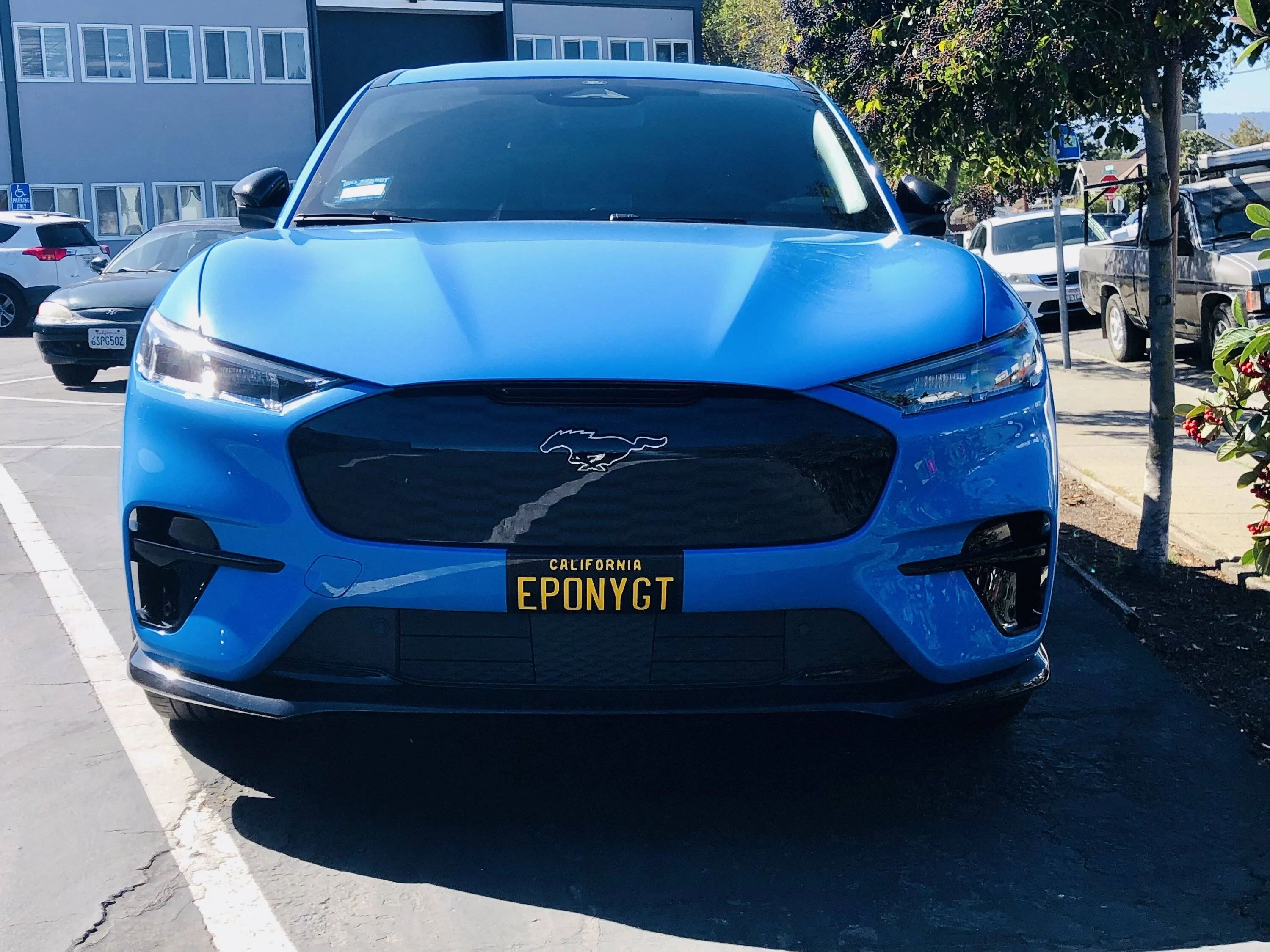

Retired Engineer
If you use this with the Craig’s bracket, you can raise the plates enough to avoid most false alarms. I use it and it works pretty well. (I’ve had maybe four false alarms in a few months of using the bracket in combo with Craig’s.)
FYI, I have a GT.
