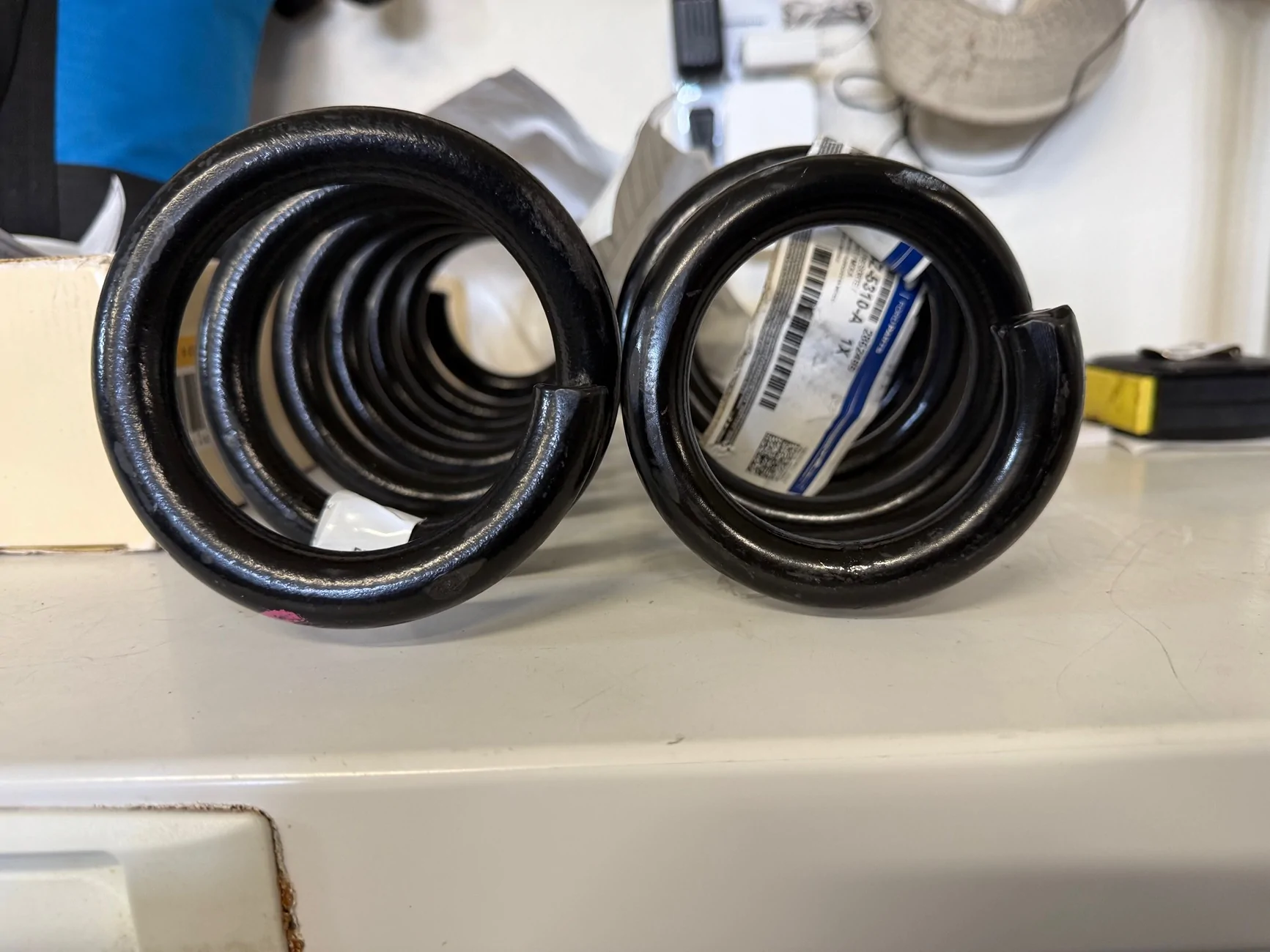

Thanks Mark. I have done a little more research and this morning I measured the springs and by just looking at them by the naked eye, one spring is bigger in diameter than the other one. Both springs have the same part number. So, one spring, the smaller one I guess, is missed labeled. I guess the tech grabbed one of the springs from my cargo area and it was the smaller one. Probably didn't think of looking at the other spring. Photo included. The online company that you use has the springs in stock, with at least a 7-day delivery. They have to get them from another warehouse. I also have to talk to the Ford Deanship in Petaluma regarding the springs. I bought them their because I used to work there.

Yes I’d say a very big difference and for sure the wrong spring. I guess you need just one more instead of two. Although I would measure the larger one and make sure it’s the same dimensions as I listed in that table.

They sent Fred the wrong springs twice. He finally got the correct springs and I installed them. If anyone else wants to make sure they got the correct Rally springs, the manufacturing number on the white tag on the front springs ends with the suffix "ABC" and the rear springs ends with "ABD".
