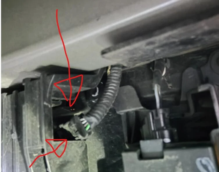

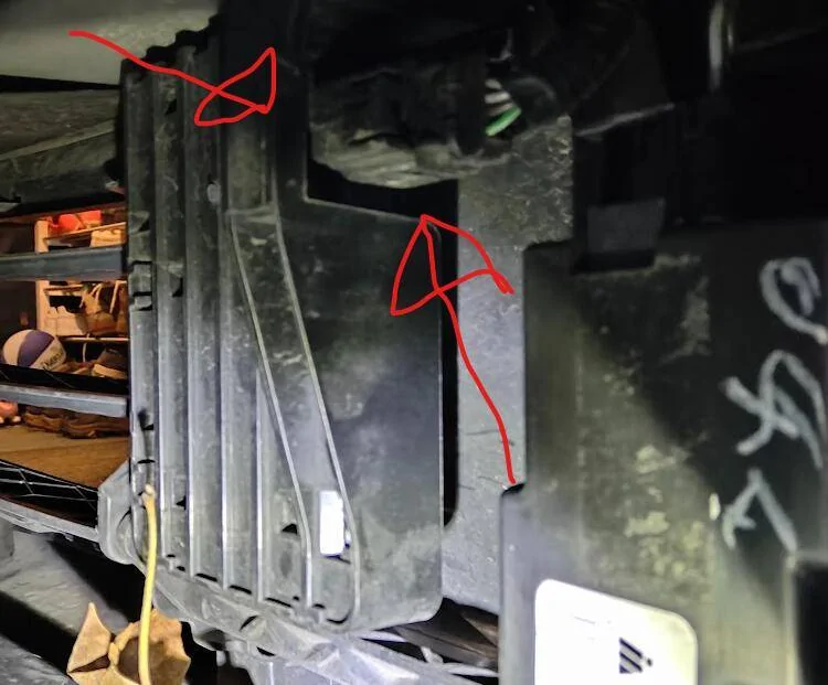

Phase one is complete, thanks to your input and the help of this diagram: https://parts.nplincoln.com/a/Ford_...-grille-Electrical-components/MT21045.html#13
The distance sensor clips into the back of the bracket (toward the back of the car, although the clip attaches forward). There is a gap between the bracket and the front trim that it attaches to, enough for my fingers to fit through easily and grab the sensor. It was loose, sitting down below it, but the bracket was still intact and in position so I was able to lift it up and press it back in. It clipped in securely and I wasn't able to pull it back out with moderate pressure, so it must have just jarred loose without breaking the clip [crosses fingers].
Before:
Ford Mustang Mach-E Front Sensor and Intake Shutter damage 1732982850843-2k
After:
Ford Mustang Mach-E Front Sensor and Intake Shutter damage 1732983005593-c1
Upon starting the car, the error was no longer present on the dash. Running the codes against the CCM module already, now, shows that the error is now archived and inactive (but still recorded historically).
Ford Mustang Mach-E Front Sensor and Intake Shutter damage 1732983043766-6o
Now I just need to fix the baffle/shutter/whatever, since it is winter.

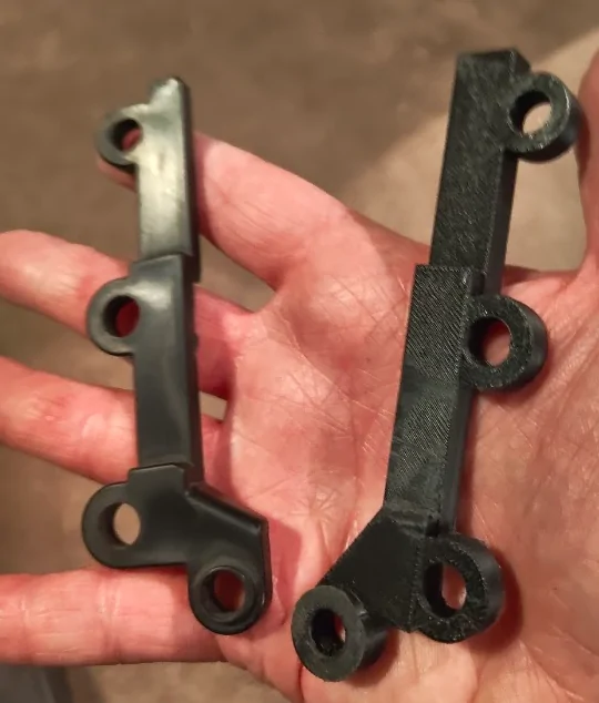

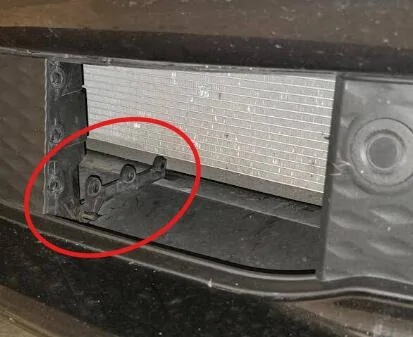

OK - I'm on to phase 2. I was foolish to not try to capture that little "shutter" arm you can see in my first photo as it has now disappeared. It's probably on a highway median somewhere in the Midwest. There are 3D print files for the shutters themselves, but I can't find any for the arm itself.
I don't want to have to buy the whole front assembly - @AOSK - do you happen to have that file, as well? Or anyone else?
For clarity - this little guy here:
Ford Mustang Mach-E Front Sensor and Intake Shutter damage 1746036312297-j8
mobrien118
mobrien118
Marty
Apr 1, 2022
47
41
Saint Louis, MO
2022 mach-e gt
I'm still looking for a 3d print template for this piece. I just got a 3d printer, and I'm ready to print the shutters, but they won't be much use without this piece. I might have to fabricate something myself, but I really don't want to try to to that...
Next step after *that* will be fixing the crack in the panel under the front lip... gradual progress.......

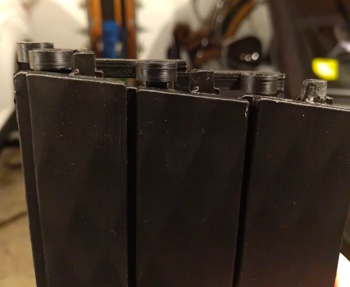

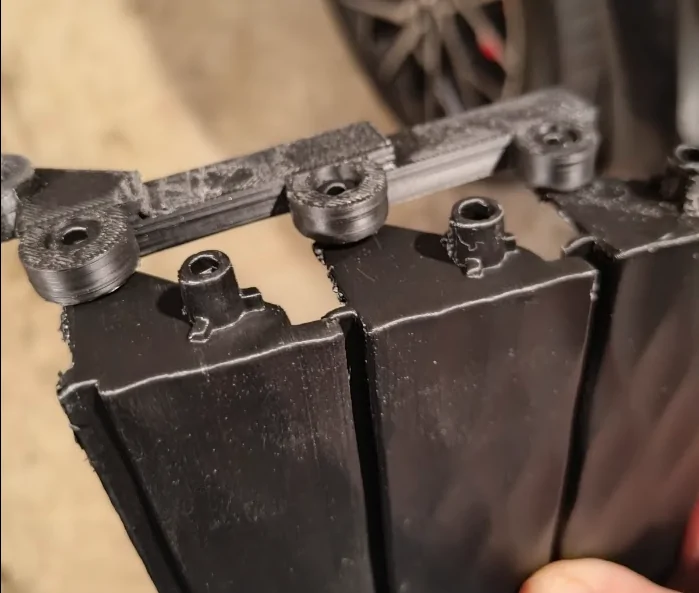

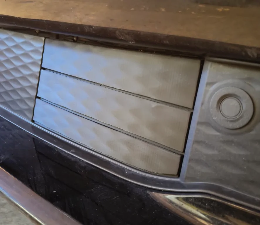

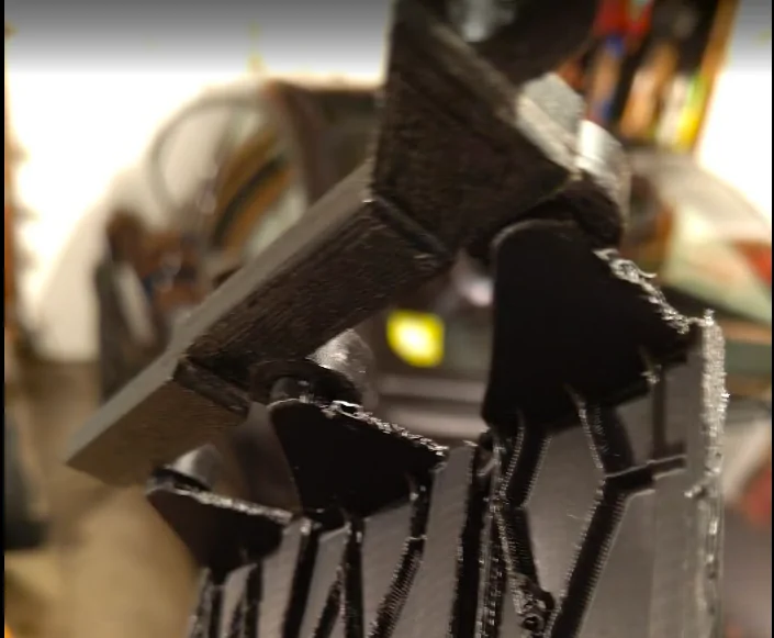

Whelp... Nobody had the 3d scan of this, and I really needed to get it back working...... so I bought a $15 micrometer off of Amazon and measured the one from the other side, then designed one that is sufficient. Since it isn't a visible part, even, really, when the shutters are open, there wasn't much need to make it "pretty."
I'm attaching the slt file here - feel free to use and/or modify to your hearts content. And I'll post some pictures of it next to its mirror (the one that wasn't broken). I printed it at 100% infill, since it isn't much filament anyway (I think 22g, with supports) and I would prefer this part to be fully strong.
Ford Mustang Mach-E Front Sensor and Intake Shutter damage 1769313358155-37
These are all 3d printed blades, too:
Ford Mustang Mach-E Front Sensor and Intake Shutter damage 1769313420954-ys
Ford Mustang Mach-E Front Sensor and Intake Shutter damage 1769313448404-qh
Ford Mustang Mach-E Front Sensor and Intake Shutter damage 1769313469499-91
And on the car:
Ford Mustang Mach-E Front Sensor and Intake Shutter damage 1769313585754-0
Ford Mustang Mach-E Front Sensor and Intake Shutter damage 1769313611123-2v
Ford Mustang Mach-E Front Sensor and Intake Shutter damage 1769313635375-wq

Really nice job on the shutter arm! Thanks for posting the stl. What filament did you use? What design software?
No problem, hope it helps others!
I had trouble getting ABS to produce quality parts in my printer (Bambu P1S), so this is just PLA. If (more like when) the shutters get weathered I'll get some black ASA and make the permanent version from that. I'm new to 3D printing so I've already learned things I would have done differently in the print.
I used TinkerCAD for the design. It is my first time using 3D design software, but it wasn't too difficult to get the hang of. I spent maybe an hour or two learning the software and designing the part altogether. I've already designed something else for a different project so I'm getting some mileage out of my self training!
SteveMach-ee
Nov 6, 2024
139
183
Mass
2021 MME Select AWD, 2023 Ariya Venture+
Yes, PLA might deform in summer heat and tend to be brittle in the winter. ABS usually looks better and survives temp extremes well but it's a PITA to get it not to warp. ABS warping is worse with 100% infill. PETG is pretty good at temp extremes, much stronger than PLA and is cheaper than ASA. I've never tried ASA. It sounds pretty sturdy.
TinkerCAD is really good and simple to use. I've been using Fusion360 for years for 3D printing and CNC designs. It is free for hobbyists but has a steep learning curve. I had to watch a lot of YouTube videos 😆.
mobrien118
mobrien118
Marty
Apr 1, 2022
47
41
Saint Louis, MO
2022 mach-e gt
One of my PLA shutters already broke near the arm mount, so I bought some ASA (Polymaker Black, maybe should have chosen "Jet Black"...?) and re-printed it, but I didn't stop there! I redesigned the shutters to be better optimized for a 3D printer (as opposed to injection molding, like the factory parts) and posted the models, along with the rotating arms, out on Maker World. You can find them here, if you're interested: https://makerworld.com/en/models/2384553-mustang-mach-e-shutter-grill-all-6-rotating-arms
It may not be the most elegant solution, but I just built up rectangles and triangles on the backs of the shutters to remove the need for supports on the back of the shutter when printing, as well as (probably) make them stronger as a 3D print with 15% infill...? I printed the top one in ASA (on P1S with enclosure pre-heated) with no issues and went ahead and designed the other ones (lefts are just mirrors of rights) and included the arm(s) (again, just a mirror) in the model. I'm sure ABS and PETG will also work well, but I think ASA is probably ideal and it turned out great - check it out in the images in the posted model.
In a future model, I might add some structure to the arm portion of these where my one shutter broke, but we'll see how these ones hold up first. All in, I've probably spent as much in time, filament and other resources that I could have just bought the Ford assembly off of eBay, but where's the fun in that?

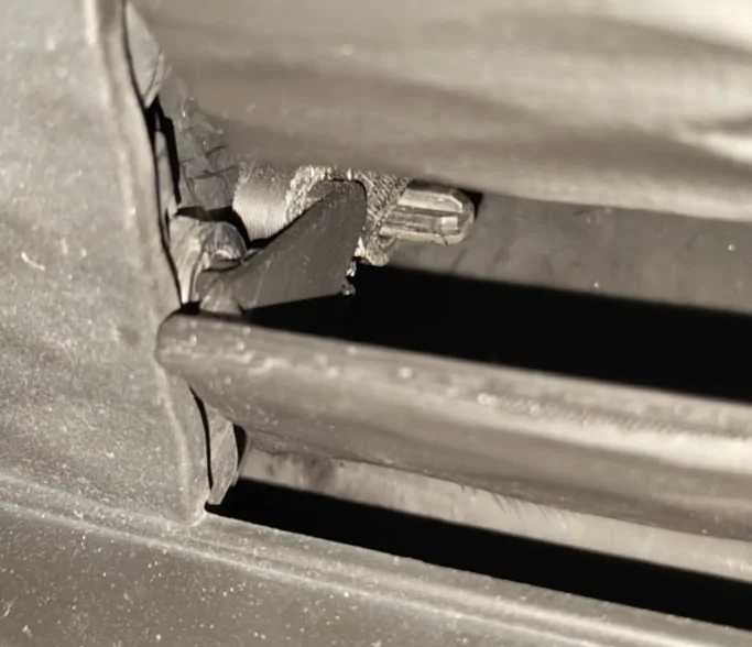

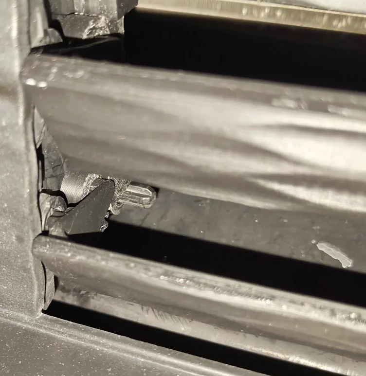

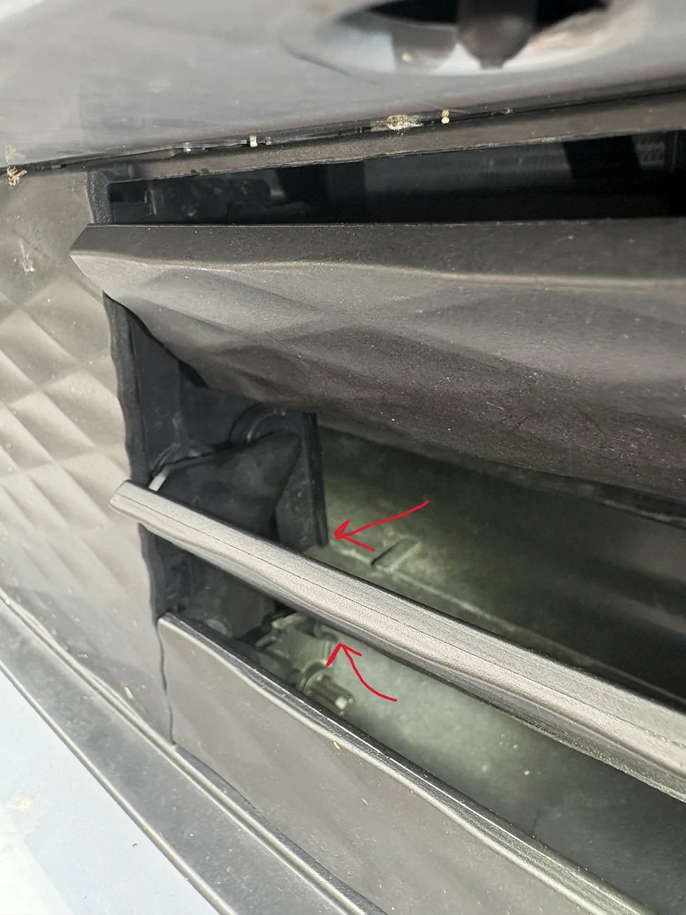

First time poster here, I think I'm re-asking some questions that have been stated in various other posts so please bear with me...
I too have suffered damage to the shutter assembly. However, the louvers in the front are not damaged, just the shutter arm behind them is broken (I tried to attach a photo). Took it to the dealer, they said this is clearly from an impact and therefor not covered under warranty. I think that's debatable, I'm not sure how an impact broke the linkage without damaging the louvers themselves, but i'm on the losing side of that argument. So, with that said...
1. How do I get the 3 louvers off in order to replace the linkage arm? I've tried bending them to take them out but it seems like they'll snap before they pop loose. any suggestions?
2. What material should I use to print the linkage arm? I have a buddy with a printer, just not sure what filament to use
3. does anyone know if they linkage arm dimensions are the same on GT models and others? Mine is a 2025 Premium, I believe you modeled the replacement after a 2022 GT
4. is there any particular order to install all of this? i assume the linkage arm needs to go in first, attaching to the actuator/motor? and then re-bend each of the 3 louvers to connect to the linkage arm?
Have you had any issues with your linkage arm since you originally installed?
Ford Mustang Mach-E Front Sensor and Intake Shutter damage broken linkag
