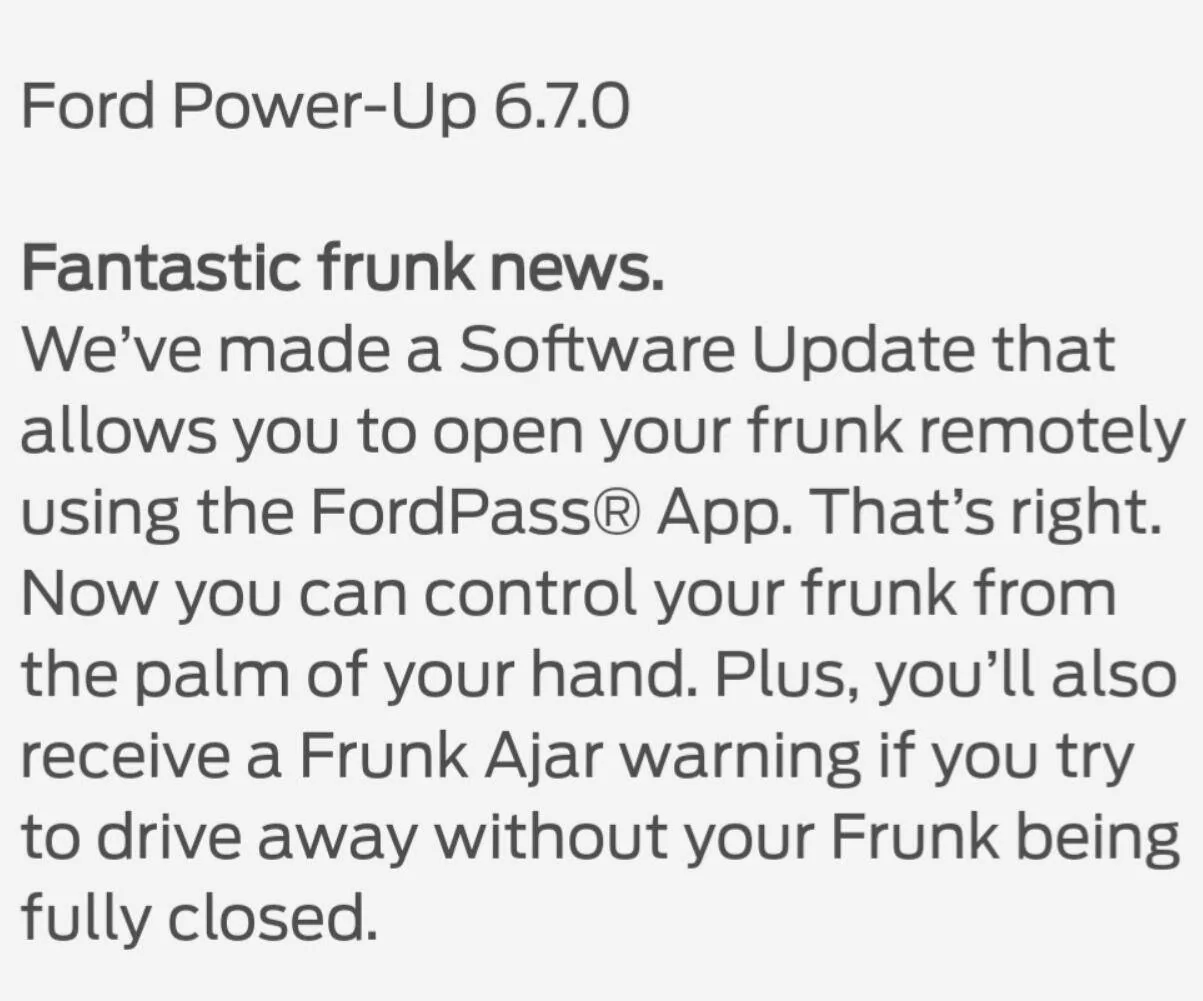

I got this Nothing Burger update last weekend. Has anyone seen a change?
My Mustang has always been able to open the frunk with the app via Bluetooth, which sucks because you have to be within 15 feet of the car to get it to work.
I was hoping this was going to allow us to actually use the function remotely in a manner similar to starting the car, but I haven't seen this yet.
Is there an update to FordPass that makes this new function work? Or is this taking credit for a "NEW" function when we've always had that function?

It's a mix of reusing release notes across model years, some MY21 didn't have even bluetooth frunk yet before this update.
Highly unlikely there will be a remote frunk option outside of bluetooth range, probably for safety/security reasons, since it's not a power frunk that can be closed remotely after opening.

Yes, I understand. Hyping up that a few users may get new functionality. They should say "We've made a Software Update that allows some Mustang owners...."
They SHOULD have had enough targeting to customize the message to explain what I was getting, which was nothing.

It’s going to work like a fob so you have to be within range. Same as the trunk.
