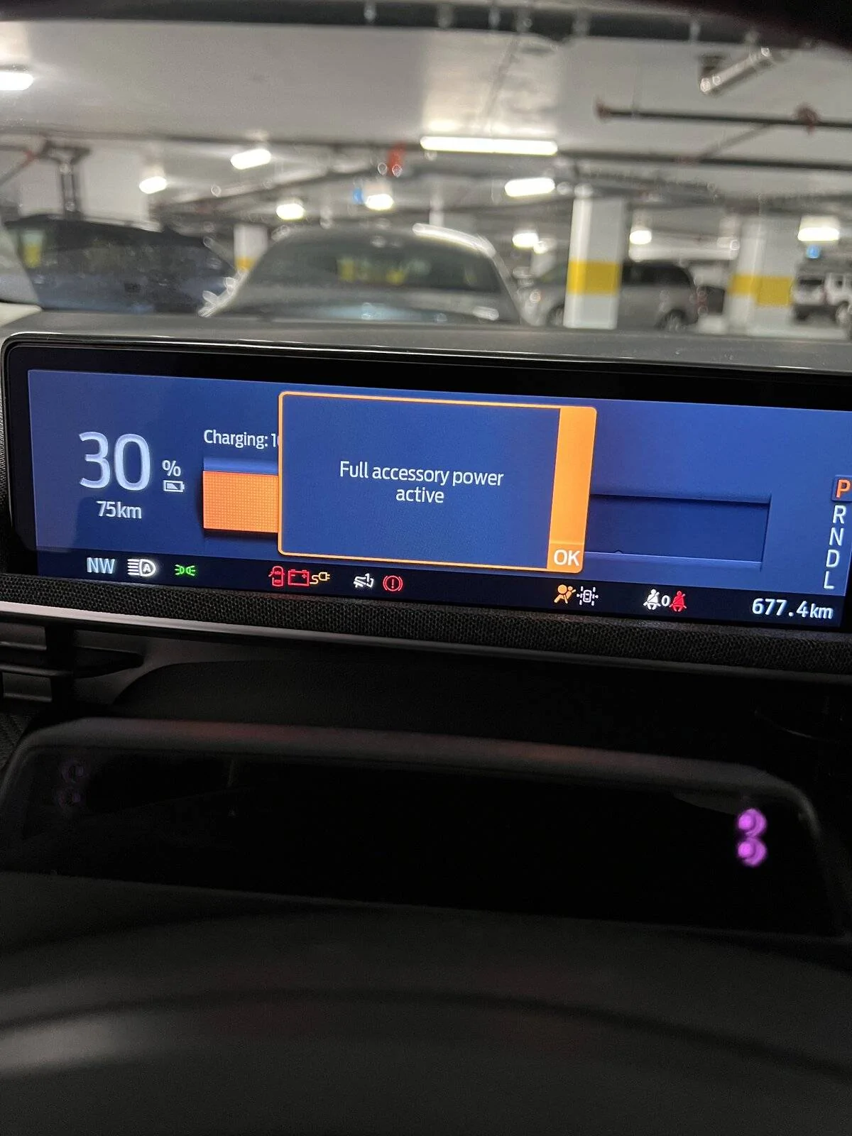

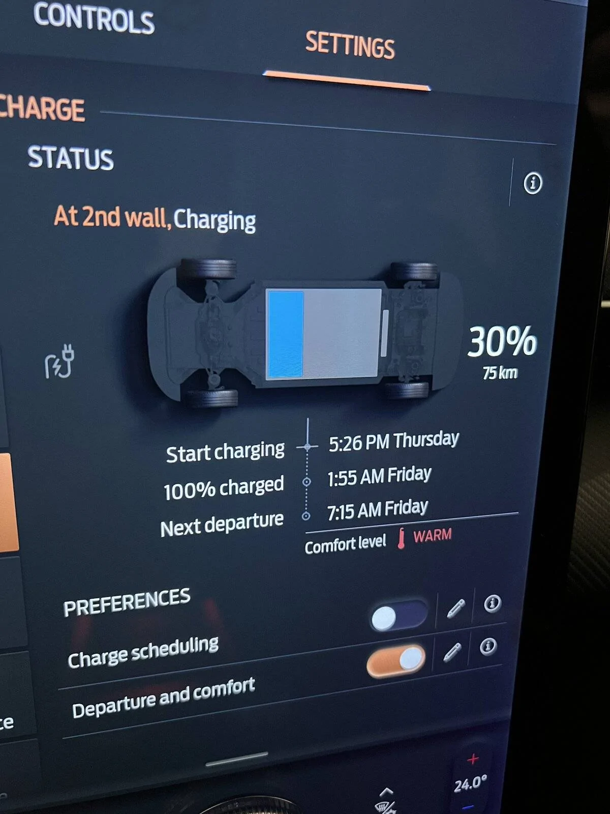

Hi Mache owners,
I’m seeing the attached messages on my dash board when charging in my parking lot. One says full accessory power on and when I go into charge under vehicle, it says charge comfort level warm.
should I be paying attention to these messages at all? I’m more concerned of safety issue.

You have programmed your vehicle while charging to include warming your interior to the "Warm" setting. Look at your "Departure and comfort" setting it's clicked on! Very normal if you have this setting in place. Has nothing to do with the charging of the batteries being in a warm state.....no worries!

Sounds like your car is on. Is the start button blinking? Press the start button once without your foot on the brake, should turn it off.

Those are actually two different messages. First message on the driver's display means you are in accessory mode. Very normal.
The charging screen on the center display says you started charging around 5:30 and expect to reach 100% around 2 am. Then it looks like you have a Departure Time set for 7:15 am and it will heat the cabin to the warm setting. Not sure about your car but in my car "Warm' is pizza oven temp.

Thanks! My "Warm" is not that hot but the heated seats turn on max and also the steering wheel. The cabin temperature seems to be around 26 Celsius.

Are the seats on when this picture was taken? If so you could be draining the 12 volt battery.
Ryanh99
Ryan
Sep 29, 2021
Vancouver
2021 Mustang Mach-E Premium AWD Standard Range
By seats on do you mean the heating?

Yes, heated seats.
