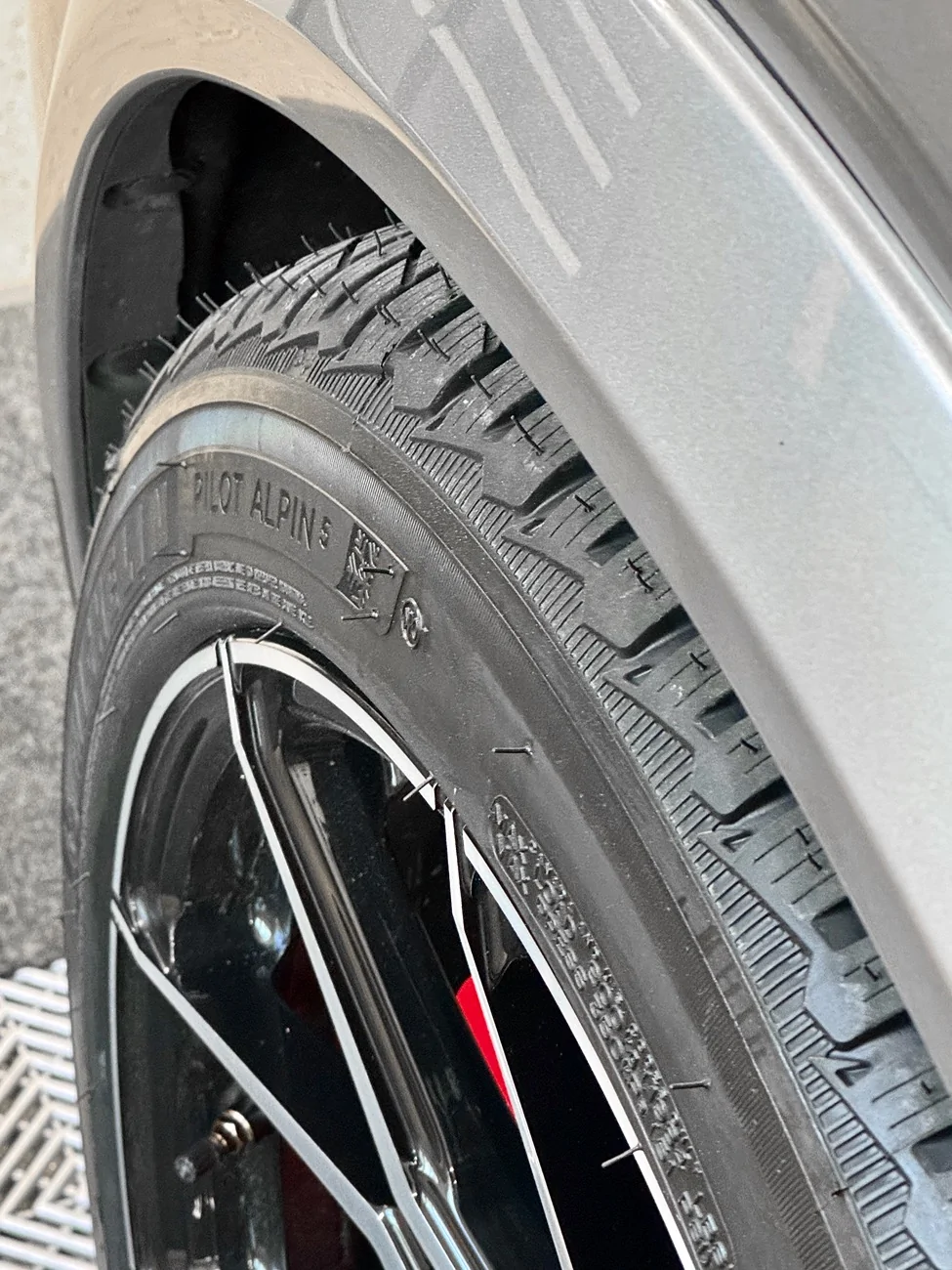

I do not see 255 wide tires being even a little stretched on 9” rims. Now if the rim was 9.5”, then yes.
245 width on 9” it does have that look slightly, and you don’t even get any rim protection.
Atomic wheels are pretty nice wheels, so I can’t imagine anyone going wrong with it.

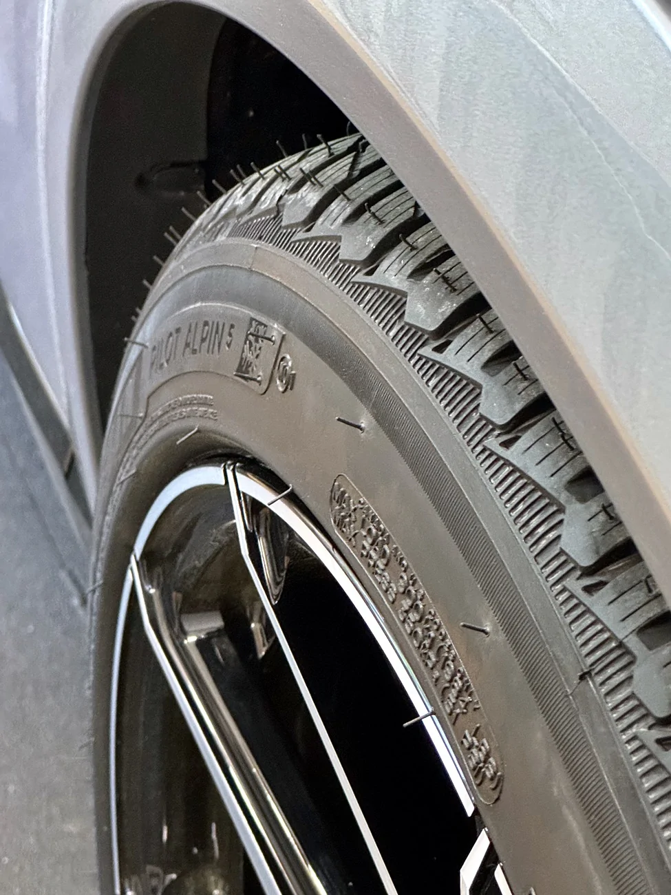

I have photos of many tires and wheels that I have tested. Below are two photos of 20x9 wheels. The top photo has 255's and the bottom, 265's. To me the 255's look a little stretched. It is not a huge amount but they are not as flat as the 265's. I could not find one at that angle with 275's which have a slight bulge to them. However, these are Michelin Pilot Alpin 5 winter tires which are slightly narrower than a Pilot Sport 4S summer 255/45R20's so that can affect the way the sidewall looks.

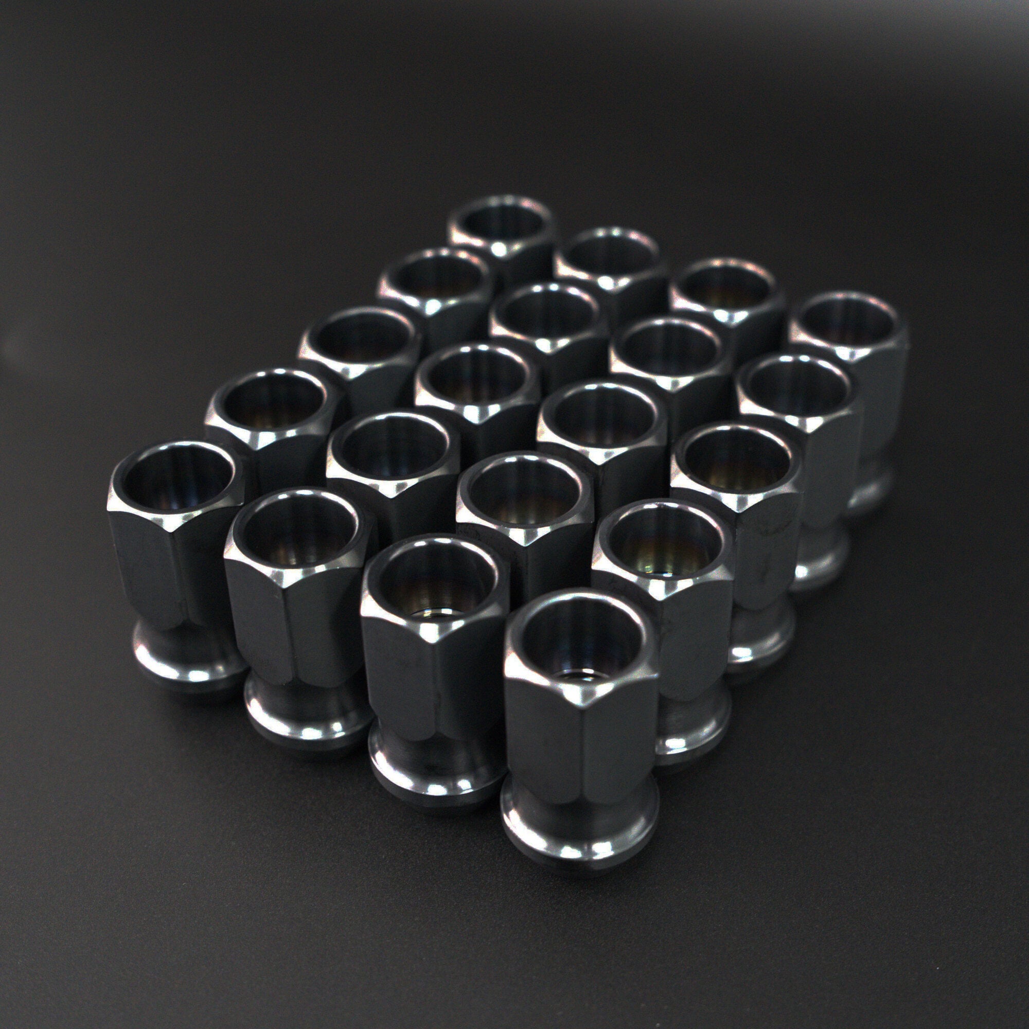

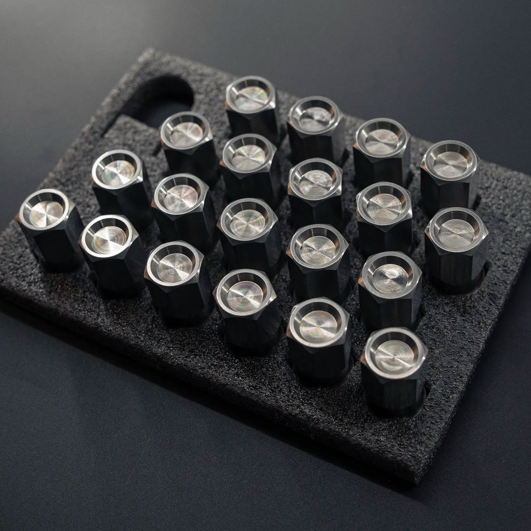

What better way to complement your Atomic Wheels than with our titanium lug nuts? Less weight, better quality, and even better style!
