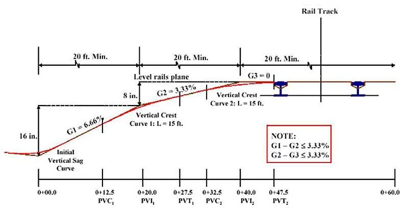

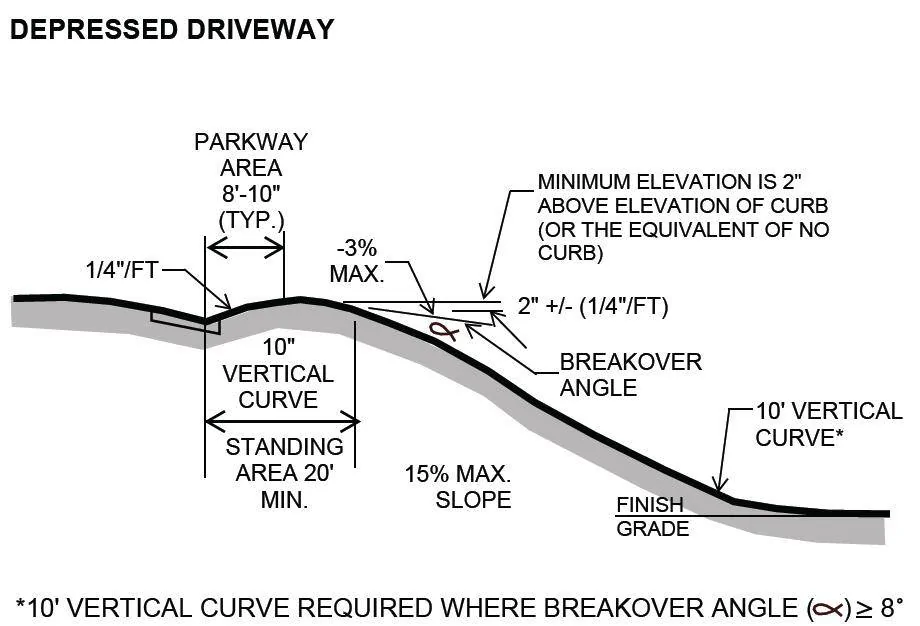

This is a driveway engineering issue. Your driveway needs to be reprofiled or you should buy a different vehicle with more ground clearance.
Here is a federally suggested profile with slopes that is used to prevent hangups going over railroad tracks. It's important the transitions aren't too sharp.

Here is a suggested driveway profile. Just like the railroad curve the maximum slope coming off the peak is about 3%, before transitioning to a steeper slope with a maximum of 15% grade. No sharp turns or angles.

I appreciate this info. At some point yes, I’d like to get the driveway redone. That isn’t an option right now though, and I know getting all the permits from the city will be a pain. Coming in and out at an angle works fine—just wish I didn’t have to.
