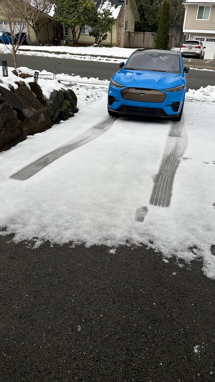

Speaking of steep driveways. I went to my friend’s house, parked at the top of the driveway. Came out to this. ?
Moved it so that the front tires were on the dry part, same results.
She is just telling you, "I don't like your friend and it's time to go" ? ? ?
Not uncommon. Heavy vehicle, icy driveway. Many years ago, we awoke at a townhouse we were renting and found our car in the street. I suspected a theft attempt, when running out the door, and promptly fell on my ass. Everything was glaze ice, and the ice had built up under the tires and cause the vehicle to slide into the street.
Always set your parking brake. Always turn the wheel so you ideally are up against a curb. And, if you have any concerns, park on a flat road / driveway.
