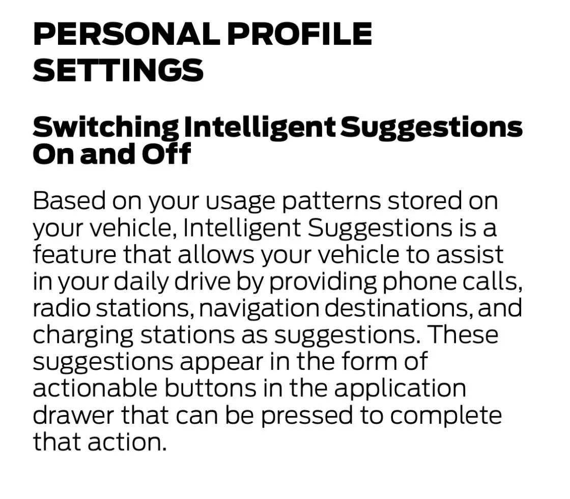

I do not have Intelligent Suggestions turned on. My car never suggests that I listen to the radio, it decides for me.Do you have Intelligent Suggestions enabled?

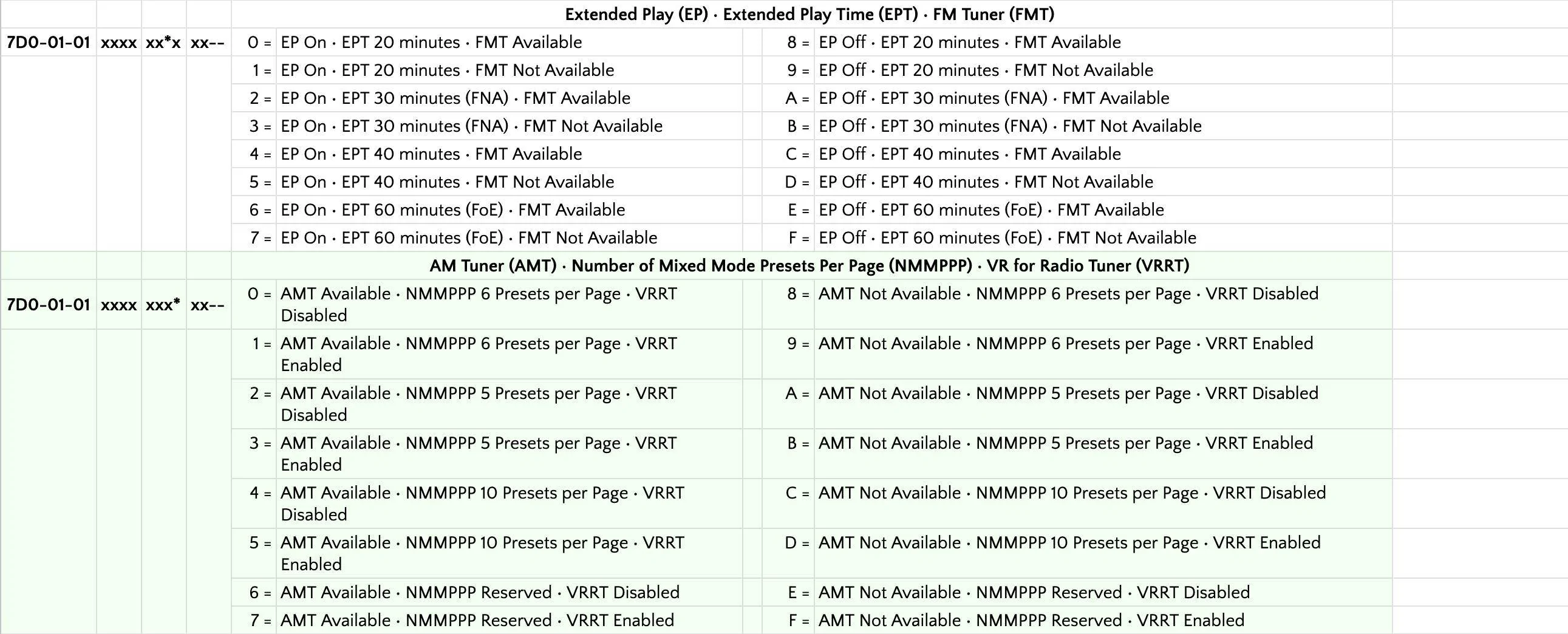

I have to dig around a little more with Forscan this evening. I was able to disable AM in the APIM, but FM still showed up for whatever reason. I know that Sirus can be disabled for sure. I want to try disabling any references to HD radio as well.Thanks for that! That is more like what I expected to find.
So it seems that the ACM can't be bypassed, since even in my Premium with the B&O, the signal level audio from the APIM is still passing through the the ACM.
But perhaps, as has been suggested above, I can disable the AM, FM, and XM tuners in the ACM via Forscan or FDRS.
