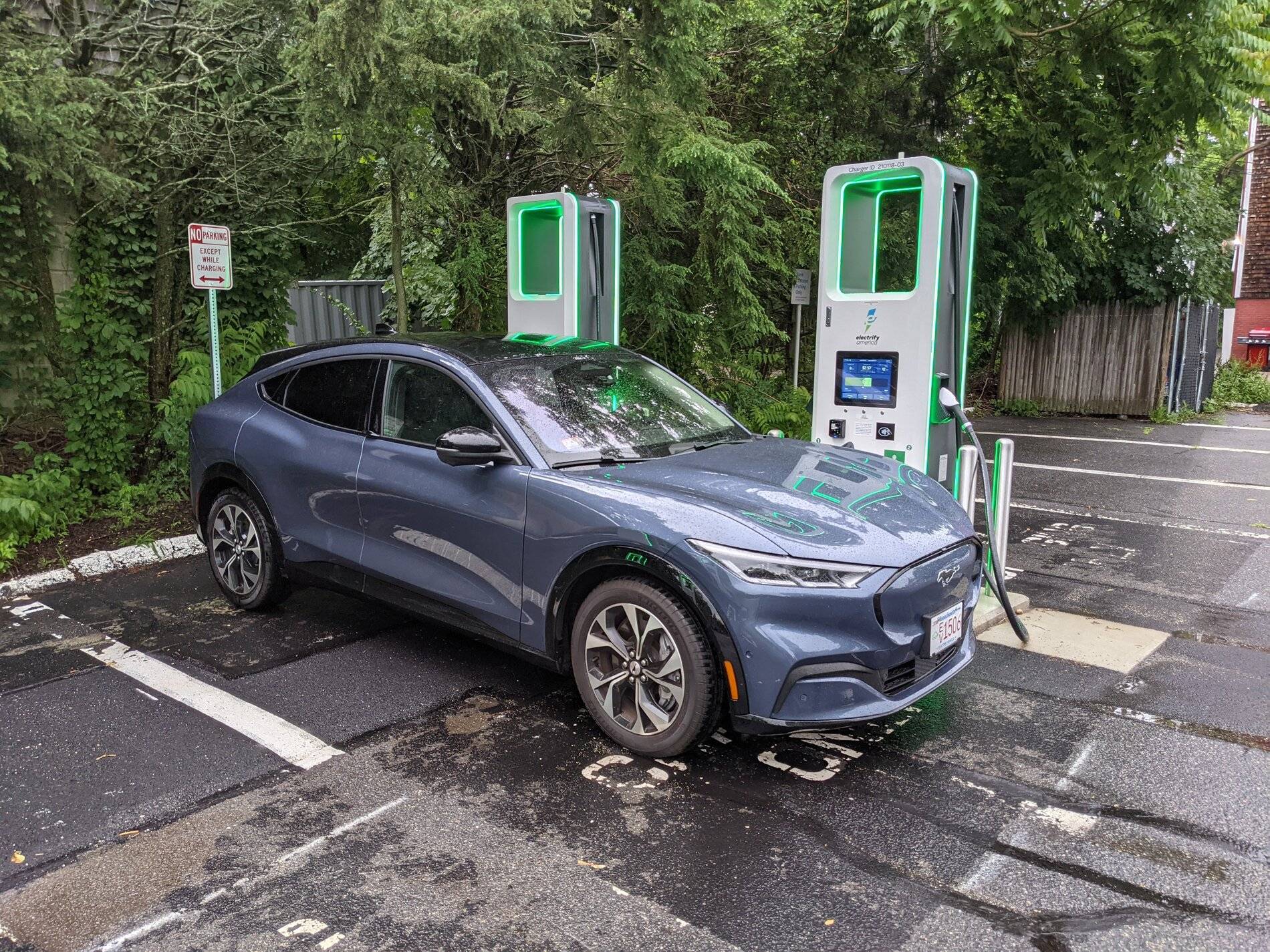

HA! I've had the same issue even at normal Electrify America chargers. I find the cables to be way too short for a car that has the charging port so far up the fender. I think Tesla (and others) have it right with having the charging port in the back or in some cases up front.
I almost always have to go into the little "no parking" area a little bit to get the cable to reach. I've also used a few on the ends where there was space that I could kind of park at a little angle to make the cable attach easier.

I had the same problem at an Electrify America station in Truckee last month. The only way I could get the cord to plug in was to park way over the white line and almost into the parking lot driveway! At least it was an end station. (The other stations were being used or down at the time)

Ford put the charging port on the front driver's fender because they thought it would be the most convenient spot for home charging in a garage (easy to unplug before getting in), but obviously it causes problems with poorly placed DC chargers.
EA chargers are usually arranged in various ways, so a different spot might reach better. Sometimes you have to back in.
If we eventually charge on Tesla Superchargers, that will be a nightmare too. Cord probably won't reach the front backing in, so you'd be forced to pull in forwards and take the spot to the right of the supercharger. Tesla drivers won't be happy since you're effectively taking up two spots then.
