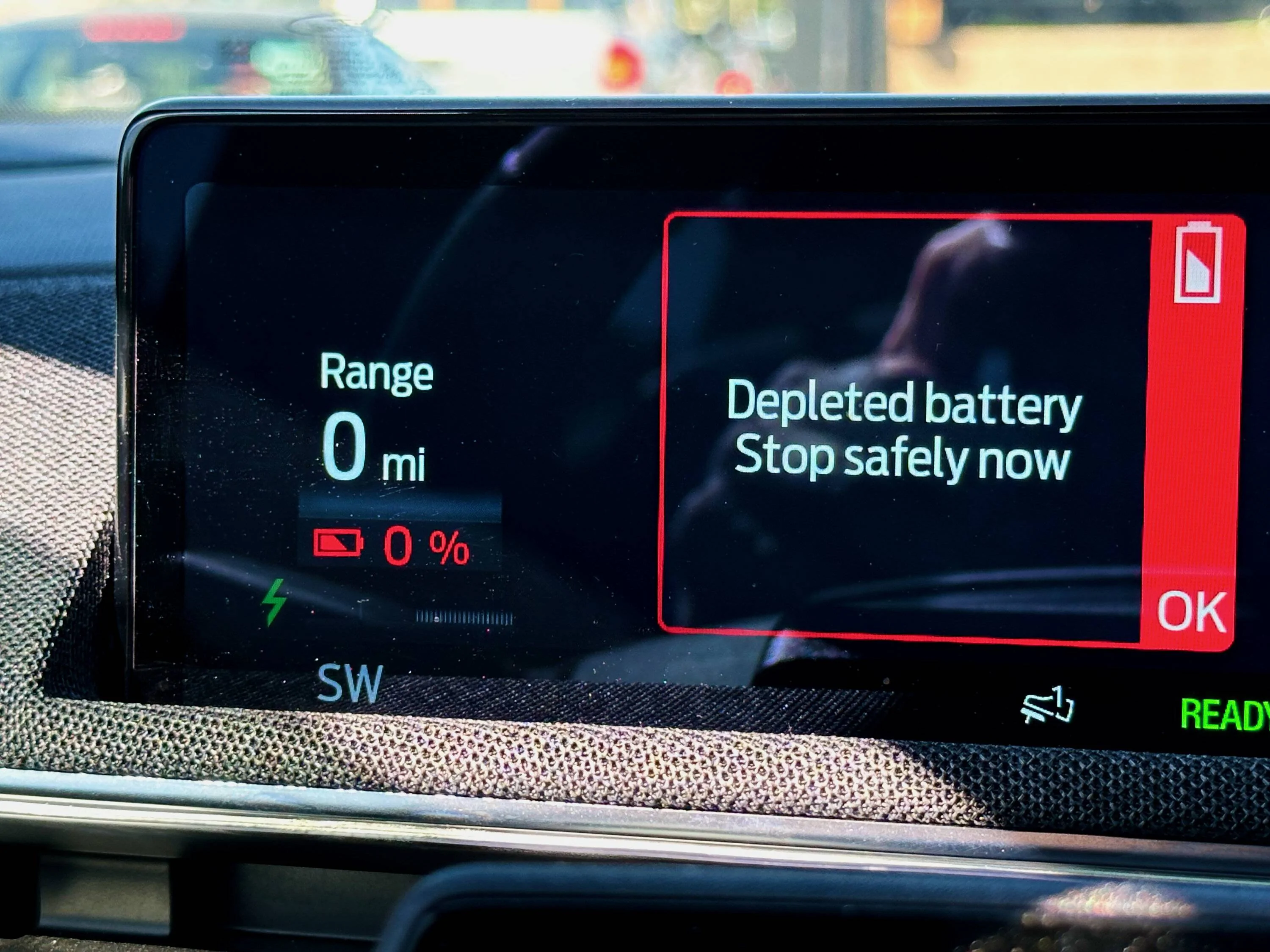

In the extended range MME, there is 99 kWh of total battery capacity (assuming 100% SoH), and 91 kWh usable. That means there is an extra 8 kWh beyond the usable limits. There is around a 4 kWh buffer on the top end, and about 4 kWh on the bottom end. So you have about 4 kWh below 100% to run it dry. At 3 miles per kWh, that is 12 miles of range. At 2 miles per kWh, that is 8 miles of range.
Mark made it five miles below 0%, and I suspect the car would have shut down soon after if he had not made it home. I doubt the car will let you use up all of the 4 kWh buffer, because, well then it isn't a buffer.
The car will shut down, and unless someone is able to charge your battery on the side of the road, you will need a tow. Some BEVs are hard to charge when they get that low. Mark didn't have a problem with L2 charging, but a DCFC might fail. I have heard rumors there is a minimum charge level for starting a DCFC. I think @Mach-Lee knows the answer to that.
