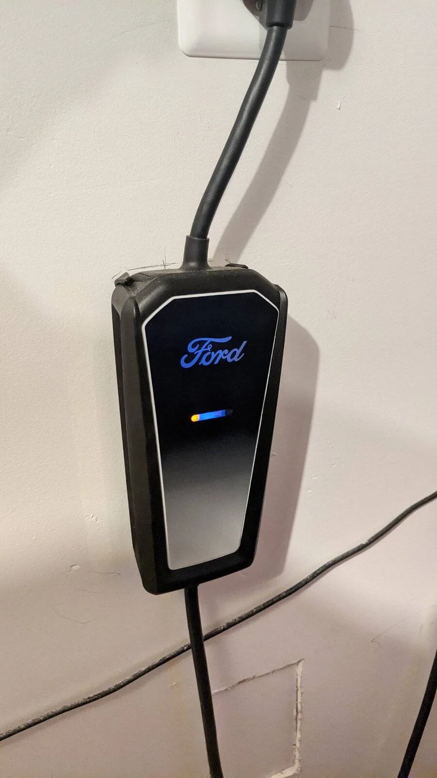

I have been using the FMC for about a year without a problem when I noticed the Amber light in June. Now it flips back and forth between 3 kW and 7 kW while charging slowing things down.
Thanks,
It is definitely heat related, and likely it is worse after it overheats a few times. I only use it for 120V charging now but even then I had it overheat once. If you are in a cool climate or can keep the EVSE cool, it will probably be fine. Otherwise buying a new EVSE is the best way to go IMO. I bought a Grizl-e for 240V travel use.
