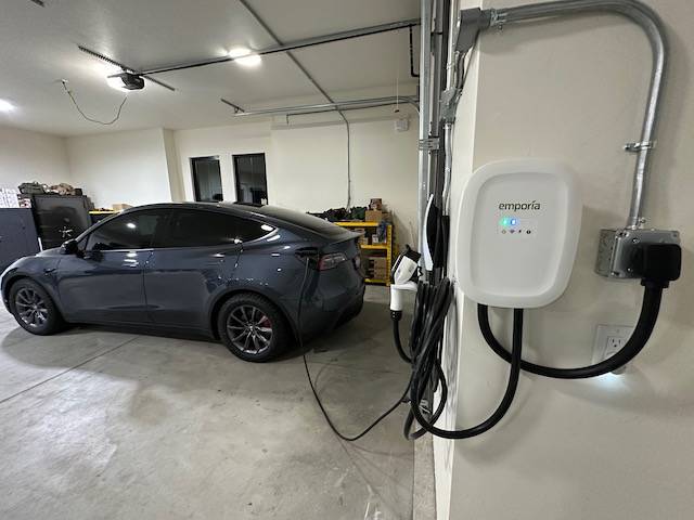

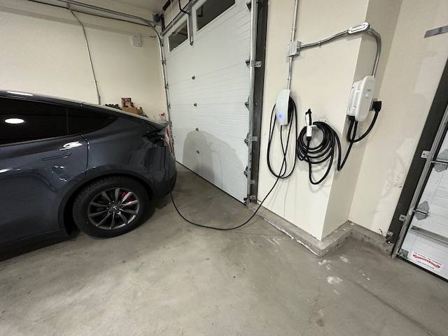

For my wife's Mach-E, that just left KC on a train, I went the route of the Emporia charger. I know I could have used the pretty pricey adapter on my Tesla Charger but I figured for a little bit more money we could each have a dedicated charger and charge at the same time.
My Tesla at 48A and my wife at 40A with the Emporia. If we come to find out she really needs the extra 8A we have the option to hard wire the Emporia and get the full 48A.
Just wanted to throw this option out there as a replacement.
