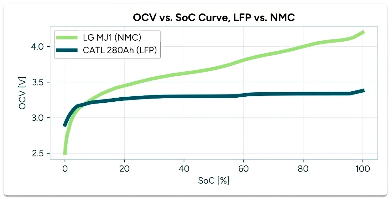

You are correct that you will not be able to do the full calibration procedure. Based on your situation, I would recommend you try to find a public Level 2 charging station in your town and do a monthly charge to 100% on it (perhaps after you hit 80-90% on the DC charger).
The periodic charge to 100% is important for LFP batteries to reset the coulomb counter of the battery's capacity to full. The periodic charge to 100% will prevent the sudden early drop to 1%.
If you cannot do regular charges to 100%, then I would avoid going below about 40% due to fear of running out of charge unexpectedly due to an uncalibrated BMS.
This is one of the pitfalls of owning an EV with no at-home charging. Given that situation, I would recommend getting the extended range NCM pack instead of LFP.
