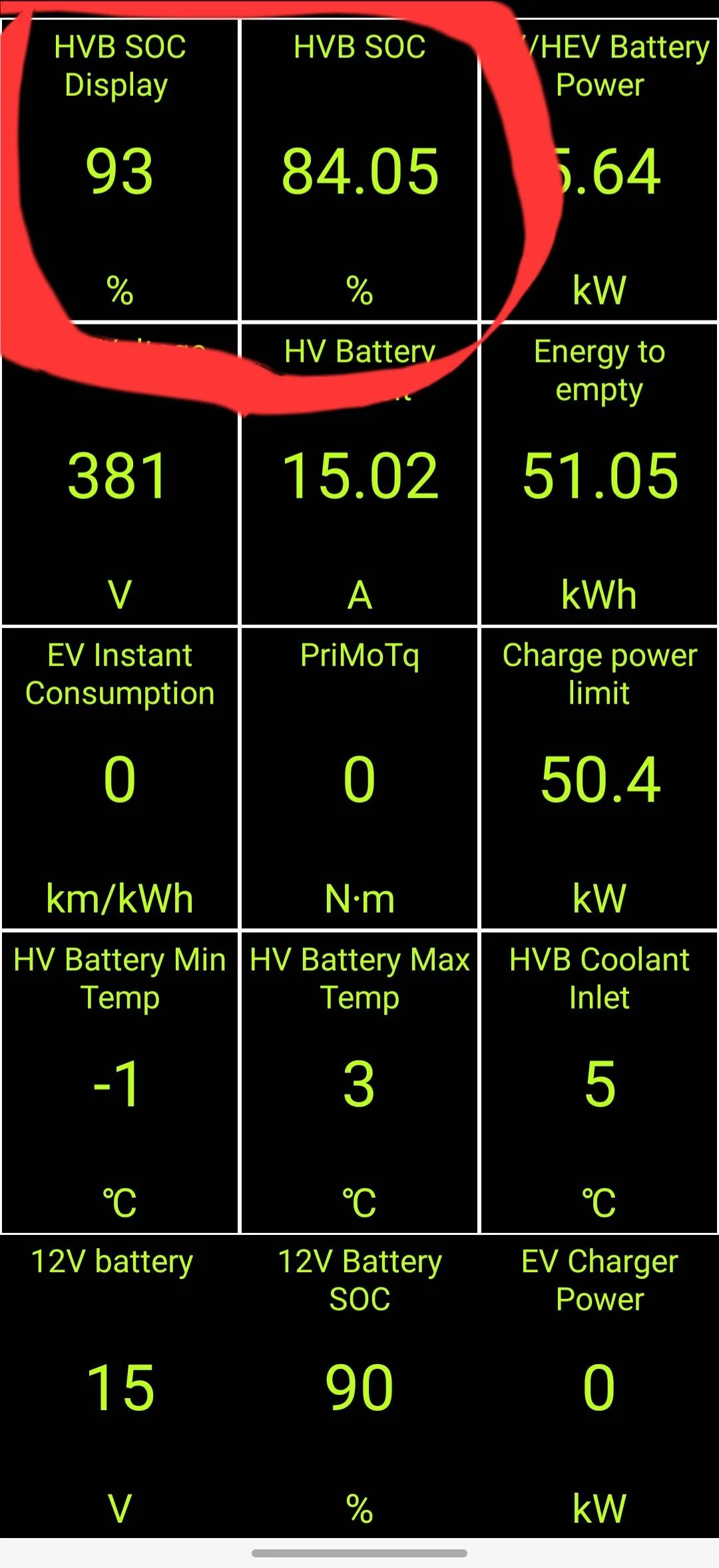

Hi,
I use car scanner and I have noticed that the displayed HVB Soc in the car(small screen) show much higher value than the actual, real HVB Soc % ? It often differs between 8-10%? Normal ??
I have done a GOM reset?
Std battery
Ford Mustang Mach-E HVB Soc display Screenshot_20221215_172227

The battery pack is larger than the available to use for driving. There's a buffer on the low and high end. Not sure which model you have (standard or extended range) but ERs have a 99kWh battery with 91kWh usable.
So display SOC of 100% is actually 91.9% HVB SOC for ERs

Yes that's normal, the difference is the top buffer on the pack to prevent degradation.

Thanks,
I have the standard range battery with 68kWh. Isn't it a little remarkable if the HBV Soc show 84%, then the energy to empty should show 56Kwh not 51Kwh right?

That's normal because the battery is cold. When the battery is cold its capacity is less due to physics. 68 kWh is only valid if the battery is at 25-30ºC.
