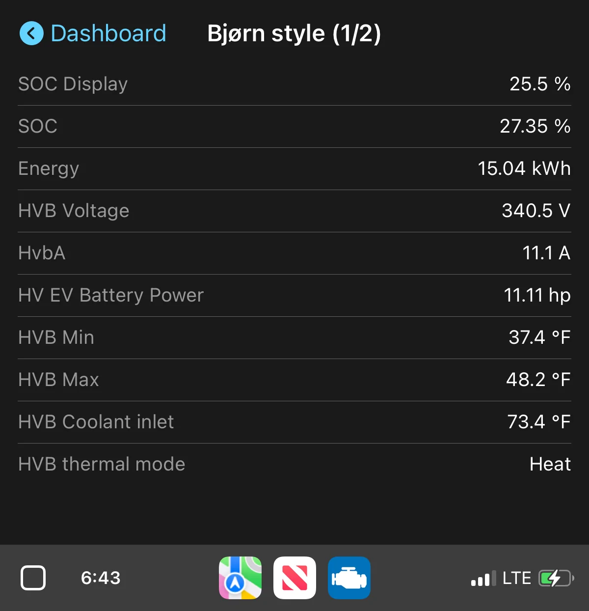

That’s not what’s been observed with most of the Mach-E heater failures so far. Some of the elements start to intermittently fail open and the total output will be reduced at random times as I described before. Owners report little to no heat at times.I am told that PTC heaters don’t fail in an intermittent way, they usually lose isolation and stop the vehicle, apparently.
